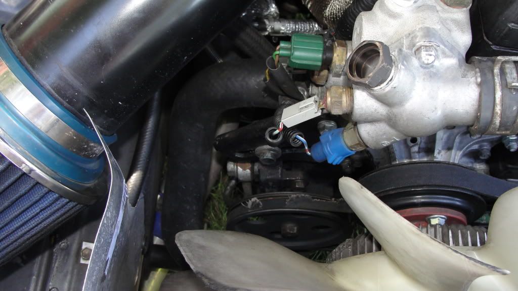

4- shredded PS belt

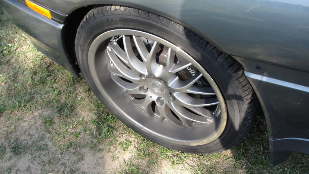

Wheel were shiney and clean to start with...

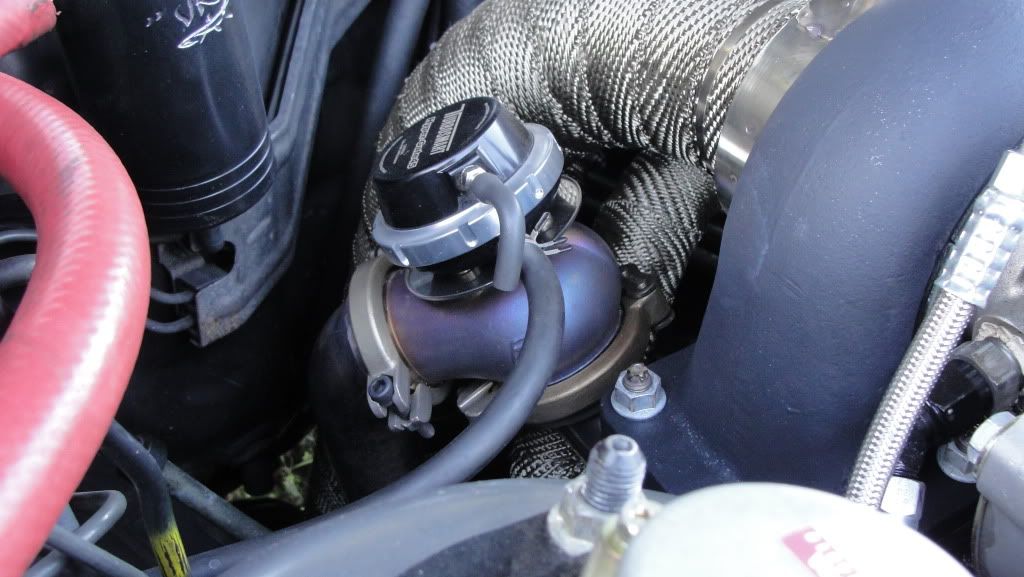

Blued the Wastegate
Belt om-nommage

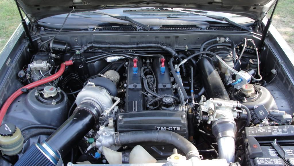

EDIT: added engine bay shot:

That blue color on the wastegate looks sick.

Yep, got a new 89 harness with the AEM when I bought it from Nashman. It was a very pricey combo, but I don't regret buying it or modifying it at all!

I'm thinking those rotors are not the "likely" culprit for some "shimmy" up front... but I'm curious. I have a LITTLE shimmy but I'm pretty sure I didn't have my shop adequately clean under the hats first, so any minor contaminant or non-flush seating MIGHT have left a little run-out variance on mine. It's livable and I'll be doing a freshen up next time I pull them apart for some service. I've read enough on whether these warp or not to be a bit skeptical, especially considering how robust they are next to other BBK rotors I've seen.
Let us know if you DO find some issue with warping and what kind of driving, etc... caused it. (I'm also suspecting some of my front steering mechanicals might need replaced to "snug" everything up.

As for the brakes, I pounded the lug studs out to completely clean the hub face to prevent that exact situation, Chris! I'll be checking all the brakes out, likely replacing the rear rotors and a complete front end teardown with runout check on everything- I wouldn't be surprised if I needed two new front wheel bearings and hubs!

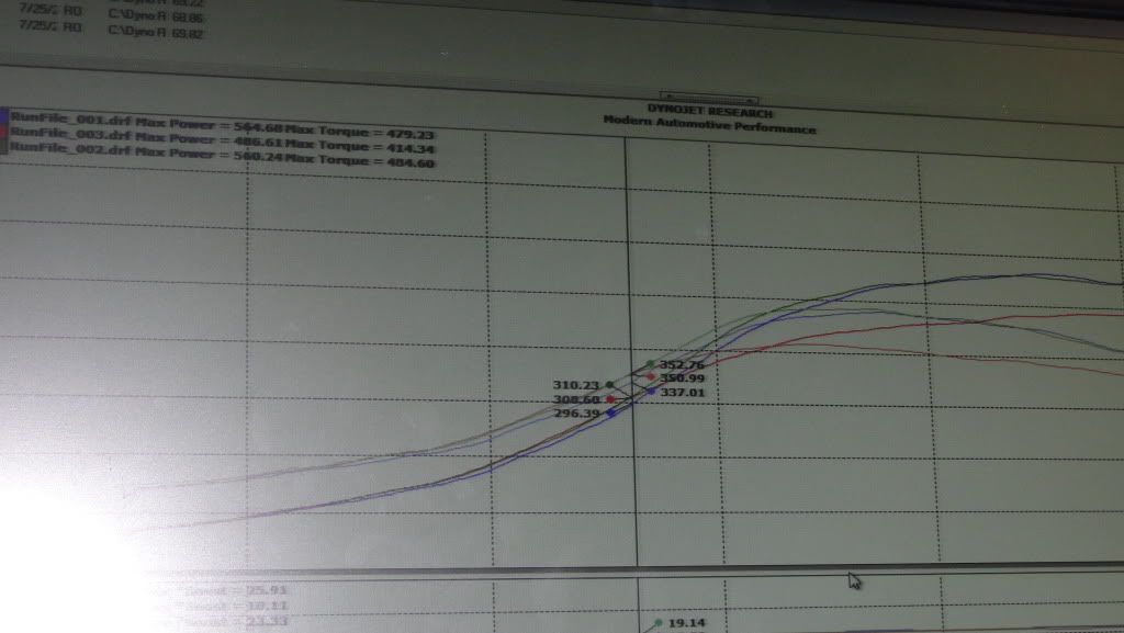

Dyno video!
[video=youtube;i45KxDrfnow]http://www.youtube.com/watch?v=i45KxDrfnow[/video]
toyotanos
What will we break today?
Nov 29, 2008
2,842
Coon Rapids, MN
Dyno operator was saying he thought the clutch may have been slipping- I can't confirm so I'll just upgrade it once I land a new transmission :bigthumb:
