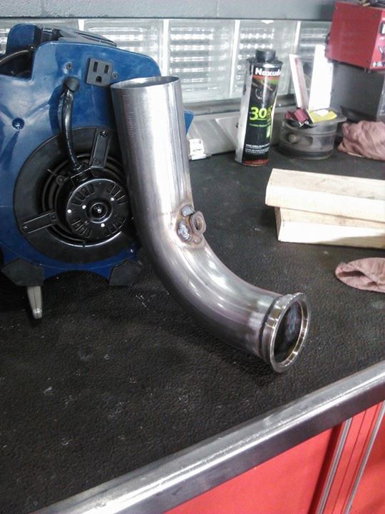

Little bit of an update in the cars status- broke another R154! (sigh) Drag racing and I managed to tear 3/6 lower shifter housing bushings, broke the MC lower ball seat on the shifter itself, and managed to make 2nd, 3rd, and 4th gear hate life in the process. Unfortunately, I wasn't able to run a 10, only managed a 11.2. The 3.73 rear gears helped in the launch, but the more aggressive gearing of the 3.91 made it accelerate much better, pending I had traction to launch with.
The V160 plan is still my goal, but I might have to give that up in lieu of drag racing being what this car does best at the moment. That said, a TH400 or 4L80e might not be so bad, as long as I can get it strong enough and dialed in right. Running a 9 sounds really nice, when I don't think about the massive work it would be to fit.
All aside, I'll leave you with a couple pictures of the work currently being done to the car- replacing a very blown gasket, and fabricating the shortest exhaust possible (raincap not pictured, but it will be on there, heh)

The car is being launched at 5000rpm on the 2-step. Car runs only 2-step launch control, no anti-lag. Anti-lag (retard rev setting) makes the EGT's soar well above safe levels for the turbo, and you'll damage the turbo exhaust wheel doing it. I know because the first 2 years I raced it I was using anti-lag, so the turbo exhaust wheel was a bit melty last time it was apart. 2-step is safer for the setup, and I'd like more reliability out of the car than absolute performance.

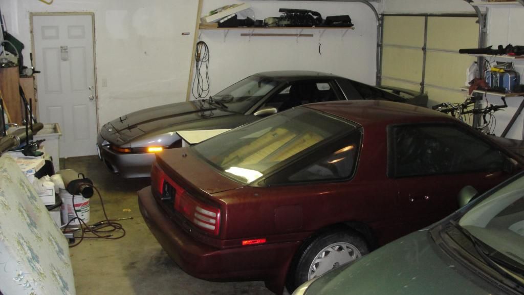

Slight direction change- I found and purchased a 1991 Hardtop shell!
I don't have any space to work on it atm, but as soon as I finish the current WRX side job we're going to start some serious teardown and inspection!
Only picture atm:

At the moment it's a chassis swap. The new Maroon one is an NA, non-abs, Hardtop that'll be pretty stripped out and caged. Not sure how heavy the 4L80E will be, but I think it'll be below 3300 with me in it.
