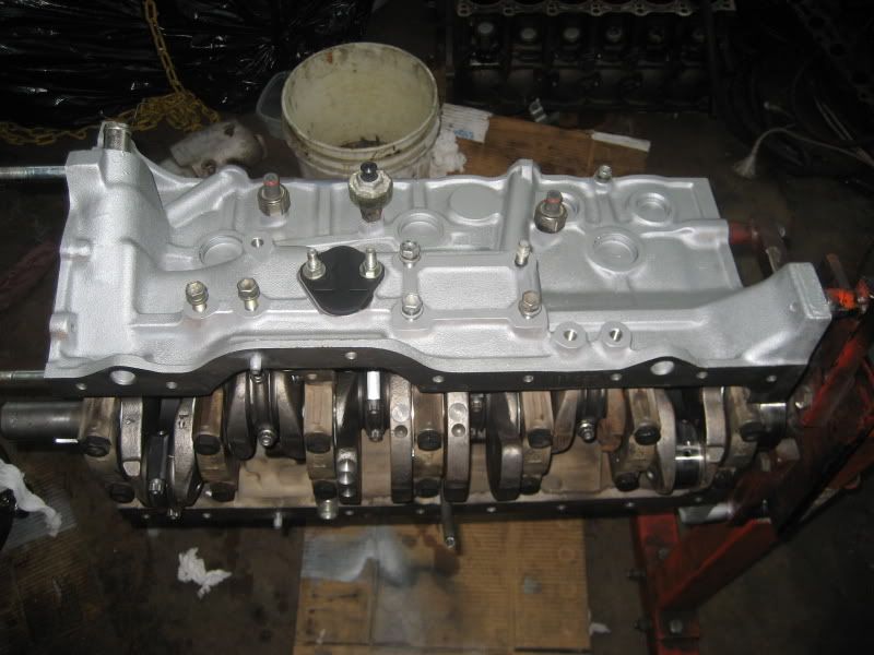

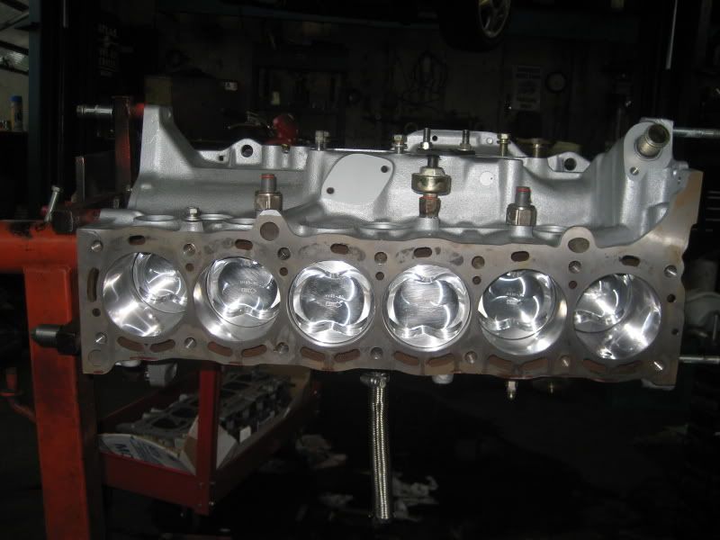

Caught a sweet break today, guy didn't go on vacation yet at the machine shop and finished up my rods! Block will go back together tomorrow.

Here is the current status, waiting on 1 rod bearing because I had one defective one which had a chip in it :icon_mad:
Tomorrow I will sandblast and paint some engine bracketry, should get the bearing Tuesday.

IJ.;1088128 said:
That head looks VERY rough for 30ra......
Painting inside a block is a bit of an old school thing believed to aid the Oil drainback... (I don't buy it)
yeah, its a special type of paint called "glyptol" as i recall. spelling might be off. i know lots of old school guys that did it and never had probs. its to help speed the oil drainback to the pan. supposedly a sliperier surface then the block. kinda beats trying to polish the inside of the block like the group a motors were done.
Maybe for my next build...hopefully no time soon! :)

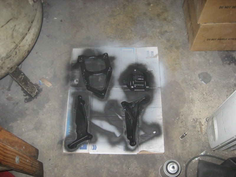

Update for today, sandblasting, 2 coats of primer, and 2 out 4 of the brackets have 2 coats of black on them. My engine bay is turning into a satin black, silver, and polished piece. Also got in my last rod bearing and oil pump torqued in to specs. Tomorrow more painting brackets, more assembly of the front cover.

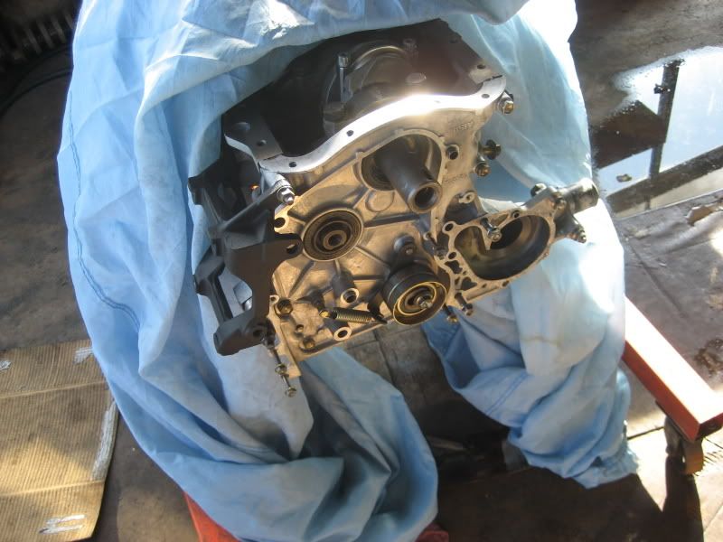

Today: I got the lower timing cover on, waiting on a few gaskets and tomorrow I should have it all together down there.

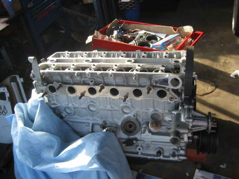

Pictureless update: Water pump, crank gear, and oil pump gear are on. Working on cleaning up the head right now while waiting for my head gasket. My dad's gonna teach me how to shim cams and how to put a head together tomorrow so I should have updates tomorrow and hopefully learn a lot as well!

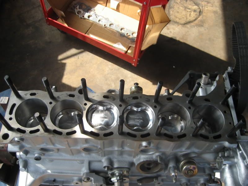

It's coming together! HKS 2.0mm bead-type MHG came in today and I put the head on today torqued down on my ARP studs to 80 ft. lbs. with the moly lube. Also threw the transmission belhousing gull wings on. Tomorrow, manifolds go on and **hopefully** drop the engine in the car!

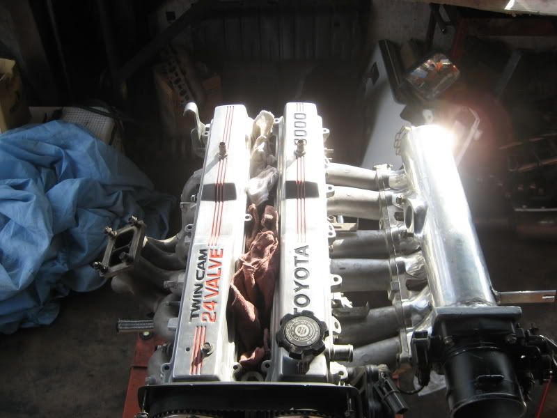

Intake manifold check, cams check, exhaust manifold check, heater hardline check. Waiting on the oil filter housing gasket and mainly just cleaning parts before installation, engine will be ready to put in if not in by tomorrow night!
