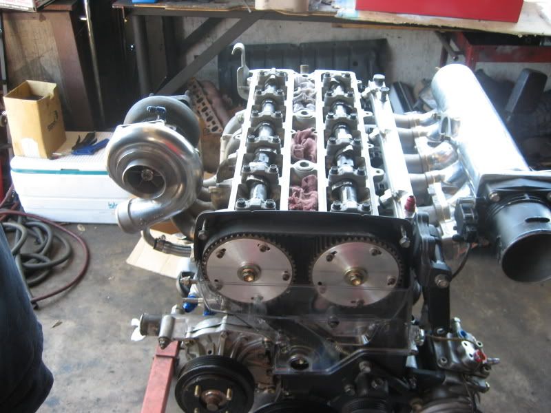

Engine is pretty much as far as I can get it without parts. I need to go to the local autostore Monday to get my new feed line and also no welders till Monday for my new ICP and lower rad pipe. Will set the engine in tomorrow.
TRD cams confirmed:

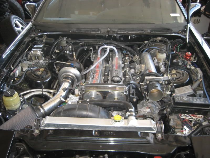

Ok, been getting held up by missing bolts and parts but its coming together. Just need to get some icp, rad pipe, and intake pipe welded; fans, pulleys, alternator, catch can mount, cam cover lower breather, and IS300 coilpack mounts and I'm ready for startup.
I cannot wait to get this car on the road!

Doward;1127778 said:
Specs on those TRD cams??? You better have degreed them!
I think they are 264's, I was told they are only available in 258 and 264. I don't know anything about cams, I know my dad shimmed them? Do they need to be degreed too? I'll have to ask him all he did to it.

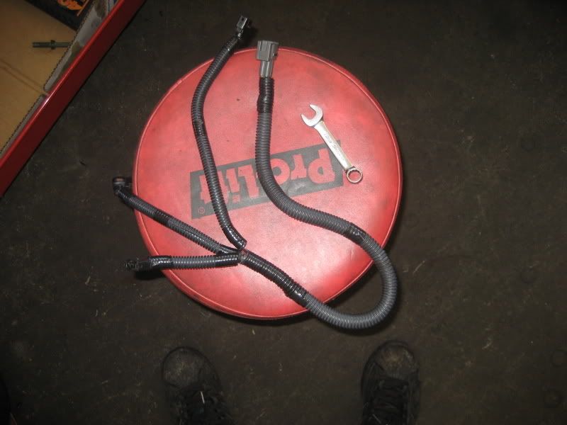

update:
My extended coil pack harness for the IS300 coils mod:
Welding up the lower rad pipe tomorrow, then lots of tuning and making adjustments.

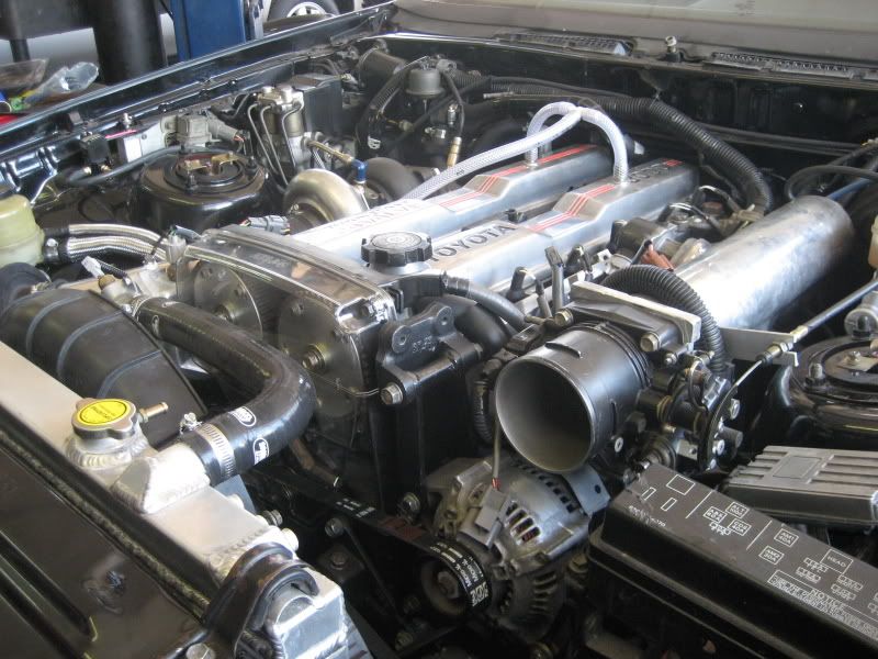

Looks fantasitic!
One tiny concern I saw in your pics. It looks like your oil return off the turbo goes dangerously close to less than 90* angle. You could be close to setting up a bad condition of oil not draining away well enough. Just something you might want to be aware of if not already.
I really love a 7M with a FFIM :love:

Facime;1129945 said:
Looks fantasitic!
Thanks!
Wouldn't less than a 90 degree angle flow better?
Oh did I mention it runs? :) Won't stay running though, its gonna need a lot of tuning.

By less than 90* I mean if you look the hose from the profile:
The better you can drain the oil away the better. Yours looked "iffy" to me.
