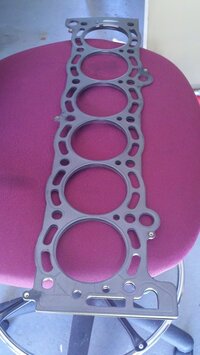

Received this today:
Titan 2.0mm MHG

You know what- you got me worried, so I went into the garage and measured it.
I'm not quite sure exactly where I'm supposed to measure it, as there are differences in height depending on whether you measure on the bead or not,
but it is greater than 2.4mm at it's thinnest. Also, the SIP gasket is supposed to be flourine coated, this one is not. SO, I've got the wrong head gasket.
I'm starting to lose faith in SIP racing(again). I've emailed Rich, and asked him to clear this up. I'm also going to talk to my machinist tomorrow, to
verify that I won't need anything thicker than 2mm before I send this back.
Edit- This one IS flourine coated, but I think it's a 3mm head gasket.
