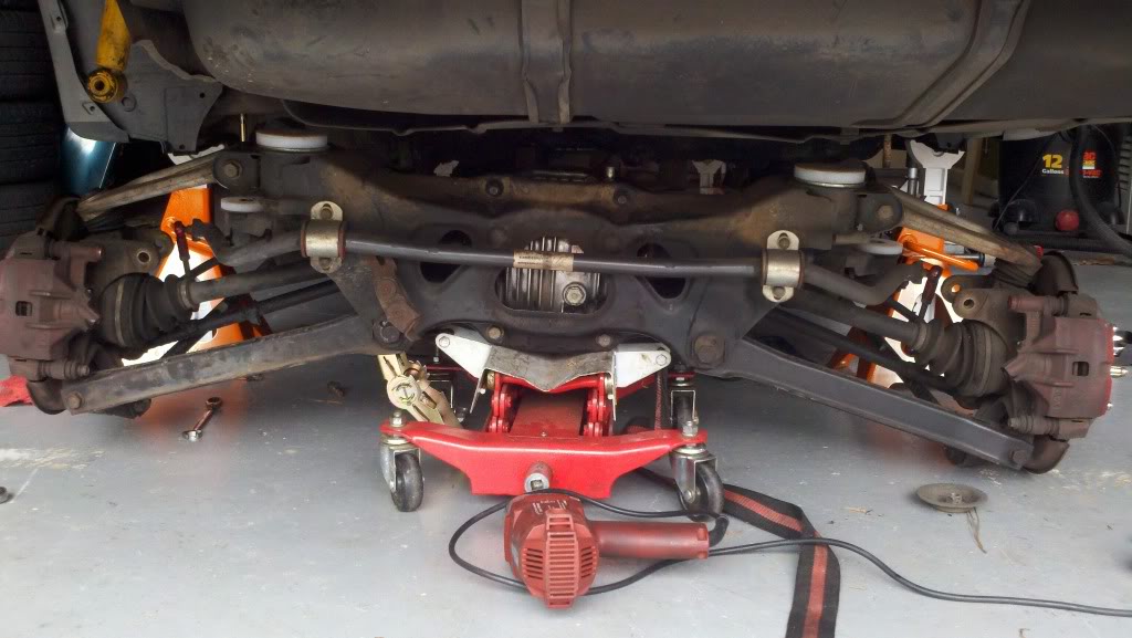

Unbolt all arms, swaybar and diff from the subframe:
[url=https://postimg.cc/mPmWDtcR] [/URL]
Stage 1 of stage one complete.
Here, you'll notice the previous crack that was welded on the right, and the new, improved crack on the left:
[url=https://postimages.org/] [/URL]
Top view of the crack:
You'll notice in a couple of the pics, you can see that i had already installed some of the ES bushings. now I just have to finish them up.

So, here's the welded and braced subframe.
I used 1/4" plate steel on the inside face of the forward wall, and then welded in 1" seamless tubing.
I've seen alot of guys go nuts with corner angle braces, and plate the entire forward hump, but I felt that this would be enough reinforcement for my purposes.

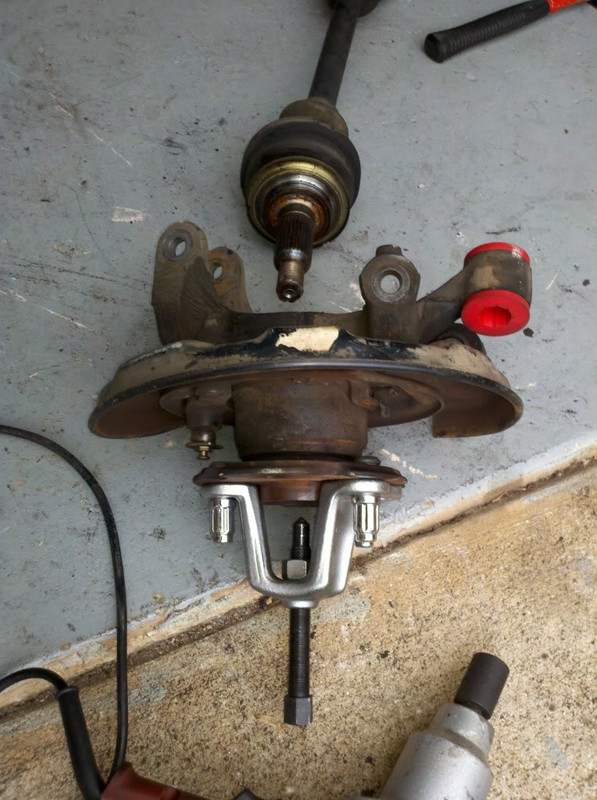

Still trying to figure out how to get the rear axles out of the hubs. After 25 years, it seems that they are welded in place!
I've tried a two jaw puller on the rear disc, with said disc bolted down with the wheel nuts.
And I've tried bashing it out with a 3lb hammer. Problem is, I don't want to ruin the thread area, so that I can return these as cores.
So if anyone has any suggestions, I'm open to them.

Yes, I did remove the locknut, and I did spray both front and rear with PB blaster and left it overnight, with ~500lbs outward tension on the shaft.
No luck so far.

With some helpful advice from Toyotanos, I finally managed to break loose both of my rear CV axles loose.
Ordered some new ones, as well as new wheel studs for the rear.

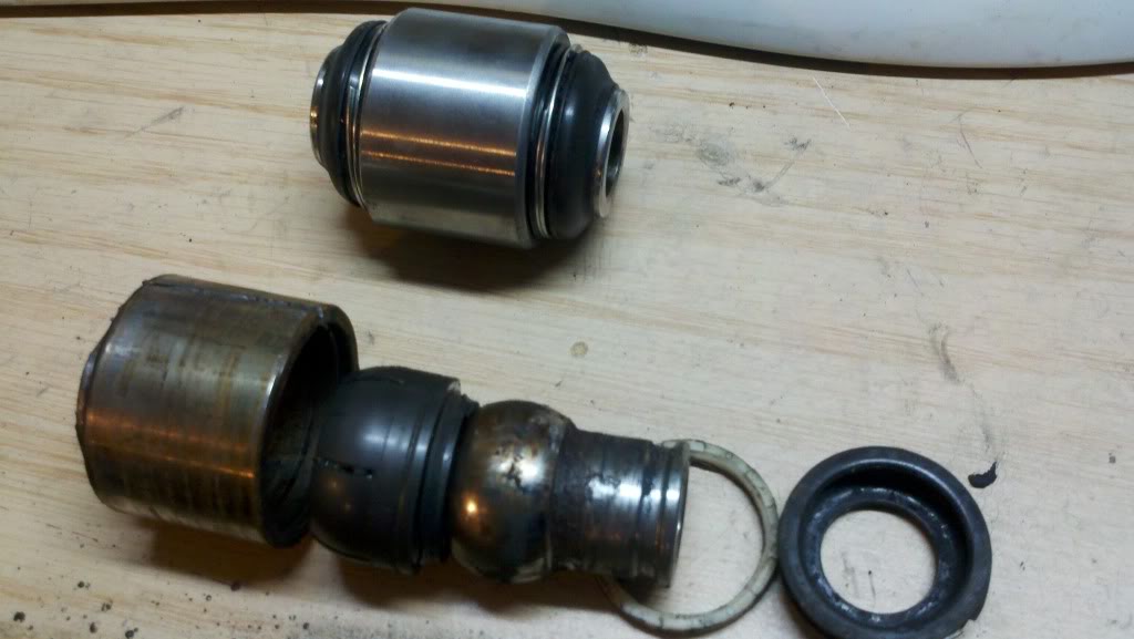

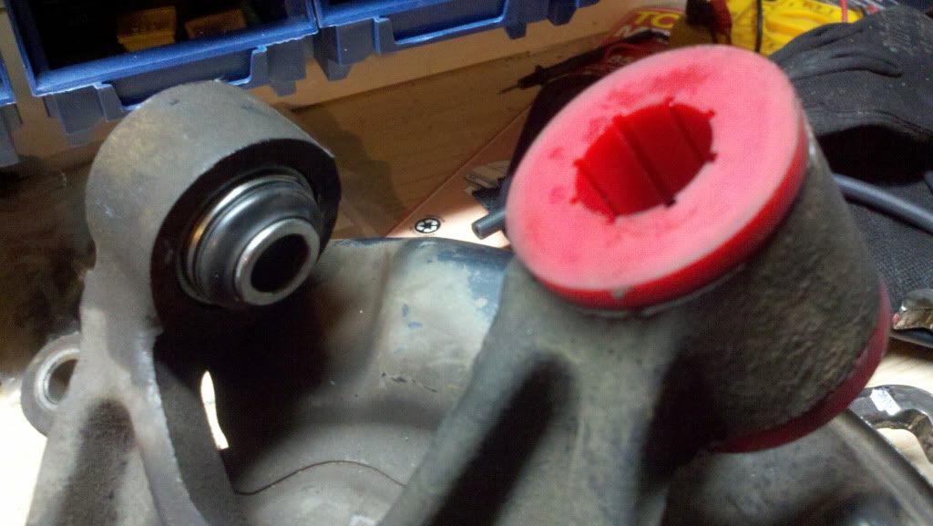

Also, I managed to pop out one of the rear spherical bushings from the hub. In case you're curious- this is what they look like inside:
Old and new:
New one installed:
Tomorrow, I will clean both rear hubs, degrease both rear brake cables, and install the last few Energy suspension bushings,
and the other side's new spherical bushing. Both the new axles and the Megan coilovers should arrive Monday. then it's reassembly time.

Pulled out the last two hub bushings(the lower rubber and lower spherical) from the passenger hub, and cleaned up the hubs/ painted them.
Under all that dirt it was practically bare metal, so I just threw little black paint on them too keep em from rusting.
If you notice in this pic, you'll see that both hubs had paint numbers on them, indicating to me that both rear hubs were replaced at one point.

I started assembling the rear subframe today, by installing the arms, diff, and hubs.
Problem is- I soon relized that the halfshafts were going to hit the new upper subframe braces!
SO, I had to cut them back out. Now I'll have to weld in some new ones, slightly outboard from the original positions.
