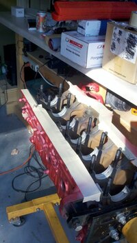

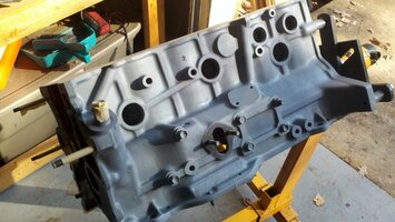

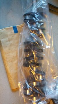

Finally picked up my block/ crank from the machine shop:
Block- decked, linebored, honed:
Crank, polished, and balanced with the rotating assembly.

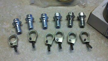

New squirter bolts:
Also done, was a check/ resize of the rods, and the machinist ordered/ supplied the ARP mains, and all bearings as well.
Next, I will install new oil pump shaft bearings, and paint the block prior to assembly.

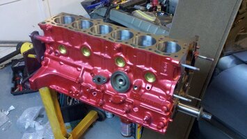

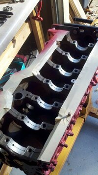

I still have to put one more coat and then clearcoat, but here's just a quick glimpse of it:
Primered:
Painted
ARP's test fitted
Still have to install the oil driveshaft bearings tomorrow, before I can do any real construction. But now I have *almost* everything I need to turn it into a longblock.

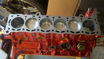

Anyway, I got a little bit done after I finished painting and clear-coating the block.

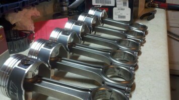

Installed the freeze plugs, installed the oil driveshaft bearings(PITA), plasti-gauged the mains and installed the crank, and then assembled the pistons onto the rods.
Tomorrow, I will finish checking the ring gaps, install said rings, and install the pistons/ rods into the block.
Getting there. Only about $2,500 more to spend on the engine/tranny. Then on to the interior.

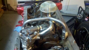

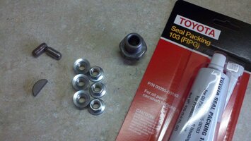

Today's progress:
Next up is to install the oil pump driveshaft, oil pump, oil pan & front timing cover.

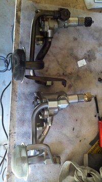

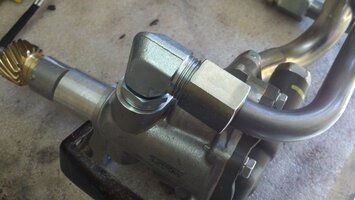

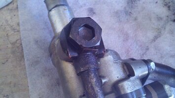

Well, if you use head bolts, you don't engage the threads as far down as they go.
Dunno if the studs thread down further, but using a bottom tap hits those dark scary places.
Oil driveshaft, oil pump and Arizona performance supply pipe, done.

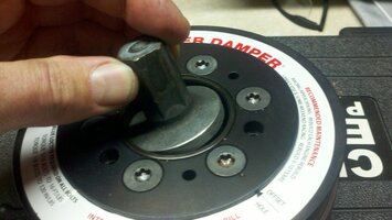

I also had my machine shop mill down the crankshaft pulley bolt to 45mm for the ATI superdamper:
