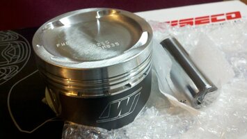

They have arrived.
Time to go to the machine shop.

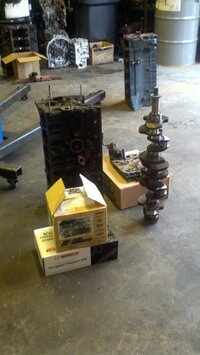

Block, crank, piston, rods and front timing cover have been brought to the machine shop.
They will be ordering the main studs for me. Hopefully, I'll have some nice engine pics for you all in a couple of weeks.

I chose Wiseco because A: they were ~$200 cheaper than CP & lighter than Ross, and B: the skirts are coated and the pin bore is offset to reduce piston slap. That part may be true of other pistons out there, but i havdn't heard of any.
My power goal is ~400RWHP to start. I am overbuilding this motor so that I can't outgrow it's potential. I may look for as high as 550RWHP with the proper fuel and boost, but I would be happy with the lower number. I probably would have gotten Eagle rods as well, but I luckily ran across someone selling some Cunningham rods in the for sale section. These rods look more like carillo's to me(A beam vs. H beam).
