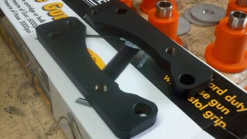

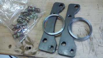

Well, just as hoped, Mr. UPS dropped off another box this morning:
Cobra conversion brackets:

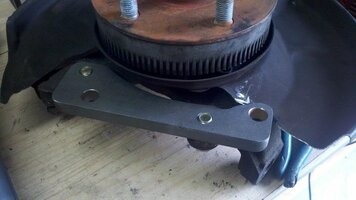

So I got started on the modification of the front hubs. By 'modify', I mean that I cut about 1.5 inches from the top of each dust shield.
Here you can see that cut, plus the bracket being test-fitted:

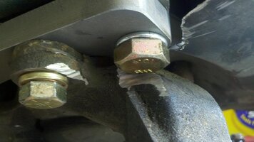

Here's where you have to slightly clearance the upper A-arm mount. It was just a matter of 30 seconds' work with an angle grinder:
And now it fits.

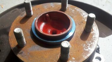

While this was happening, I heated up one of the hubcentric rings that came with the kit. Notice how it 'blued' in the oven.
Its a tight fit at room temp, but I didn't want to bang it on. After heating, it slipped on, easy-peasy. 400 degrees for 30 minutes then add you favorite seasonings:
Test fit of the rotors confirms that the new cnc-cut rings that Aaron provides are trouble-free, compared to the horror stories i've heard concerning the aluminum ones:

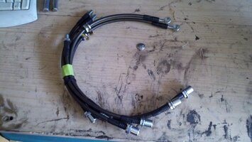

In case anyone is still reading this with even passingly-mild ambivalence, Here's the new brake lines from Driftmotion.
The fronts are slightly longer than stock, so that the oem brake line mounting/ guiding points can be used:

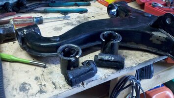

PS- The bushings in the lower front control arms, are a huge PITA. Had to sawzall them out.

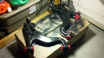

Well, after cutting out the lower control arm bushings, I proceeded to degrease, sand down, and paint the arms.
Then I greased up the new E.S. bushings and installed them, along with the new lower ball joints.

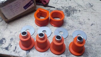

We left off with me waiting on two things: subframe and steering rack bushings. They've arrived.
Ladies and gentlemen, all the way from New Zealand- a big hand for Team Orange!
This means that i can finally pull the front subframe and swap out the steering rack, detail the subframe, and replace all bushings.

So, Thanks to my buddy John, my caliper conversion brackets are finally powdercoated a nice durable flat black:

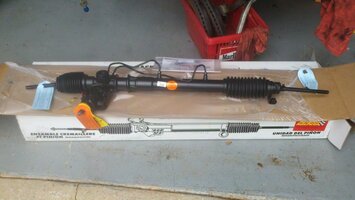

Also, I received my new steering rack today:
