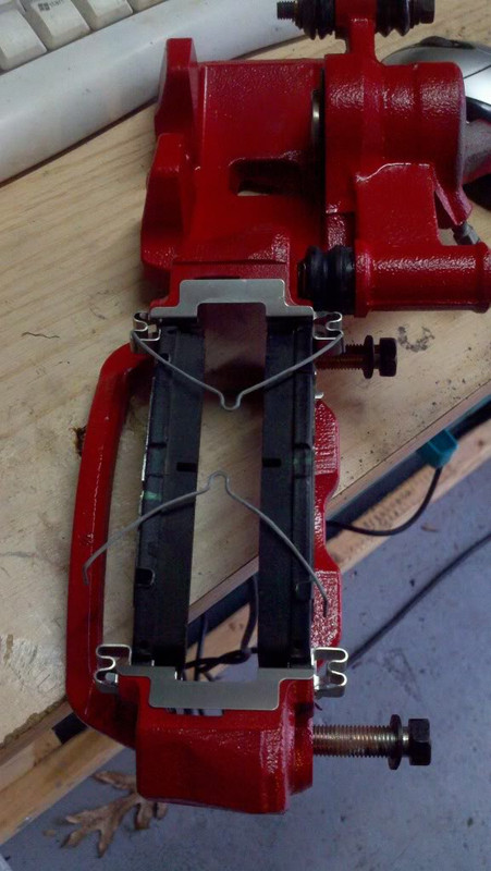

New brake hardware. Didn't even know there were supposed to be wear clips on the back:
Still waiting on one more box for the rear subframe; a little DIY project for the rear bushings.
PS- in that last pic, I got a bit carried away with wear clips, and accidentally put all 4 on one side.
I've fixed that, though. :)

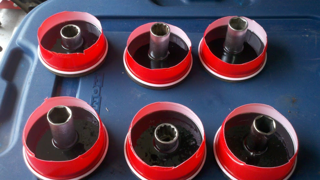

So here's what I've been doing today.
I had BIC nylon rear subframe bushings, but they were too noisy, transmitting too much of the diff noise into the car.
If this were going to be a track car, I wouldn't care, as they do take out all the slop, but this is going to be a road car for 99% of its life.
I tried Raptor racing for rear bushings, but they were out and didn't expect to be ordering a set any time soon. So, I decided to make my own.
Not bushings, mind you, just a replacement spacer to ADD to the originals. The rubber on mine was in great condition, they just weren't thick enough
to take up the slack. So I just used them as molds for the additional thickness of a liquid urethane spacer, in 80A hardness.
My original bushings:
Cut out some drink cups- perfect diameter for this project:
To make sure they didn't seep, I silicone'd the cups on:
I placed in sockets to match the center shaft size. Both the insides of the cups, and the sockets were coated with a PAM cooking spray:
Liquid urethane mixed with hardener, and poured, making sure to match the levels between the spacers:
Now, I just have to wait two + days for full curing before the subframe is reinstalled.
Then I finally go on to the front suspension.
4,283
78
We'll see.
I checked the new spacers tonight, and they are almost fully cured.
They seem to be just slightly harder than the original rubber, which is what i wanted.

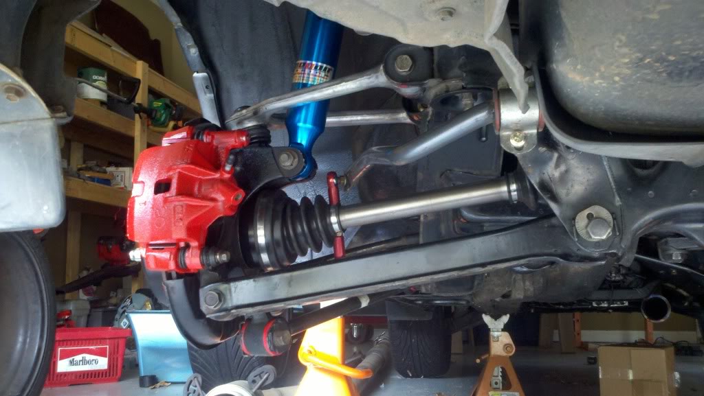

Getting there...
Subframe in, Shocks, Ebrakes, and halfshafts connected.
Tomorrow, I'll finish reconnecting the brake lines and driveshaft, and then I'll turn the car around so I can begin on the front suspension and brake upgrade.
4,283
78
Rear subframe/ suspension: DONE
Oops- I guess I have to adjust the ride height back there...:biglaugh:

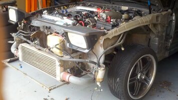

Got some good progress done today on the front.

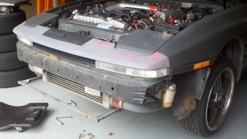

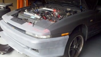

I started taking off front body panels to facilitate my access, as well as reduce my workload when I start on the bodywork stage:
Removed old busted Kaminari bumper:
Then the header panel, bumper reinforcement and grill:

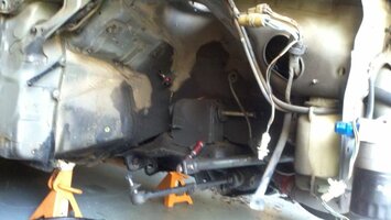

Then the inner and outer fenders:

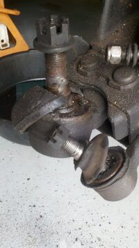

Then on to the front suspension. Apparently, my tierod ends and balljoints were more tired than I thought(they were all replaced about 8 years ago):
Looking pretty bare:

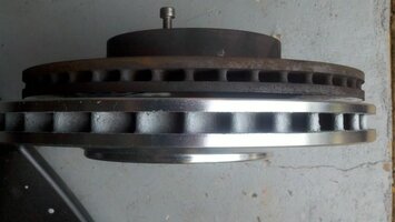

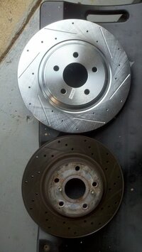

Also, my Cobra rotors showed up. Here's a comparison to my old rotors:
Now I'm waiting on the bracket kit for the brakes, and new balljoints to arrive.
