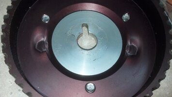

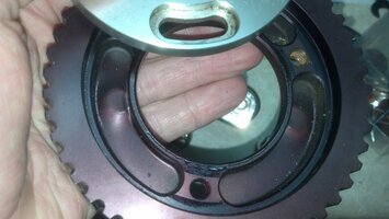

Holy crap! I figured they'd be scratched a little or a slight indent but that looks pretty bad! Thankfully the worse side goes toward the head.
supraguy@aol
Well-Known Member
Dec 30, 2005
4,239
Atlanta
Yup, but there's no distortion to the inner surface, or the plane of the mounting face.
And thus, no affect(wobble) on the plane of rotation of the belt face.

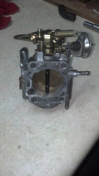

Almost done rebuilding my throttle body. For those just tuning in, I had torn one of the two throttle shaft seals when I took it apart.
So I purchased another throttle body online in order to obtain exactly ONE throttle shaft seal. They are not available(to my knowledge) anywhere new, so this was my solution. The good thing is, that it was a super cheap, and included the TPS, so I can resell that on Ebay, and pretty much get the throttle body for free.
Here it is, in all its re-zinc'ed glory:
I say i'm almost done rebuilding this thing, because I need to replace the two screws that hold the throttle plate in the shaft. It's hard to tell from the above pic due to the angle, but the two m3.5x.6x6mm screws have very large heads to them, a good bit larger than the originals. It was a serious PITA trying to locate some m3.5 button heads, but now they're on their way from China. Also, I need to pick up a couple of m4 washers for the new screws that will hold the TPS on.

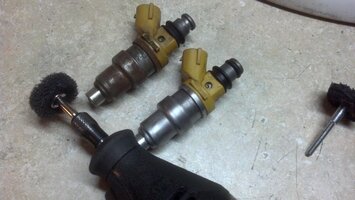

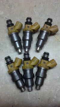

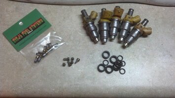

Cleaned up the injectors.
Replaced the filters.
Clearcoated the metal sections and put on new o-rings.

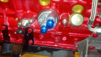

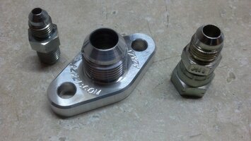

Care package from Driftmotion came today, a few connectors I needed.
Oil pressure port, oil return flange, oem to -an fuel feed adapter.
Installed:

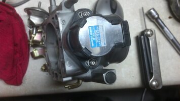

Finally fitted the tps to my throttle body, and adjusted it to spec. ALOT easier when it's off the car.

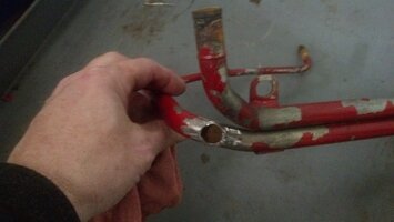

You know that nasty, pointless, "put-a-rubber-cap-on-me-and-i'll-blow-it-off-when-you-least-expect-it" coolant nipple on the back of the motor?
The one that nobody in America needs? Decided to cut it off and have it welded shut. There's just no reason for it.
Once it's welded(hopefully tomorrow), I'll media blast it and either paint it or powdercoat it.

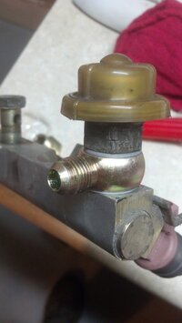

Also, I want to use -AN lines for my fuel supply to the rail, but I really didn't want to get rid of the benefits of the fuel pulsation dampner.
So I found this:
It's a 14mm - 6an banjo adapter. Fits right on the rail, and even includes both properly sized crush washers(the two are different sizes from each other).
Now I can have my cake and pulsation-dampen it too.
