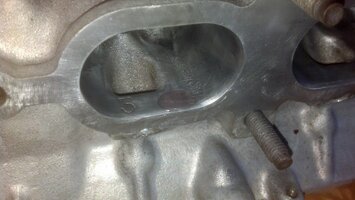

Ok, I lied.
I don't really want to post pics of a dirty cylinder head, till I have some real progress on it.
I'm pretty much done with polishing up the intake side, and I really only plan on cleaning the exhaust side.

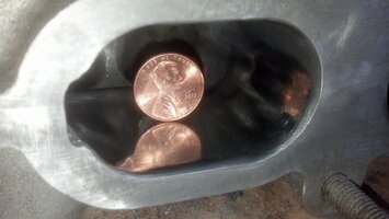

LOL.
I think I'm getting too OCD about polishing this stupid head...
The ports aren't perfect all the way throughout, but I realize that IF I really wanted perfection, I'd have to polish the intake manifold and runners as well, and frankly, I don't have that kind of motivation.

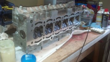

The head? Not much.
Maybe 3hrs porting/ polishing.
Just spent about 2hrs cleaning the valves, rough-lapping them, then fine-lapping them into the seats.
I'm about to clean the head and begin assembly.

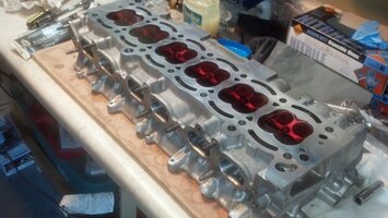

Valves installed.
Leak testing the valves, to see if the lapping was adequate.
Oops. So far, I have to re-lap intake valve #1 on cylinder 4.
Yes, it's koolaid.
