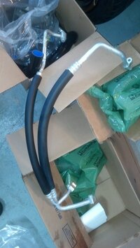

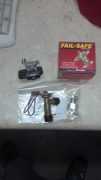

Got another few bits today:
failsafe Tstat, ac expansion valve, and blower motor resistor:
Also, brand new a/c suction and discharge lines:

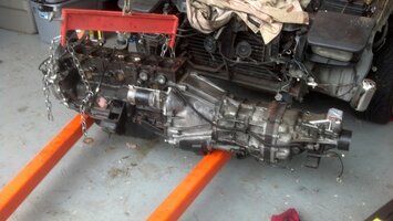

Well, that was a bit messy.

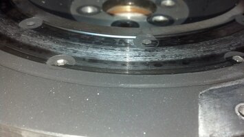

Separated the tranny from the engine, and found that I had really chewed into the flywheel.
It's a replaceable insert, but I dunno how hard it's going to be to get one. Gotta start google'ing.

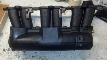

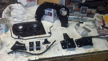

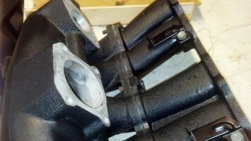

I went over to my buddy John's house a couple days ago, and got some more work done:
Along with the intake, I also did a few small brackets and support rods, as well as clearcoating the coolant piping.
Tomorrow should see the final assembly of the engine. Then it's on to the clutch/ tranny, then install.

Cannot wait to see those beauties on that engine! Any particular reason you decided to go black on the manifold? Just curious if it was a personal taste or if there was an underlying mechanical advantage to the black powder coat.
Every time I visit your build thread I seriously drool over your car, it's a damn work of art and it's not even finished yet.

No, there's no benefit to the black powdercoating performace-wise, but using a powdercoat finish makes it very durable, and means i dont have to keep the aluminum polished, and also would hide any dirt smudges. I had read someone else's build thread years ago(couldn't tell you who), but they had done their manifold in blue wrinkle finish, and it looked great.
I'll have more pics up this afternoon.

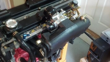

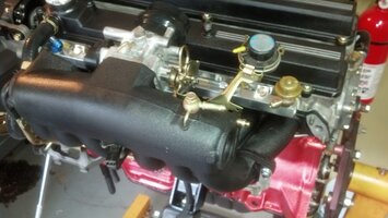

Couple of pics of the manifold in place.
Still have to sort out some of the coolant hoses. I can't figure out which are for the throttle body, from the silicone kit I got.

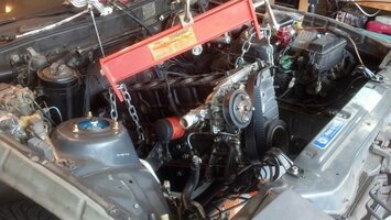

So today was just a little bit of fiddling around with little stuff, and taking note of what gaskets/ fasteners I still need.
When I pulled the old motor, I dumped alot of tranny fluid on the floor, and though the kitty litter soaked it up, I was getting tired of the stank,
so it was time to pull the car out and sterilize the garage floor again.
This is the first time my car's been out of the garage in over 6 months, and then it was only out long enough for me to pull the intercooler system.
Tomorrow I have to work, but regardless, we're getting to the point where I have to take a break, while I get another batch of parts in.
This time, I need the clutch, a Spec 2+. I originally had planned on tearing apart the tranny and "Marlin-Crawlin" all over it, but since it hasn't given me any grief, I think I'll save the money and the downtime to push on and finish up reinstalling the drivetrain. I have a LONG road still ahead in this department; Still have to:
