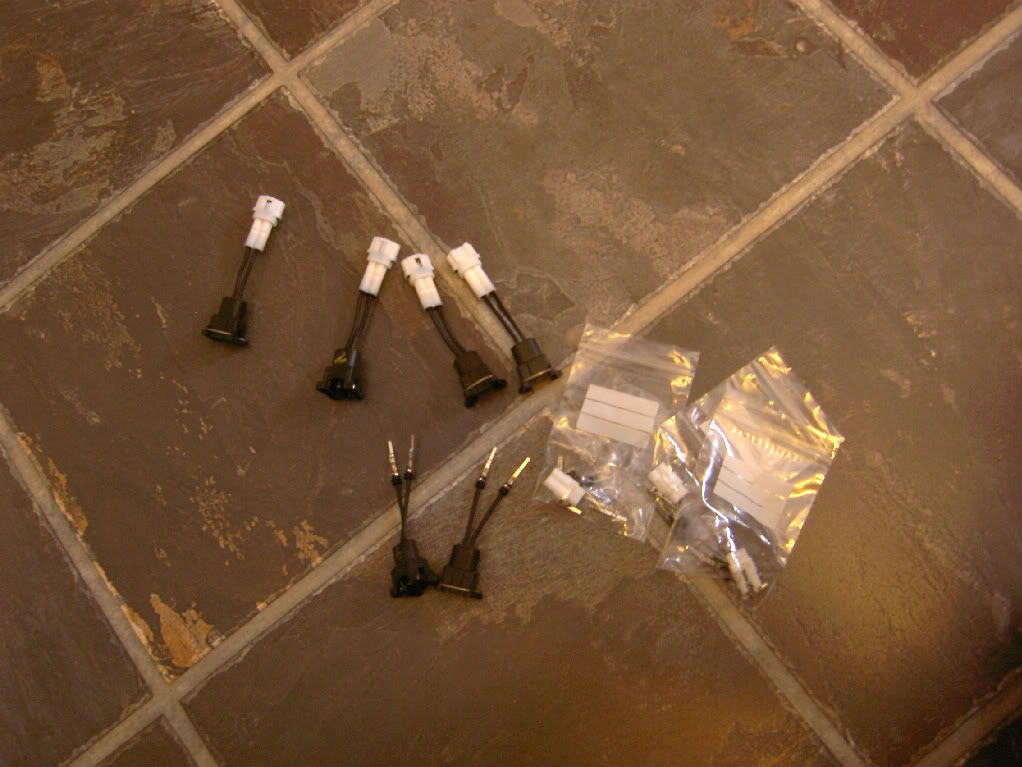

Here are some adapter harnesses for my injectors. While the white connectors don't directly clip into the harness, all I had to do was de-pin the stock connectors and clip on the appropriate mating connectors. (note, I've still gotta order a few more plug assemblies...)

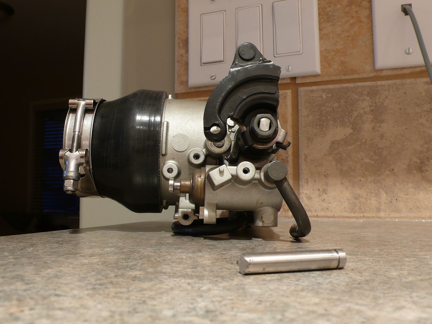

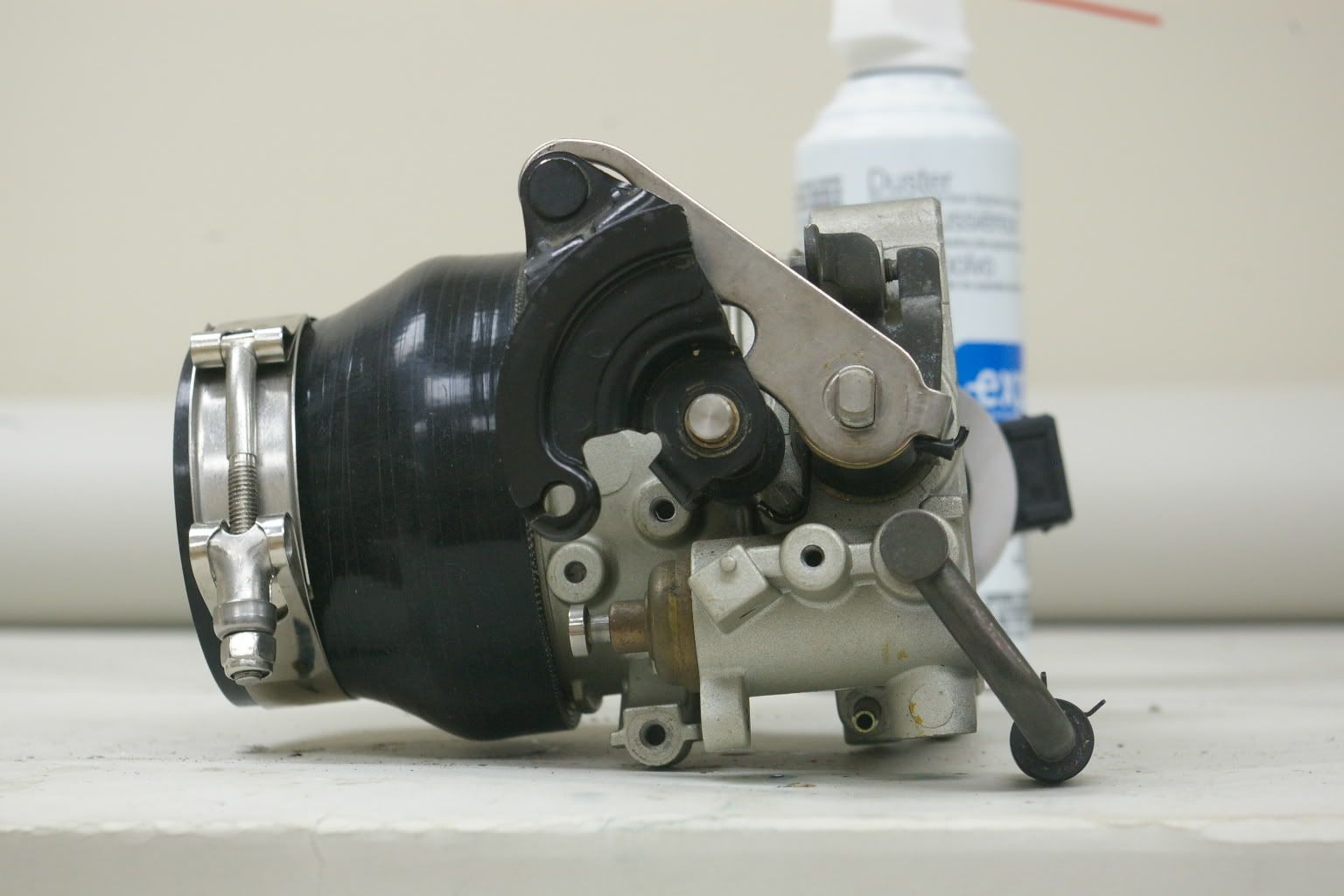

Figured out the throttle body...it was a lot easier than I thought it would be. Now, no more hitting the hood, although I still might have to make some adjustments to the leverage of the gas pedal.
Before (it was the silver arm that hit the hood)
After (black arm directly connected to throttle plate)

Was the plate travel non-linear before?
It looks the way the black piece was slotted into the silver one that were made to swing the silver piece faster as you get closer to WOT. I see that kind of thing on a lot of cars.
Correct. Like most throttle lever arrangements, it is set up so there is a lot of pedal travel for the initial opening of the throttle and less for WOT, making the car a lot more driver-friendly. I'll see how this works out, I may have to hit the junk yard in search of "profiled" throttle levers.
I did install the TB last night and pedal travel is perfect for opening the TB all the way...so that's a step in the right direction at least.
