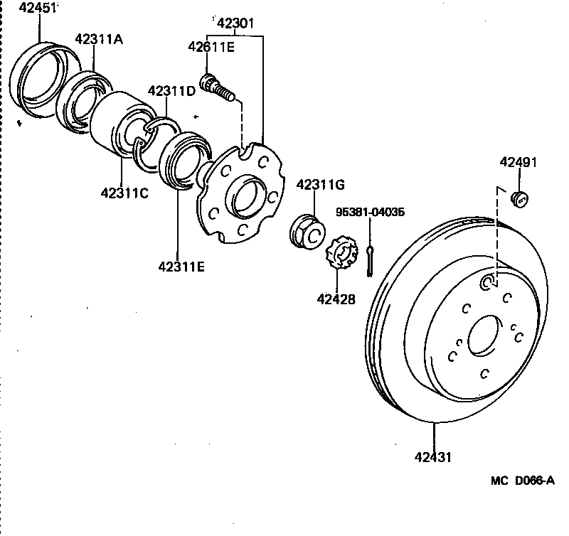

So today I went back to the garage where my buddy works, after hours. I spent some time on the left and right hub assemblies, as can be seen here by the EPC diagram, as always, click to enlarge:
And here's my progress for today, full disassembly of both rear hubs, waiting for my new seals, bearings, races, etc... to arrive at the dealership:
