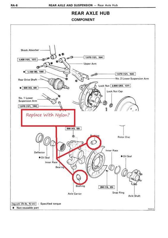

Hey Doc, I know you plan on replacing all your stock bushings with the same nylons I have from Geoff. The only documented failure is in the #1 arm as we all know.
I remember reading something that IJ. posted about not wanting poly (I assume he means the RK polys) in place of these- Click to enlarge:
So I was wondering about your thoughts, as you use your car for what I plan to use mine for, generally speaking- Would you replace the above bushings with Nylon? And I know that drilling/tapping for zerk fittings is a must, but should I drill/tap the hub, or just keep track of how often I've greased it and disassemble it to do so?

Chris, you know how I feel about delrin used for bushings like that. I don't think it's a good idea.
Maybe IJ will chime in about why he didn't want poly back there. The only reason I could think of is that it's too stiff and causes bind, but if poly would do that, then delrin would be even worse. Even if you grease them every mile, they still won't be able to account for the change in axis with suspension travel.

Tim: Yeah, I'm not entirely sure what I'm doing with those yet. I have brand new OEM units for them if I decide not to go with the nylon. This car doesn't see a huge amount of street time anyway, mainly some weekend nights.

5
If I remember right, those two areas you show in the part diagrams, or at least once of them is a spherical bearing from the factory and gives very little to start with (well, until they wear)

^ I remember IJ. saying something like that. Two of mine were totally toasted, incredibly sloppy.:(
