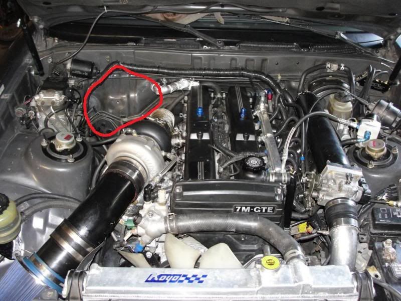

Steve could you possibly stick a catch can in this area? Looks like there is even an empty bolt hole in the firewall there that is wanting a bracket for a catch can in it. :)
You wouldn't really have to worry too much about the exhaust melting lines to it or anything either since you have everything wrapped and coated. Otherwise you could probably just run them along the firewall for peace of mind.

That's where I had it before the manifold swap, but the oil dipstick now occupies the area directly underneath it. (the heater coolant control valve sed to live there)

Why not pick up or make a small catch can that will resided in the same area, all in perfect Harmonie. It isn't like you need it to hold a qt of oil,......that is unless you have that much blow by :naughty::naughty:
Something like this is what I plan on running.. 3.5" X 3.5" X 6"

I coud see something like that working, as well. I'm likely going to run 2 catch cans in an effort to minimize the oil getting into the intake tract. A bit overkill- maybe, but it should work pretty well.
One there next to the turbo to catch the main stuff, then pass through to the fender and run through either a copper or AL pipe to try and cool the gases down, then into the 2nd can and into the intake. I just cleaned out my IC piping and it had a film of oil on it, where it had never had that without the vent. Catching a lot of water, just not much of that hot oil.

2 normal catch cans= dual chamber :p Works much the same, only the way I would have it set up the 2nd can should be much cooler than the one in the engine bay, and should do its condensing job better.

Eh, you'd only see one of them, the other would be hidden right inside the fender next to the air filter with a short run or 5/8 to complete the system. I just don't want a lot of oil building up in the pipes- yuck. Who knows, I might just go back to a road draft tube if worse comes to worst.
