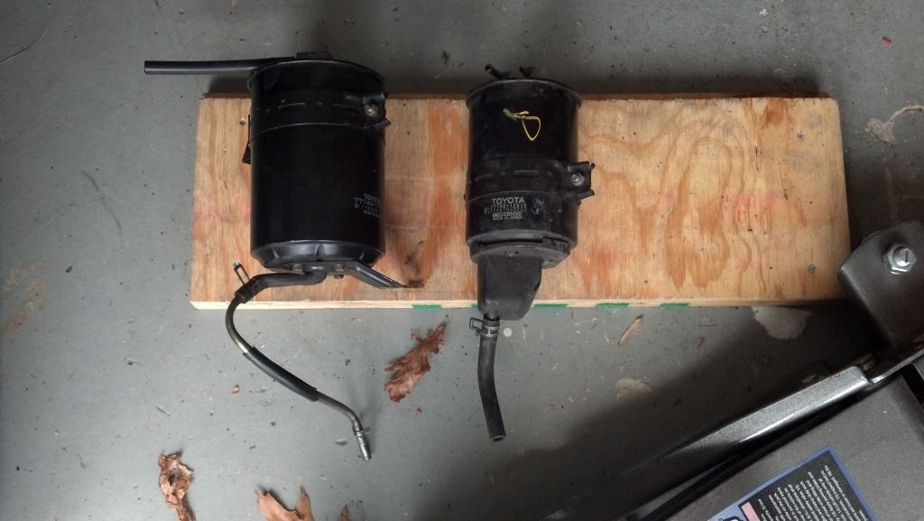

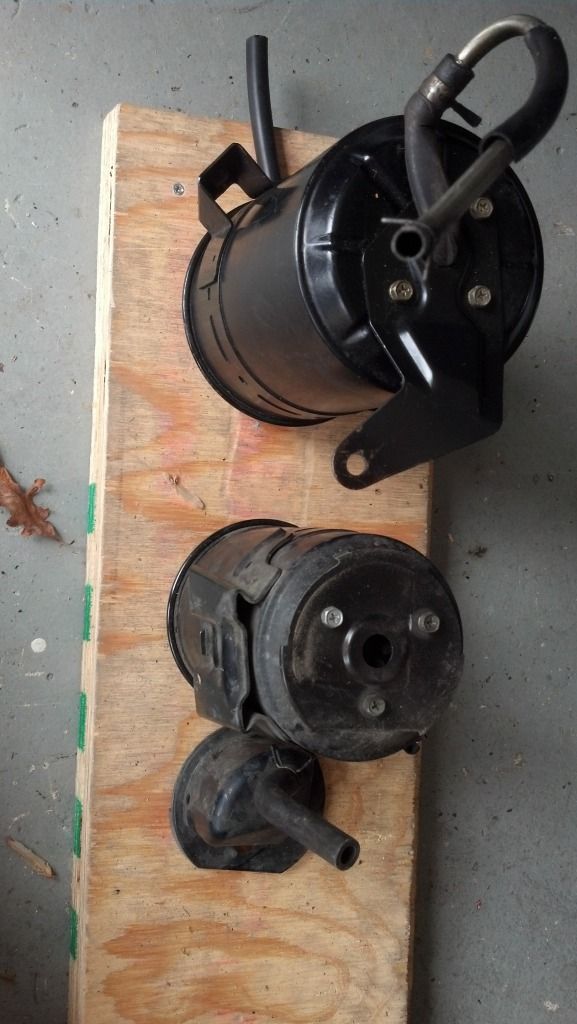

Went to the junk yard, and found an evap cannister out of an early 90's corolla that I liked.
Obviously, it's smaller than the Supra's. It may even be the same one found in the 90's trucks, no sure. I was able to remove the bottom plate on each, and can simply swap over the drain assembly from the larger can. I was going to cut up and modify my original bracket, but then I got sidetracked...

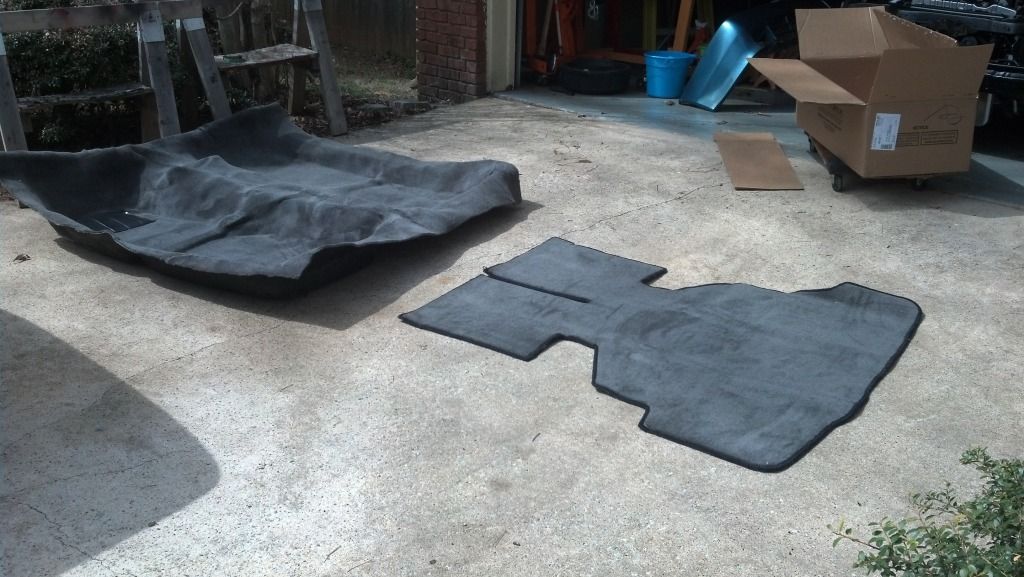

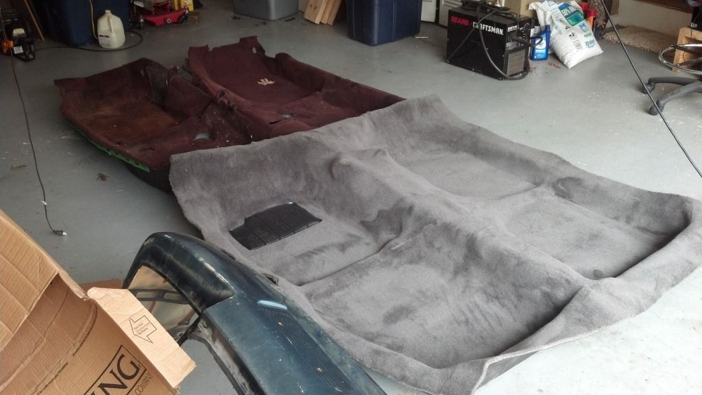

My carpet arrived.
Looks like two totally different shades, depending on the lighting, but it's charcoal molded carpet, with optional mass backing, and super plush upgrade. I'm glad I opted for massback, because apparently, the oem carpet had it as well, although not as thick. I got about 2/3 finished trimming and fitting it, but it's actually alot of work to get it right. I have to work most of this week, so hopefully I'll get a chance to finish it by the weekend, and can show off some pics. Interior will be two-tone(obviously), with the seat centers and front/rear door panel inserts all recovered to match the carpet, which I tried to match as closely as I could to shadow grey.

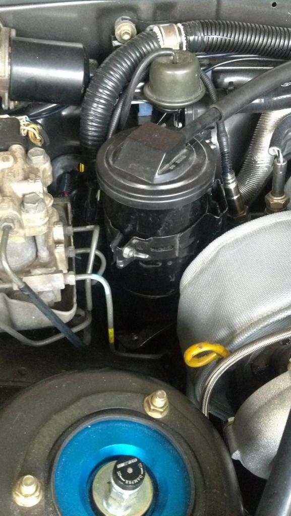

I've been working alot, and only had a couple hours today to play with it, so I worked on the evap cannister.
Cut the original mount, and welded the smaller bracket to it.
Then installed it.

Glad to see continued progress. Mine stalled out for awhile damn NE winters without a heated garage. The nracket you fabbed up came out nice and looks stock but smaller
= win.
