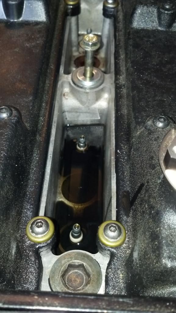

Here's the #1 & 2 spark plugs, when I pulled the coil assembly off:
I just don't get it. The valve covers are secure, and the galley plugs are sealed. I suspect that this head might be cracked somewhere.
I'm thinking of dropping my backup head off at the machine shop, to have it decked and get a valve job done...

For what its worth I always seem to get some oil in there. No matter how well I seal everything, some oil always ends up in there, either from the valve covers or the hex plugs. I've just come to accept it lol.

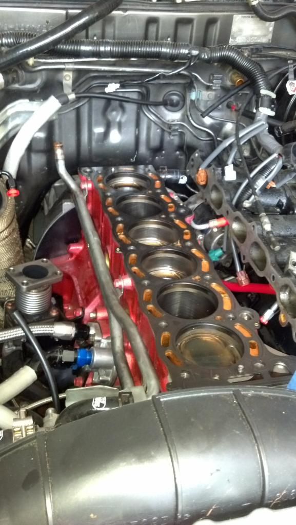

So, I pulled the head this afternoon.
Both surfaces looked good, as did the gasket. In fact, the gasket looks perfect- none of the viton even broke.
However, it seemed like the entire surface of the gasket was oily, as was the deck surface, so I think that the oil passages weren't sealing,
and that oil was squeezing out between the head and block. Now I have to decide what i want to do-
Tear down the current head and have it checked by the shop, or build the backup head. Not sure, but I'll fiugre it out.

I'm trying to imagine how you could physically have an oily surface on the headgasket, both sides. Doesn't seem possible unless your head "floated" and I can't imagine that happening. I can imagine a hairline crack in the head that could allow the oil into 1 and 2, but that should be visible.
Gremlins... You gotta love them... So far I have had 3 of these types of issues where it didn't make logical sense. Luckily I had a team of mechanics spend a lot if time on it... So I didn't have to use my limited knowledge to troubleshoot. Hope it turns out being something small...

Not sure what you mean by the third part in the middle of the valve cover?
As i mentioned, the valley cap bolts were all tight.

I used big drain plug gaskets for those.
It possible with the new fluid it could have leaked out and then in the time it sat the trail disappeared.
