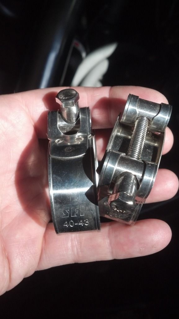

Finally got home, and found a couple of parts waiting for me.
Got some proper sized corbin clamps for the heater core hoses, And some beautiful Tbolt clamps for the radiator hoses.
I won't be able to work on the car till maybe sunday, but now I can fill the cooling system. If that goes ok, I'll be reinstalling the dash.

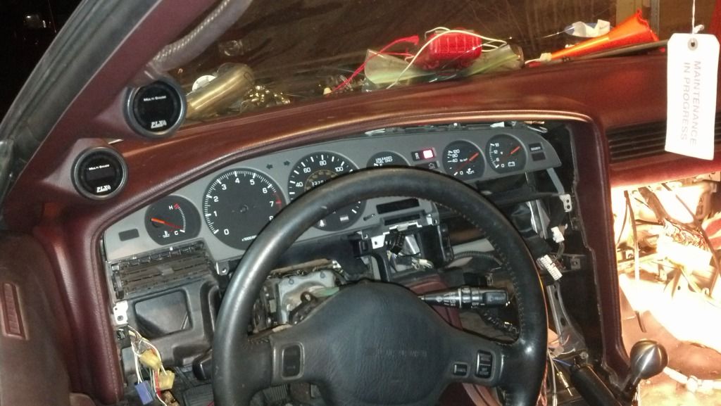

So, dash is in, and I'm working on setting up the needles.
For some reason, my tach and oil pressure aren't working. Not sure if it's because I left a few things disconnected, or if the gauges themselves are at fault. More research is necessary.

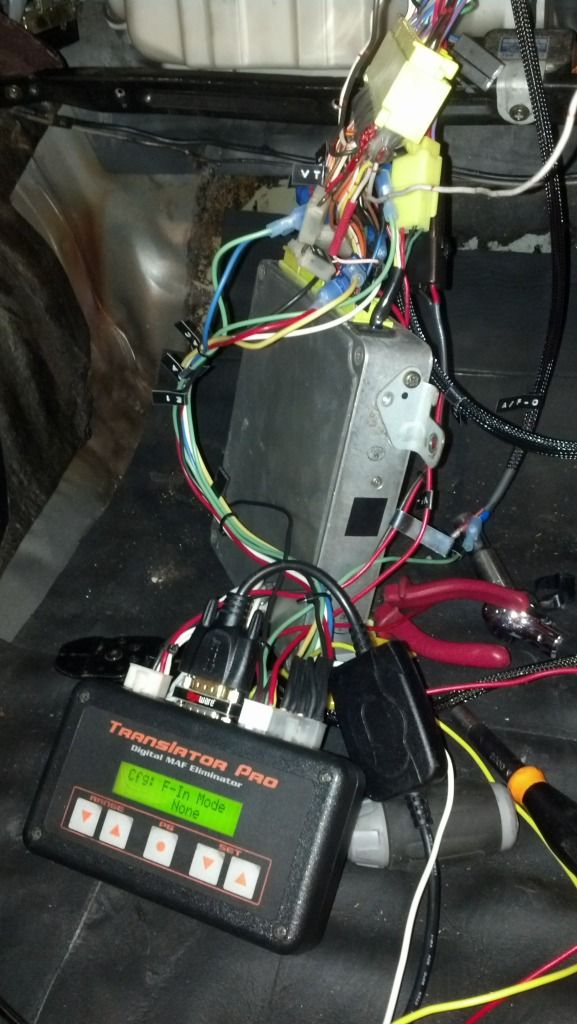

Also, Got a good start on wiring in the MAFT pro. Just a few more connections to go.

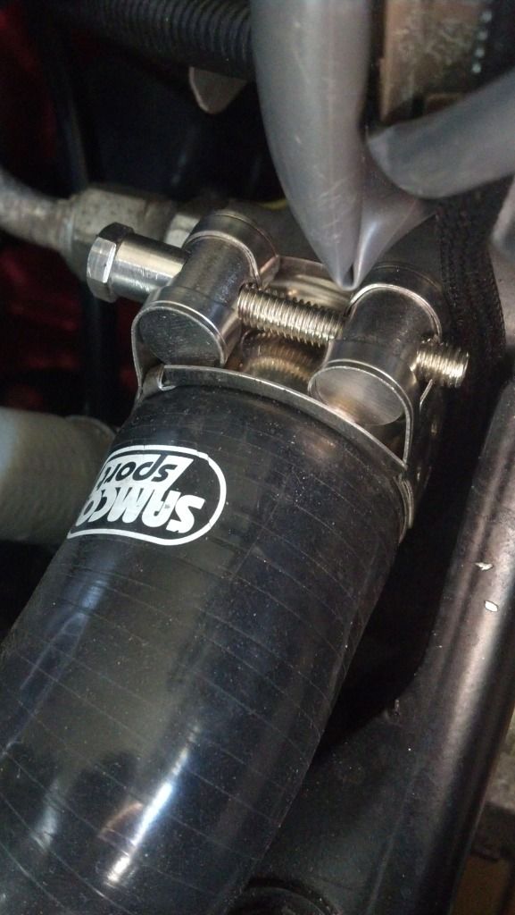

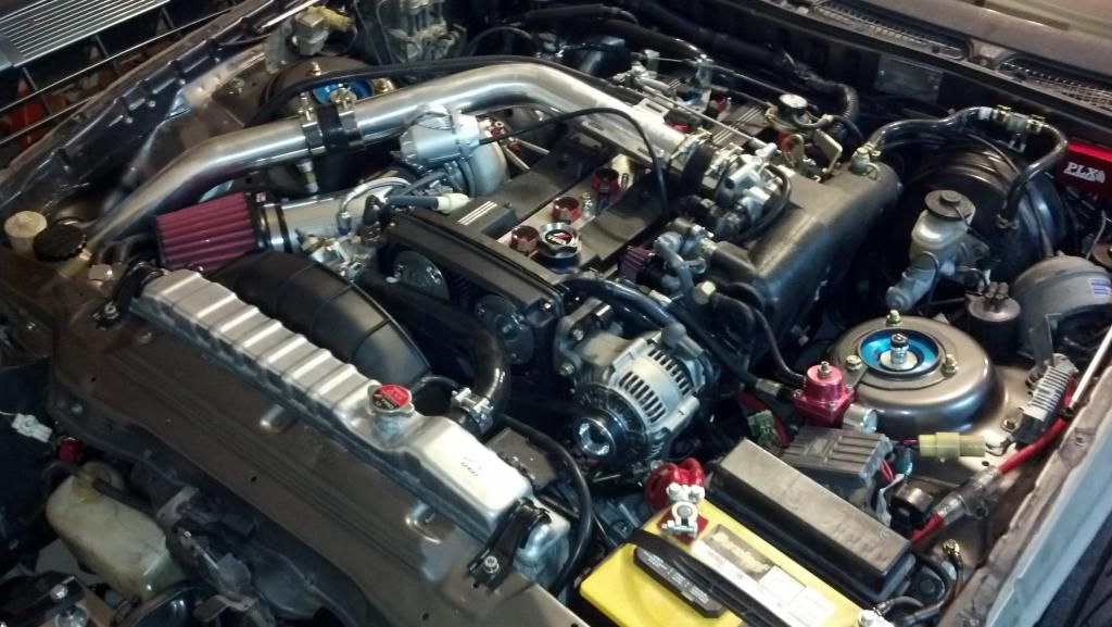

So I picked up my lower IC pipe from the fab shop, where i had to have the inlet rotated about 10 degrees for proper alignment. Fits good now.
Then I locked down all of the IC piping. I was one clamp short, so had to order one. Then the induction system will be finished. Then I installed the intake system and both pcv lines to and from the catch can. I also ordered a few quarts of Amsoil severe gear 70w-90 for the tranny.
All that's left unde the hood(if there was a hood), is a couple of vac line clamps, and the evap cannister. Excited to get the new carpet in, and officially start Stage 3: interior.
PS- One other thing- Now that I've verified that the cooling system has no leaks, I will drain half the water out of the cooling circuit, and replace with Toyota red.
