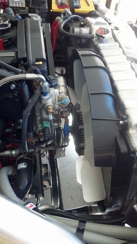

Today, I did just a bit of coolant system work, installing the shroud, fan and aux fans.
I wanted to fill it up with coolant, but I'm missing a couple of clamps for the hoses, so I'm waiting for those to arrive.

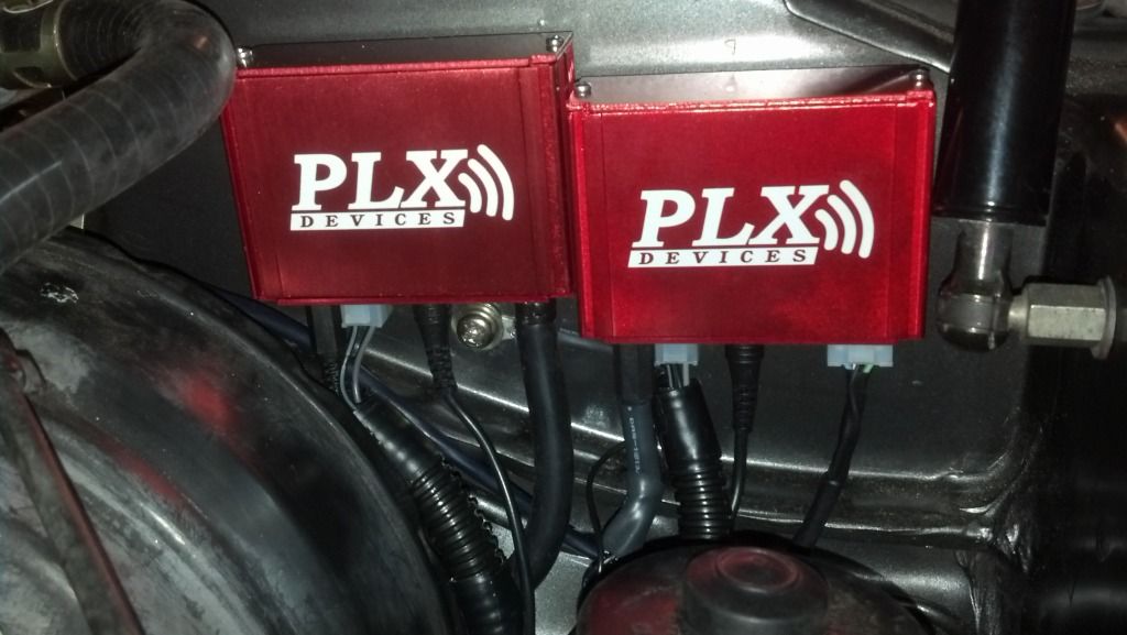

Then I got busy with some electrical- wiring up both PLX units- wideband and boost/vac.

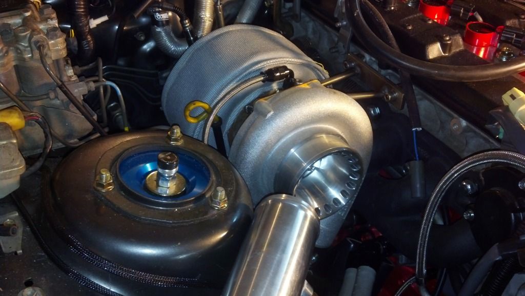

Went back into the garage tonight, and got a few more things done.
I extended the boost solenoid, IAT and temp/oil pressure warning harnesses, and ran them through the firewall.
Then I installed the turbo blanket. I may have to get a smaller charcoal cannister, though.

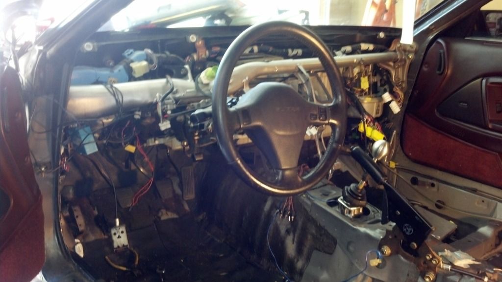

Finished all the wire routing that I think I need to do.
I think it's time to go down to the basement and grab the dash...

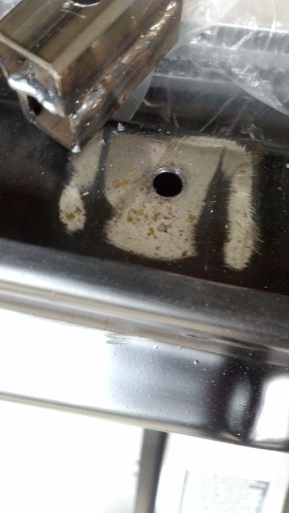

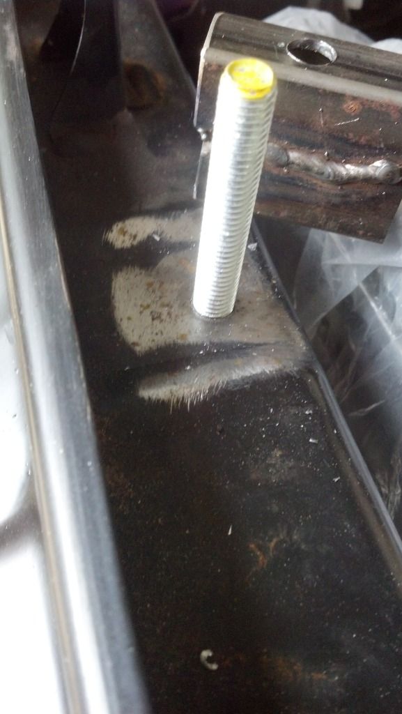

Instead, I did a bit more work to the intercooler system. Needed to create mounts for it.
Drilled and tapped the bumper.
Added some threaded rod.
And made the mount.

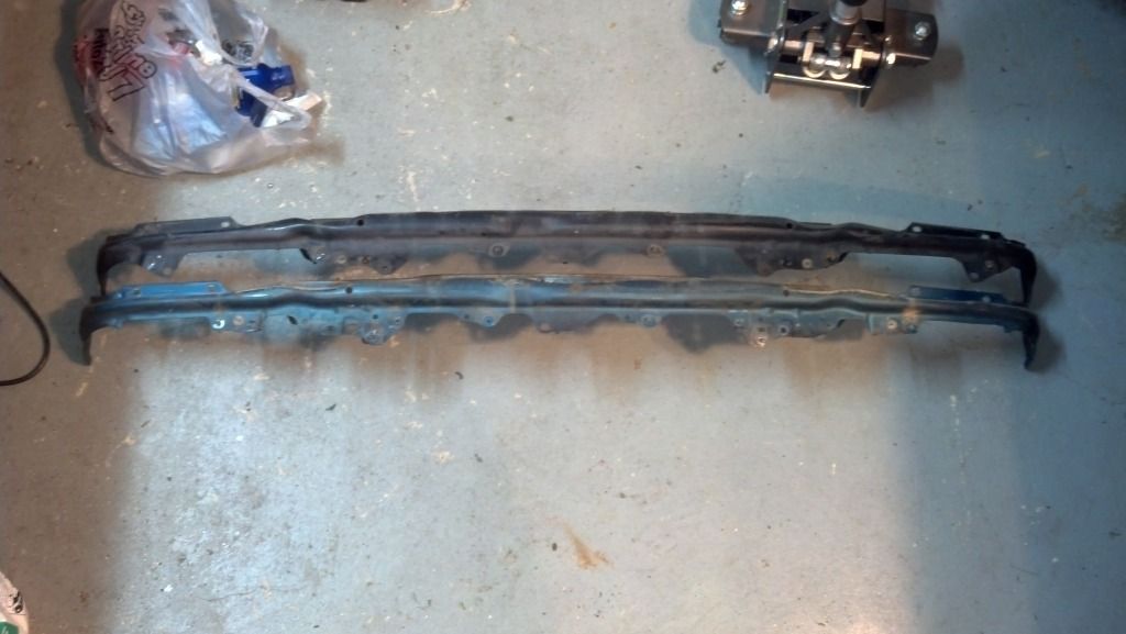

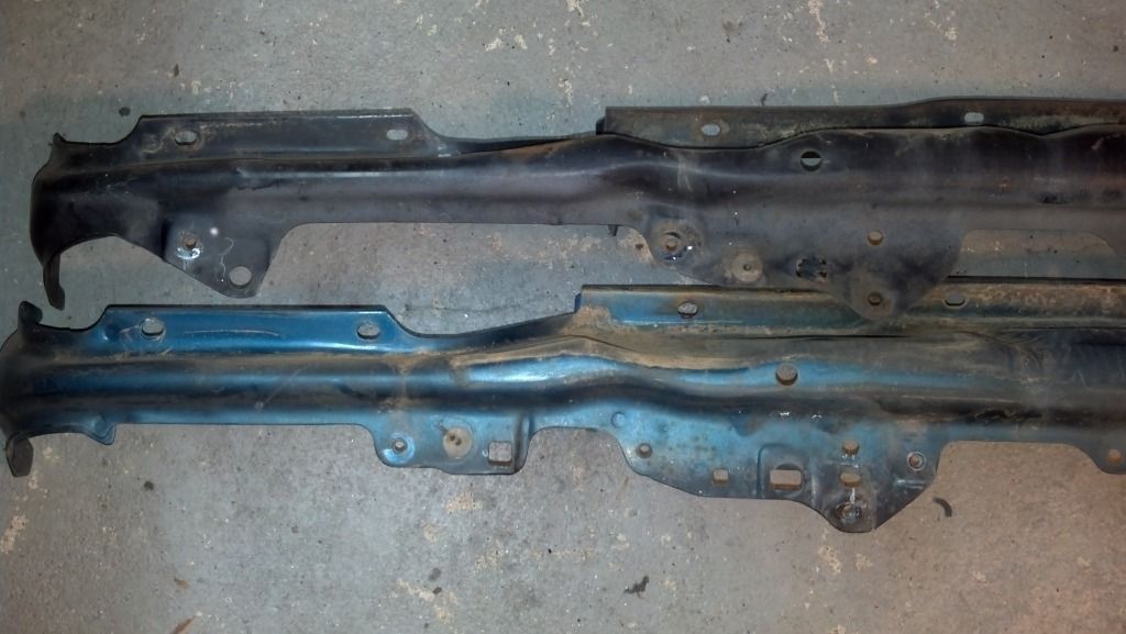

I did a quick comparison of nose braces tonight.
I knew they were different between -89 and 89+, I just didn't know how. So here ya go.
'88 in black, '89+ in teal.
Here's where the differences lie-middlepoint on each side.

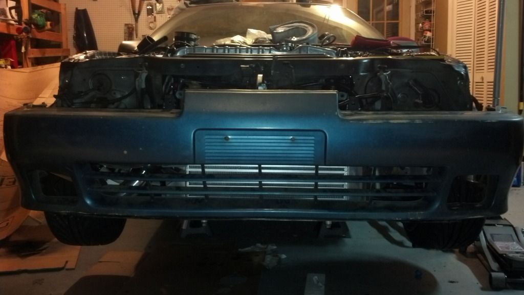

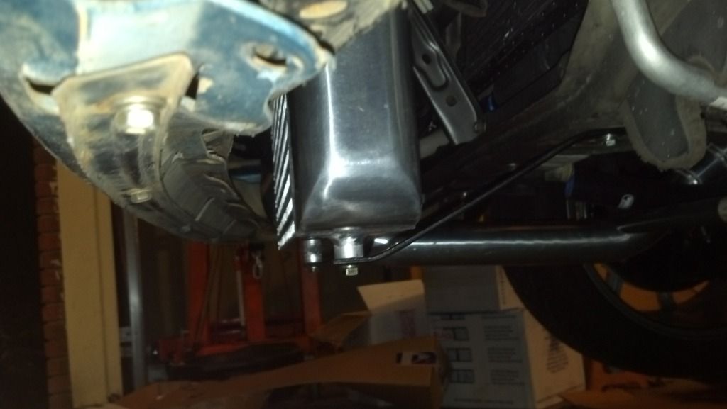

Then I finally filled the PS system with Dexron VI, at the suggestion of Orion Zygarian. No leaks so far, yay.
I also finalized my IC install, and created the lower brackets. It's rock solid now.
I even threw the front bumper cover on, just to see where the lower edge would be in relation to the IC. It looks like it'll be flush with the bottom of the front lip, once it's installed.
Now I'm waiting on various types of clamps to arrive. Once they do, I will add the final liquid to the engine- coolant. Then I can check for leaks on that.
