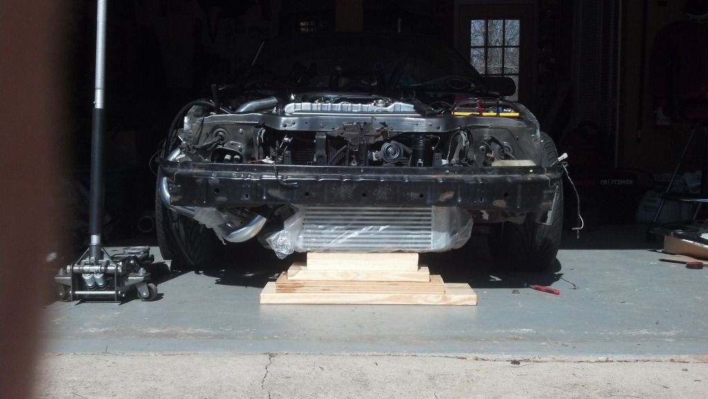

Dropped the IC pipe off for extension, should be ready Wednesday or Thursday.

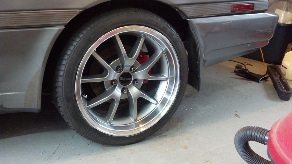

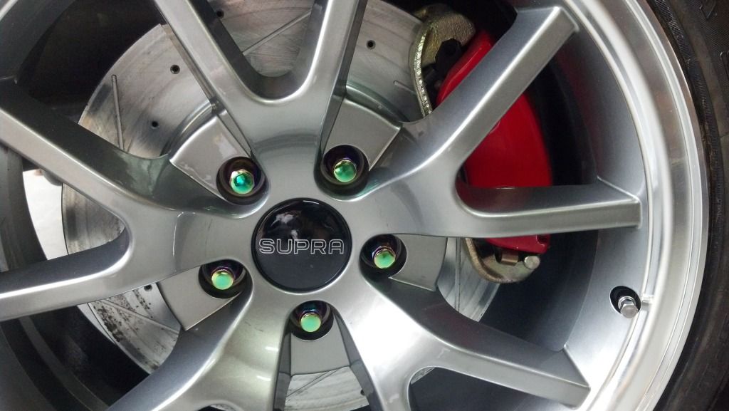

Received my new wheel lugs. My originals were nice, but too narrow. Needed more seating surface. They're kinda bling, but what the heck.
Also...a bit of customization, to make the wheels look more like they belong...

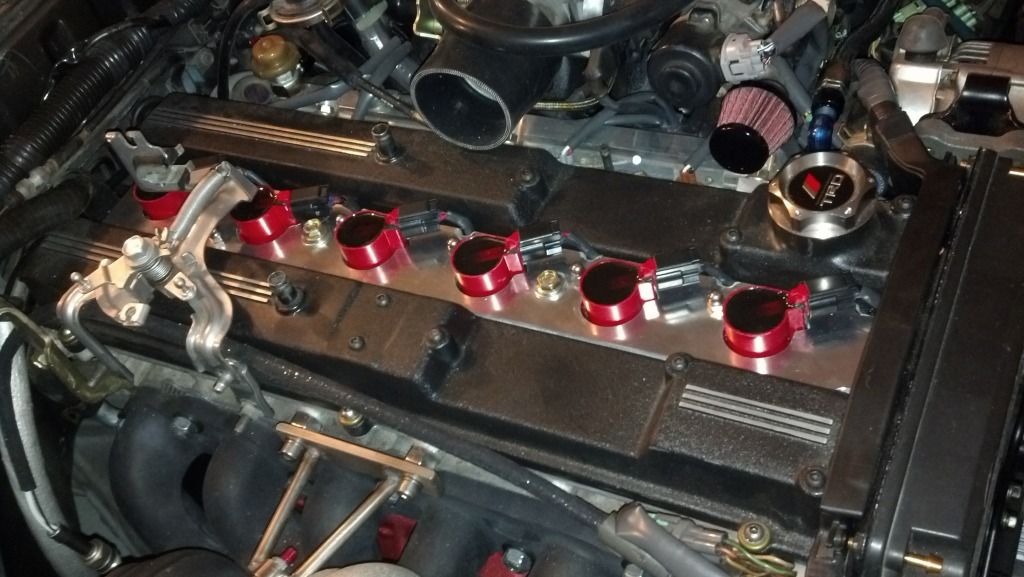

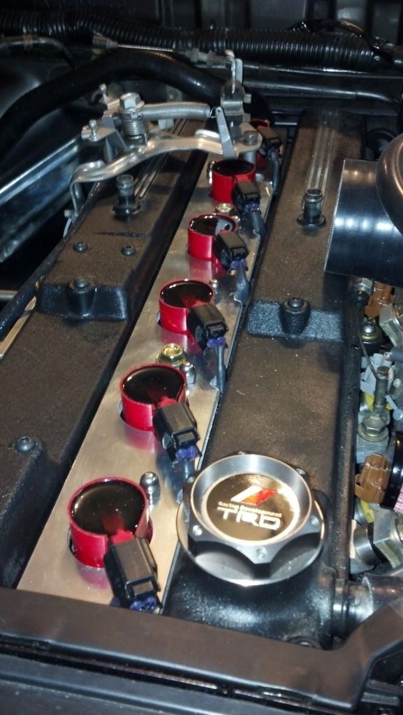

Then, I finished modding the Nathan plate, to fit with my throttle bracket assembly, as well as incorporate the DG528 at cylinder #5. Then I installed the coil harness...Underneath...

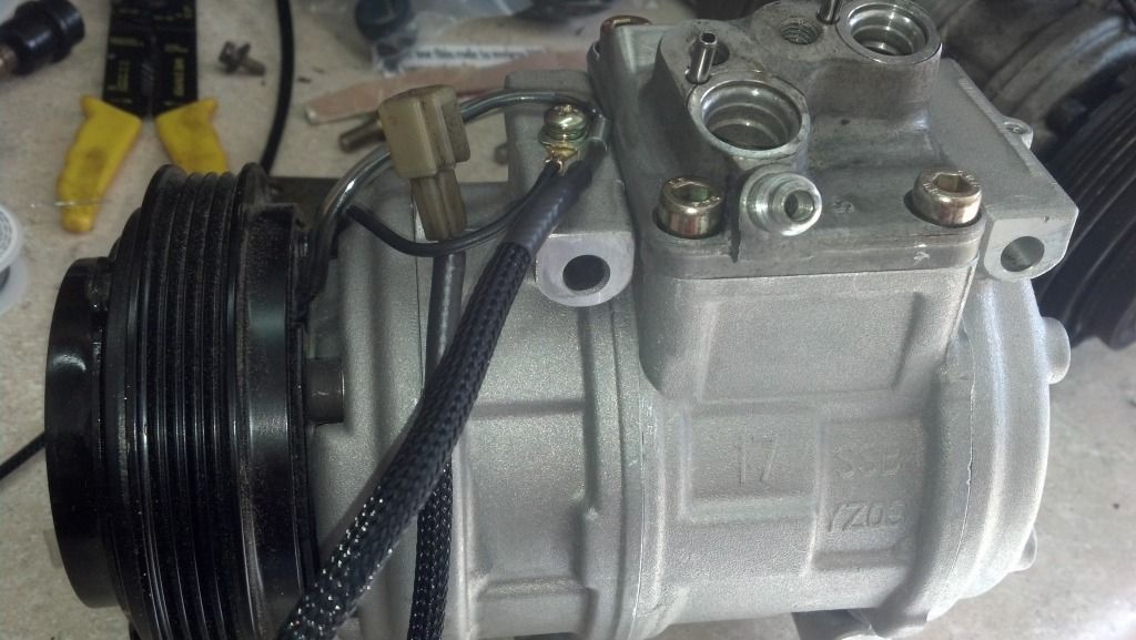

So the big speedbump on my build, has been the ac system.
I didn't want to install the dash till I could confirm that what's behind it(the ac core) was leak-free.
I pressurized the system with argon, and have found that it bleeds off over a reltively short period of time. I tried spraying each connection with soapy water, but I get no bubbles anywhere.
Also, no hissing sound of escaping gas. The only part of the system that hasn't been replaced, is the compressor itself.
...a new compressor is on the way.

I would say off a bit. The #5 coil mounting hole would be on the innermost edge of where you would creat a larger hole for the bracket post. What i needed to do was get that side of the bracket to sit slightly higher, but i didn't want to cut/ weld a set of higher mounts on the other end. So what i ended up doing is tilting it. Hard to explain. Im out of town for the next couple of days. When i get home, i'll take closeups and post a more detailed description, probably in Morganson's thread.

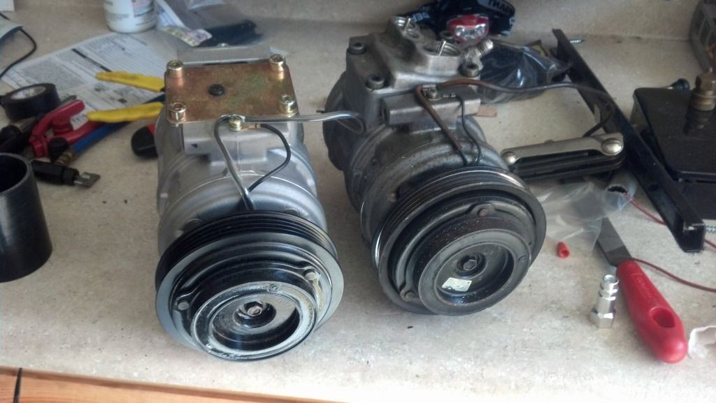

So, if I haven't already mentioned, the roadblock to my flow of progress has been the ac system. I have had a not-so-slow leak in it, when I check under vacuum. And there was no way that I was going to reinstall the dash, in case the leak came from the evap core.
So, instead I decided to pressurize the system to see if I could locate the leak by sound, or using a soap spray to identify bubbles. I connected an adapter to my welding(argon) tank, and ran that into the high and low sides of the system at 40psi, and sure enough, it would leak down to zero in about 15 minutes. Unfortunately, I could not find any leaks, or hear any hissing.
The entire system is brand new- new core, condenser, expansion valve, drier, high/low pressure lines, and all O-rings. Everything, except the compressor itself. So I decided to just blindly throw money at the problem, and bought a new compressor.
It worked!
Apparently, it was leaking from either the case seal, or shaft seal. I just finished installing it, and the pressure hasn't dropped a single psi in 15 minutes.
This means That I can now finally install everything- the dp/ exhaust, the heater core, the dash, and start planning out stage 3- interior.
Old and new.
New one, with the top plate and plug swapped over.

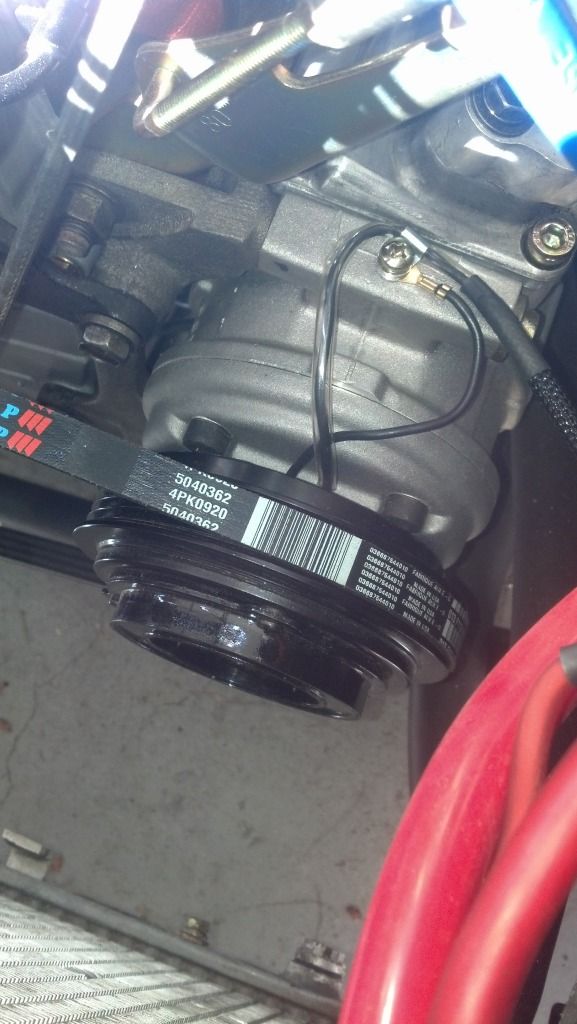

New unit, installed.
I expect the pace to pick up a bit now, on the completion of stage 2.

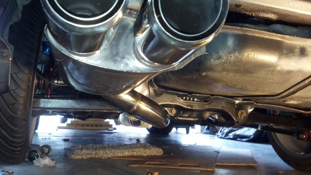

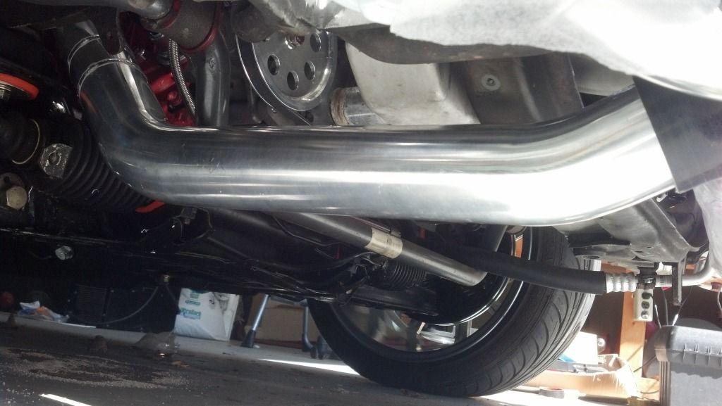

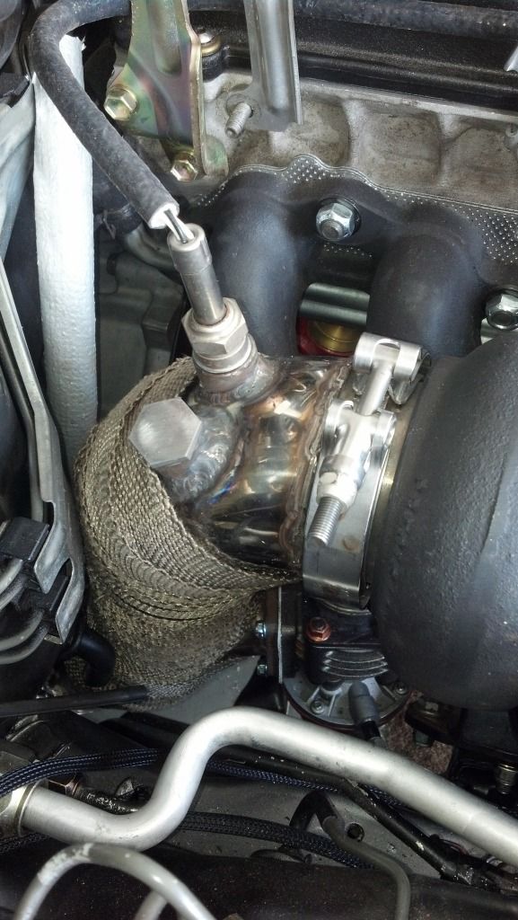

Today(so far), I've reinstalled the DP, and exhaust, hopefully for the last time.
And...Here's a quick video of the first 'sound' through the exhaust.
[video=youtube_share;IHv5Ve8Btr8]http://youtu.be/IHv5Ve8Btr8[/video]
