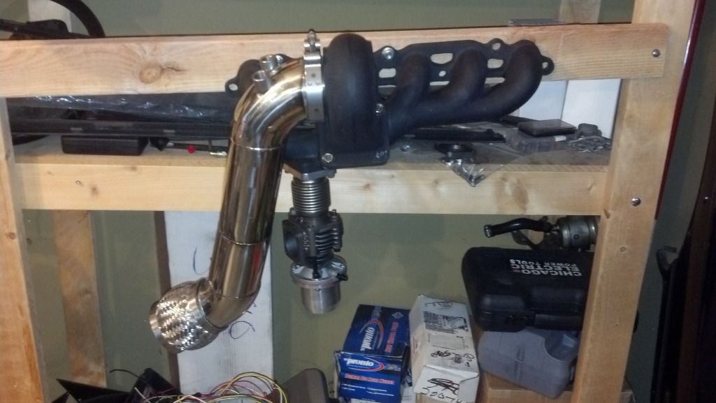

Still working on the DP/ wastegate plumbing. Went to Lowe's today and picked up some lag screws for the manifold.
"Why on earth would you need lag screws?" Well, to make my jig, of course.
I just needed to temporarily bolt a 2x4 to my shelving, so that I could mock up the mani/dp/wastegate. Not enough room in the engine compartment for trial and error fitment.
This is the area I'm working on joining together at the moment:
I hacked up a screamer pipe, but I have the wrong angle to it. I think I'll need to buy a 2" diameter 90degree tube.

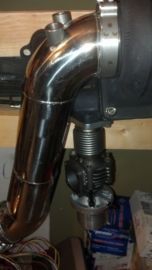

I have about 2" between the pipe and the wastegate.
That means that I'll be cutting a 90 degree elbow to make a sharp turn.

Agreed, but space is an issue.
I am trying my best, though, to give the merge as much downward angle as possible.
PS- I've been trying to re-use the screamer pipe's stainless flange, but it's twice as thick as the one that came with the wastegate.
So I'll be switching to the narrower one so that I have more room to lengthen the merge and thus reduce the angle to something more efficient.

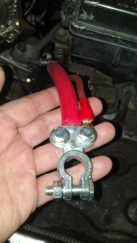

I received my 4 gauge battery cables today, so I mounted them up. I'm waiting on some 10mm i.d. silicone hose, so that I can 'sleeve' the positive cable, for added abrasion insurance.
I will say that it was nice to hear the 'key-in' warning chime when I tested the connections to the battery. First sign of life in the poor car in months.

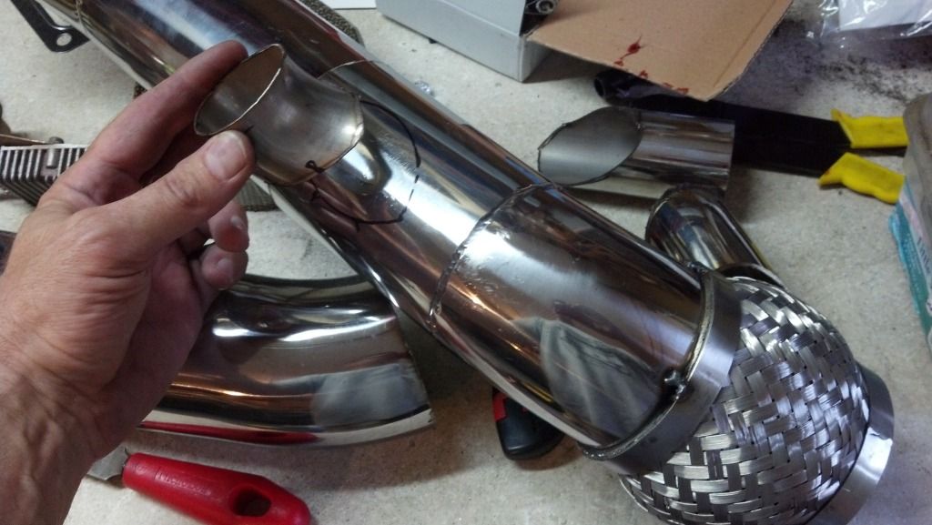

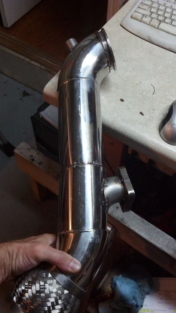

Got just a teeny bit of progress done recently, but nothing major.
Got the tubing in that I needed, so I worked on the wastegate merge. Took alot of cutting, grinding, tack-welding, tack-weld removing and realignment, rotating, and just fiddling in general. I was glad to find that I could make use of the stainless wastegate outlet flange, instead of having to use the thinner mild steel unit.
Now, it's ready to reinstall in the car, to make sure it fits properly. If so, then I can finish welding it all, heat wrap it, and do the final install of the manifold and turbo/ dp.
Also, received the 10mm i.d. silicone tubing, so that I could cover the positive power cable. I really just wanted it for peace of mind; I have nightmares about the cable's pvc cover getting frayed on some random edge of sharp metal, and just screwing up everything.
If you look closely, you can see the two seperate layers.
PS- 10mm id silicone tubing is exactly the right size for 4 gauge wire.

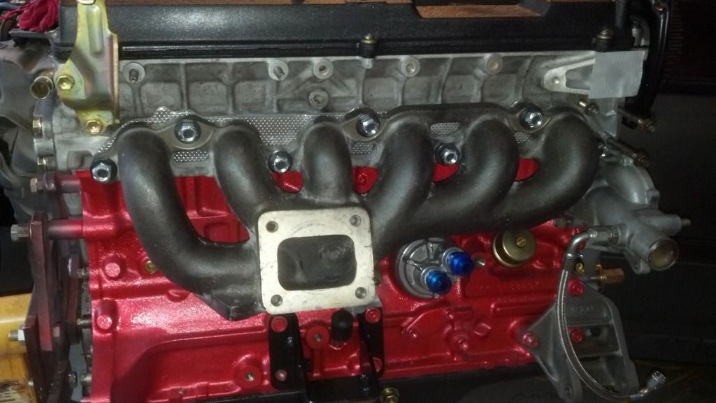

supraguy@aol;1913752 said:

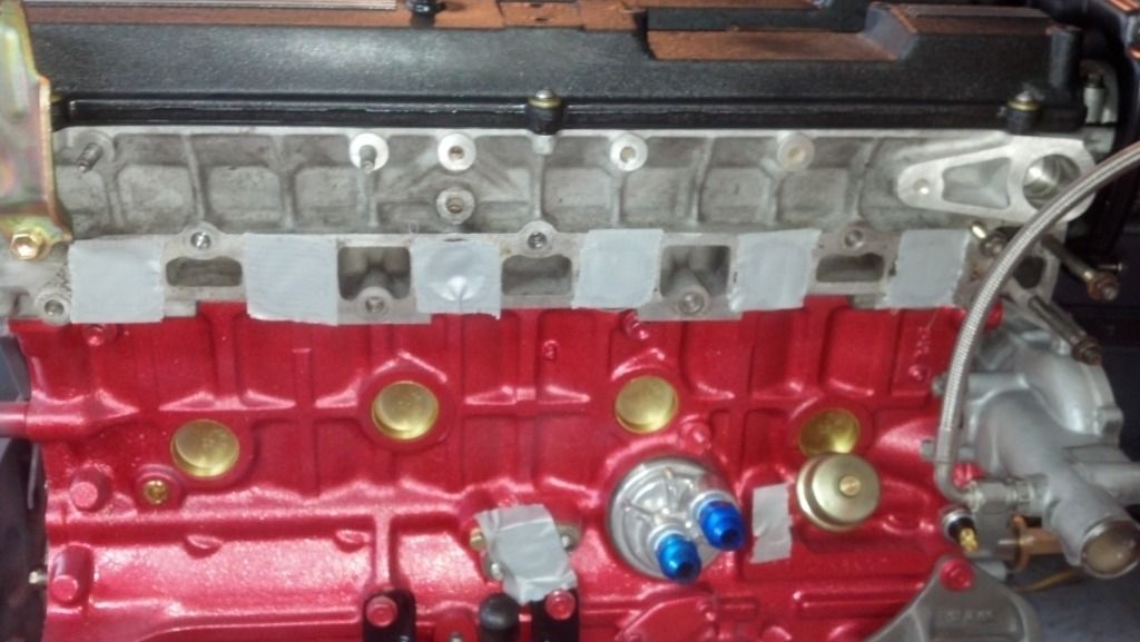

Helicoiled the head up to 7/16" today.
taped up all the openings. LOTS of aluminum shavings to deal with.
Test fit of the manifold.
I had to port it quite a bit to match it up to the gasket(ports weren't even round).
Happy with the results
why helicoil the exhaust threads? what advantage does it give you?
hvyman
Dang Dude! No Way Man.
Apr 17, 2007
12,568
Fullerton,CA
The head is usually weak around that area over time and more times than not the threads will strip. Best to heli coil while its out and easy then find out later on after everything is in and bolted on.

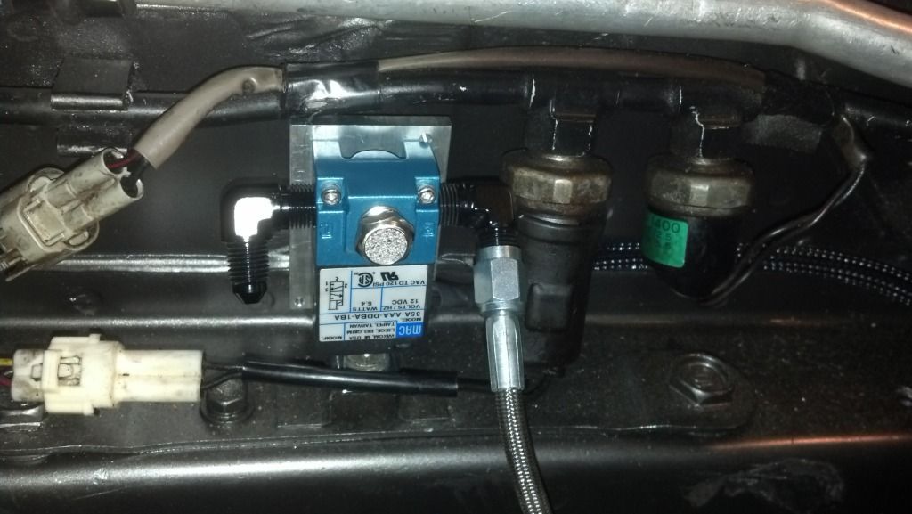

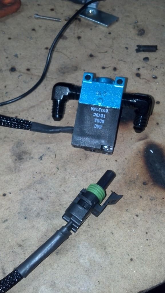

Did a little welding on the dp, but found that i have to replace the wastegate port. The wall thickness needs to be larger.
So, i just mounted my boost solenoid.
