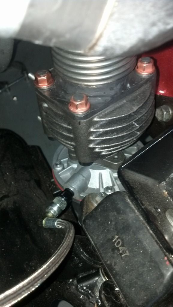

1986.5supra_kid;1958755 said:
how long are the bolts that go into the wastegate flange? just curious if they will fit with your down pipe.
Theres enough clearance to get bolts in there, but I'm planning on using studs.

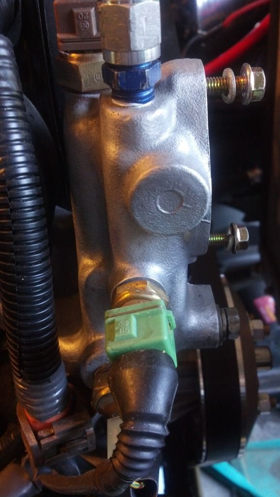

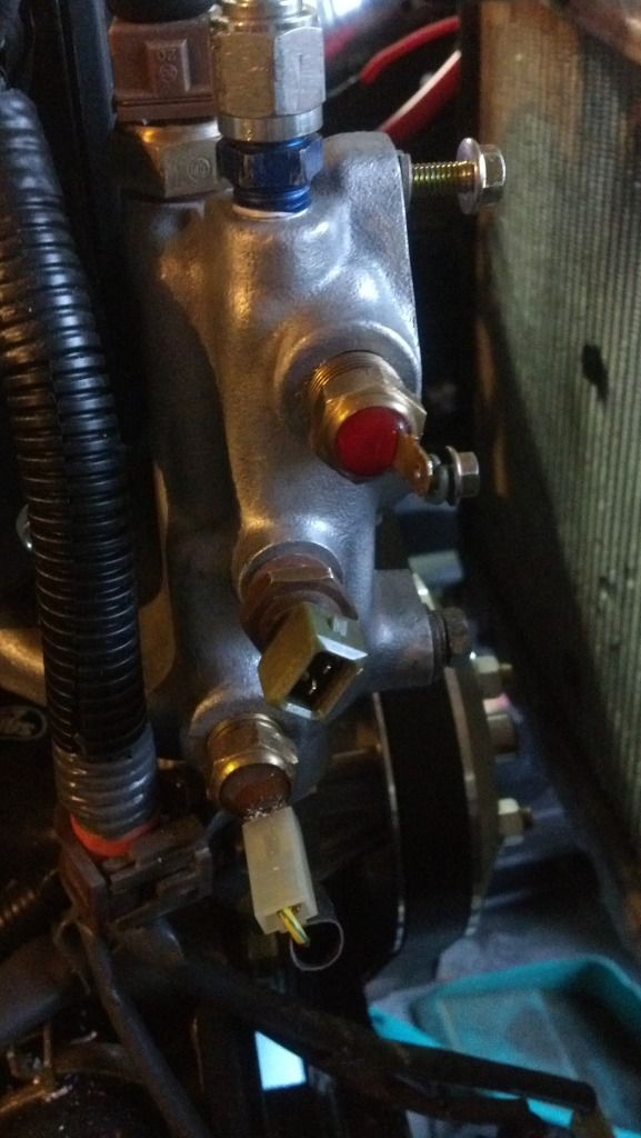

Just did a little drilling yesterday, on the water elbow. Added another temp sensor for a warning light.

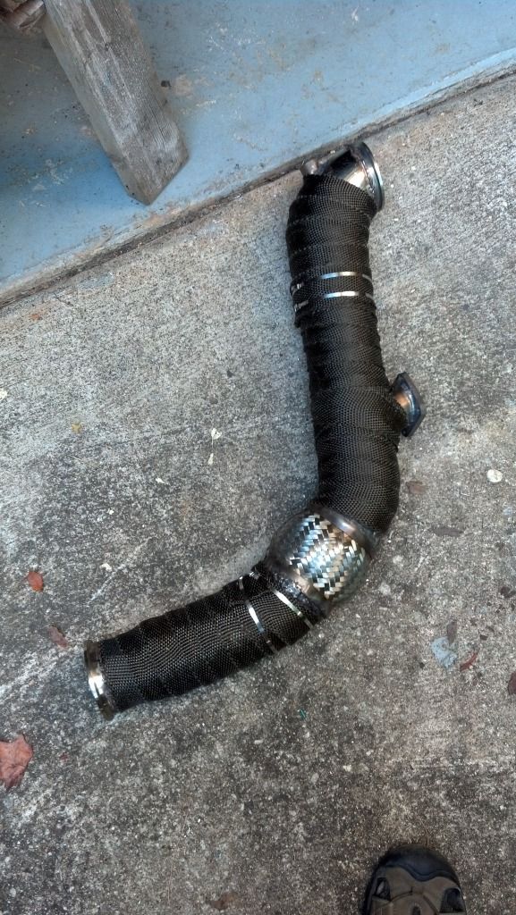

On another note, I FINALLY got the Dp completed, and wrapped.

Been debating heat wrapping my DP. Not sure how much heat the SP6265 will add seeing as I won't be rally driving or anything fun like that. Huge difference in engine bay temp by wrapping the DP?
supraguy@aol
Well-Known Member
Dec 30, 2005
4,239
Atlanta
Well, it's suppose to make a big difference, and I don't think it matters if you race or just drive.
Alot of heat comes off the manifold and exhaust, especially if it's stainless tubing vs cast iron. My mani is iron so I didn't wrap it.

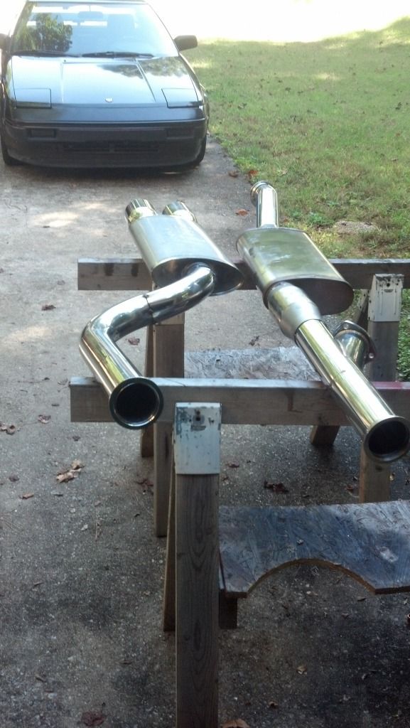

So, I'm sorry for lately not having the same fast & furious pace that I maintained during the engine assembly, but I'm starting to see some light at the end of the "drivetrain tunnel". Stage 2 is nearing its end. Once the exhaust is completed and the fuel pump rewire/Aeromotive install is done, I get to move on to body work.
I have switched bodywork and interior around because it just makes more sense: If I did all the interior work/ reassembly, I'd have to remove part of it again for painting.
Some of the different stages will of course, overlap; I have to pause on MAFT pro and ecu wiring since I have to take out the dash, and I will remove some interior items to better access some of the bodywork. But it'll all flow logically, I hope. Anyway, I started tacking some more of the exhaust together-

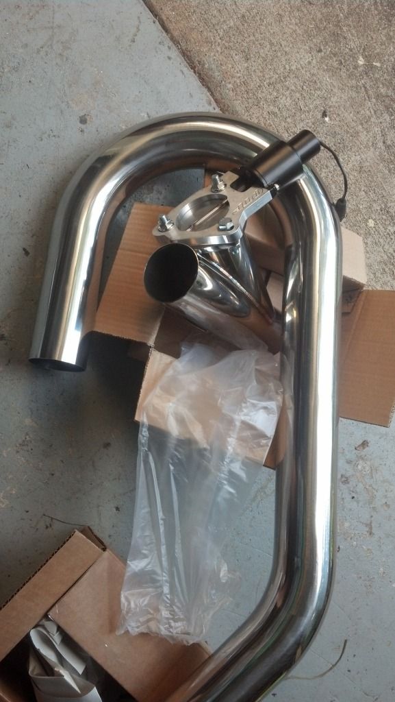

V-band flange>3"section>3" QTP cutout>catalytic converter(yes, I'm a treehugger)>Magnaflow muffler. I didn't take a pic of it yet, but maybe tomorrow.

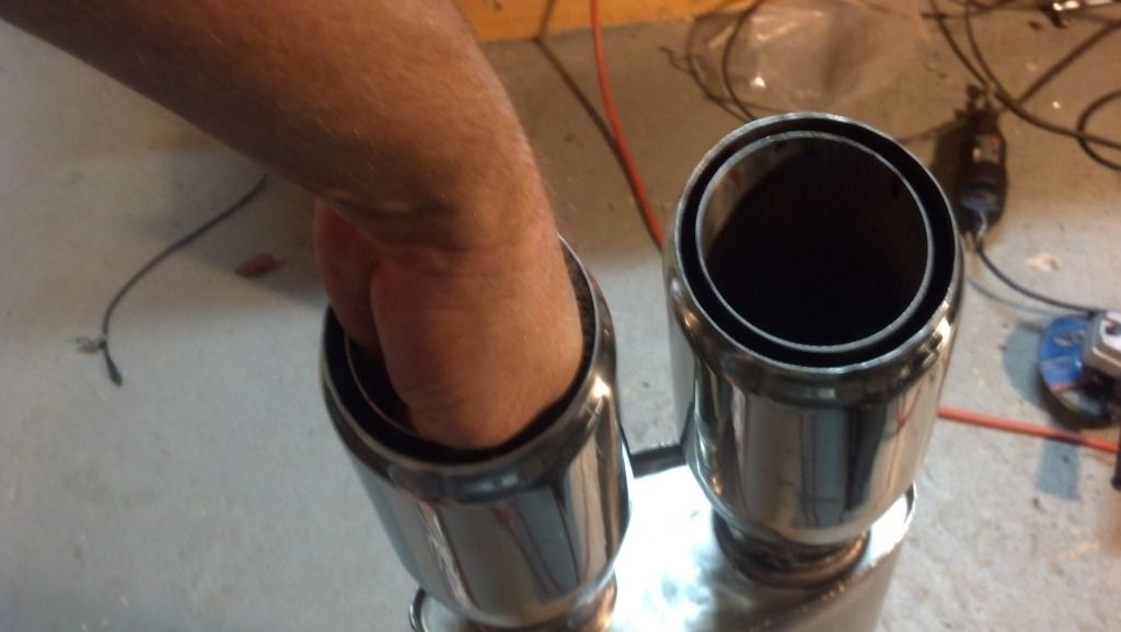

The electric cutout sits up nicely out of the way, just behind the transmission mount. In fact, the whole exhaust sits up almost as high as I'd hoped. I don't think I'll scrape anything, unless I screw the coilovers way down low, which I'm not likely to do. Next will be another 3" v-band, then a quick upper S-turn towards the rear Borla muffler. Also, I tacked the two obnoxiously-large softball cannons onto the Borla. The center Magnaflow muffler is so damn big, that I'm going to have to 'massage' some of the rear tunnel out of its way.
QTP cutout and 3" 316 tubing:
My big exit:
Don't seem that big?
Here's one of my XL man-hands for scale:
So anyway, I'll be dropping the exhaust off at a fabrication shop for tig welding; I had originally planned to mig weld in stainless, but my skills are just too sub-par compared to the tig'ing that these guys do.

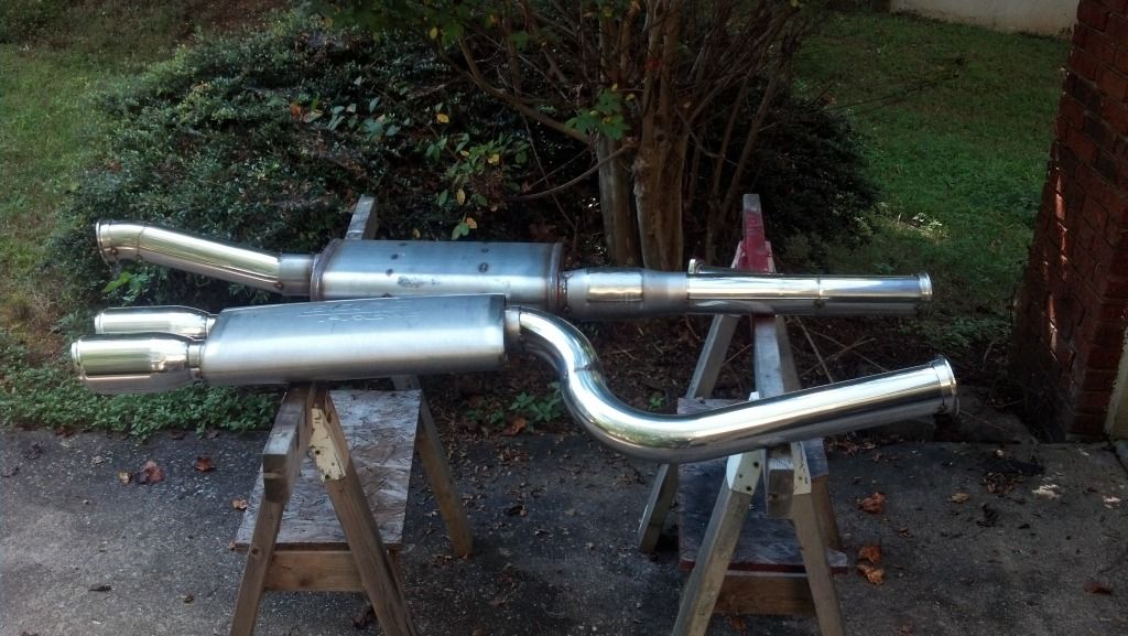

So, I finally got the time and motivation today, to tack up the rest of the exhaust.
Went pretty smoothly, just took awhile to cut and test all the pieces.
Once I was done, I threw the two sections in the truck and drove them down to the fabricators, to TIG up.
Then I installed the copper locknuts onto the wastegate...

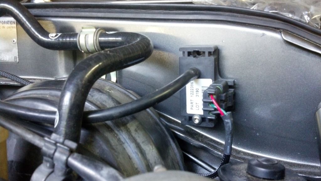

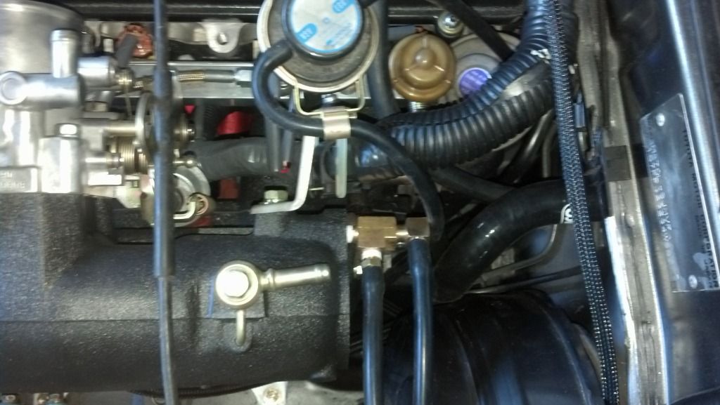

Then I removed my(unused) theft deterrent horn, and used that space to mount my MAP sensor...
