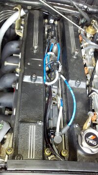

Today, I picked up a new coil pack harness, and cut it all up, and made it into an IS300 harness.

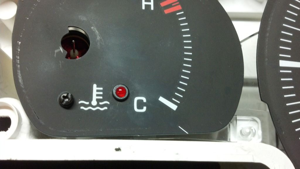

I finally finished fiddling around with my instrument cluster, and got the coolant overtemp light installed:

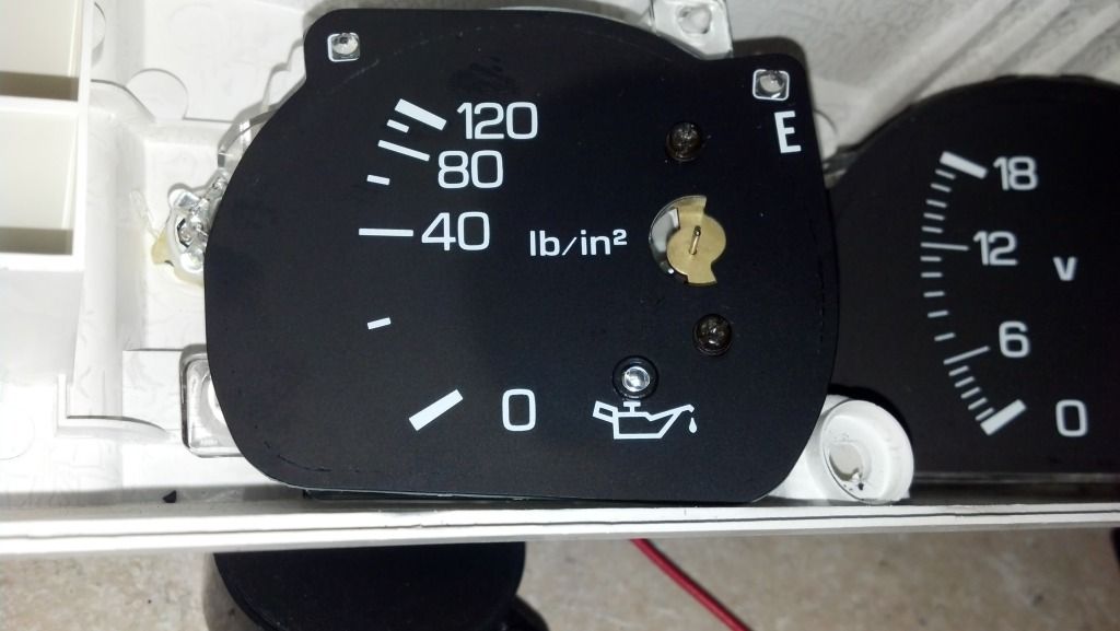

This thing simply flashes if I exceed 220 degrees at the thermostat housing. If you'll recall, i put one in for my oil pressure as well:
Lol. You can tell I drive a 7M, when I have to constantly worry about low oil pressure and high coolant temps.

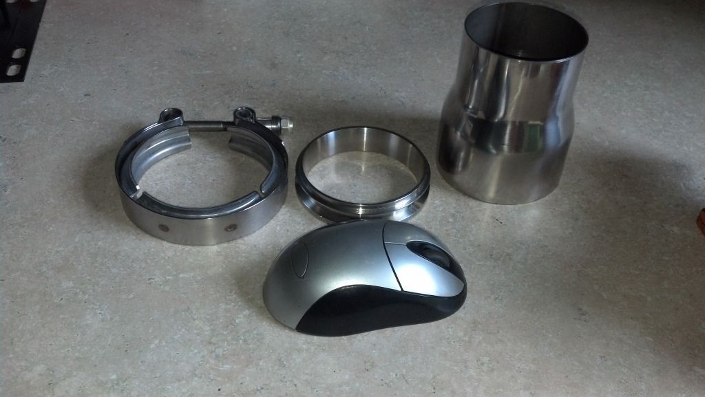

Oh- and here's the exhaust parts I got today- a Precision 3 5/8" flange/ Vband, and a 3.5-3" reducer.
