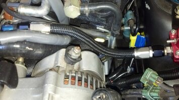

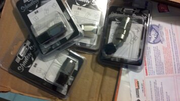

Gave me some an fittings, so I can finish my fuel lines.

Ok, Trooper is back up, and I also received my second T4 spacer, so I welded the two together.

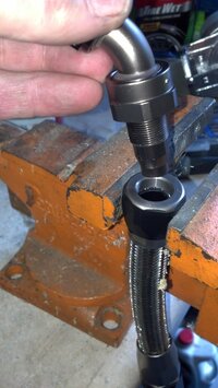

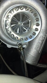

Then I received my wastegate, and test-fitted that to the manifold. Got as far as making one fuel line. Still have to finish the other two.

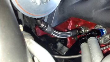

More hose work, Made the return line out of the regulator.

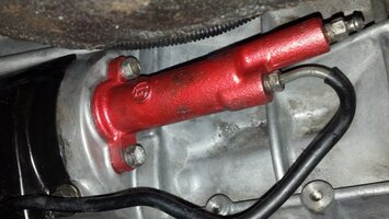

Also installed and bled the clutch slave.

So ont the downside, I found out about 30 minutes after I bled my clutch slave, that it decided to continue to 'bleed' itself; completely dry, onto the garage floor.
So I ordered a rebuild kit for it, as the bore looks and feels perfect. I think the piston seals are just shrunken a bit.

Got my T4 gaskets, and final an6 fuel line fitting in today, and so now all of the engine compartment fuel lines are completed and connected.

My 87 engine swap was done smoothly until yesterday when the slave did the same thing... Leaked everywhere. New clutch/pressure plate installed with new pilot/release bearing. All together with new salve and can't get it to go into gear... Lol

Oh, I also reinstalled the rebuilt slave cylinder. yay.

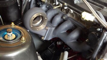

Yeah, there's a flange for the wastegate on the mani, and i'm just using a generic hks-style wastegate with a 10lb spring.
Only a few of the exhaust parts are Vibrant. But it is all stainless, and will be from turbo to tip, including the brackets.

I'm sure I missed it, but what exhaust mani is that? It doesn't look stock, and it's definitely not a Treadstone (HKS knockoff) manifold... maybe Cartech? Shoot I'd love a cast mani with a center-set turbo location instead of my turbo sitting next to the firewall... haha

Actually, it is a Treadstone, or at least a copy of Treadstone.
Got it off a Russian on Craigslist for $120. The turbo flange is centered just behind #4 runner, so it does sit back a bit, about 1" more than I'd like.

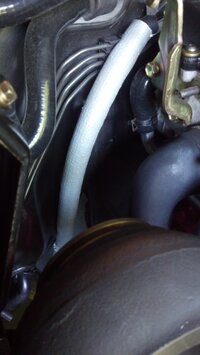

And because it does sit a bit back, I just put firesleeve over my new speedo cable.

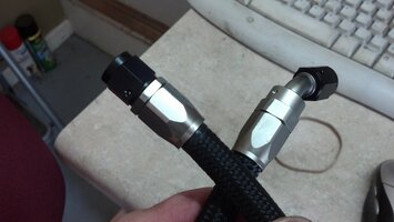

Then I finished up the feed and drain lines:
-10 drain, -4 feed, -10 remote cooler lines.
-3 wastegate line:

okay sweet we have the same manifold then haha. let me know how the downpipe fits in there when you get it done, that's my biggest concern back there
