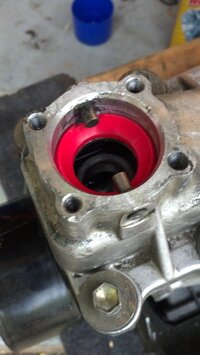

But looking inside, you can see that it's a larger diameter than stock. I also realigned the new steering rack, so that the inner mechanism is centered, rather than compensating with the outer tie rods.

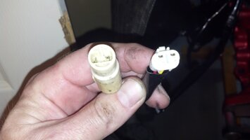

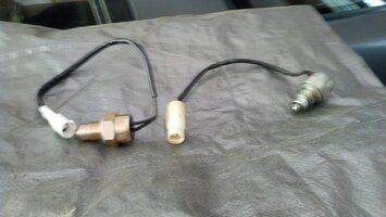

There are two different back up switches for the Supra. Not sure if it divides by year, or by transmission, because I saw listings for both switches for the various years and trannys. Here's a pic of my backup lamp switch plug on the left, and my engine harness connector on the right. I'm thinking the previous owner of my transmission had spliced the different switch plug onto the engine harness. Oh well, I'm not going to do that with my new harness, so I ordered the proper switch.

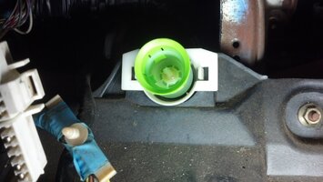

-6 braided black fuel line, a Marlin Crawler shifter kit, and the new reverse light switch that I needed.
New switch on left, ond old one on the right:

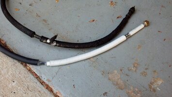

Just got my new speedo cable...
I noticed that the end is slightly different than the original, as you can see. It doesn't look like it'll fit into the lower bracket like it should. I may have to add a bracket.

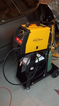

Welp, it looks like it won't suffice, at least not for every job.
I tried welding onto some thick steel under my MR2, and it just wouldn't penetrate.
I'm not surprised, because it was only a 70amp welder. So I bought a bigger one:

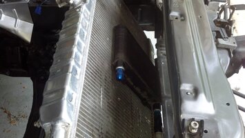

Also, finally chose a location for the oil cooler- right between the ac condenser and the rad:
It's just a big 2inch wide void in there, so the cooler fits pretty nice, and is out of sight.

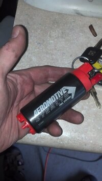

Got the Aeromotive today, teeny.
That is all.

I was talking with Grimjack at the supra meet in Centralia, WA last weekend about his oil cooler location. Seems he had his oil cooler in a similar spot and it ended up making the radiator not work as well as it should have been so he mounted it horizontally just under and behind the radiator on the driver's side with a small plate to direct some airflow up through the oil cooler. Not sure of his current HP but it's got to be 500+ I would think with the mods on the car.

Hmm.
I dunno... Ive got it right up flush to the rad, and im using stock shroud and fan, so the air should be effectively pulled through it. I didnt center it to the fan, either. I offset it so that it wouldnt be in the 'dead zone' at the center point of the fan's rotation.
Perhaps the gap between the condenser and the oil cooler would allow the air to stagnate at the front of the cooler, and try to go around to other parts of the rad where there's less resistance? Maybe i will have to create partitions to seal that path... I dunno.

My guess is, you'll just have to find out when you get this beast up and running and start having a little fun with her. If she starts over heating a little or maybe even more than a little you might look into alternative locations for the oil cooler. Food for thought and I wouldn't even have had that thought without talking with Grimjack and looking at his set up the other day at the meet.
