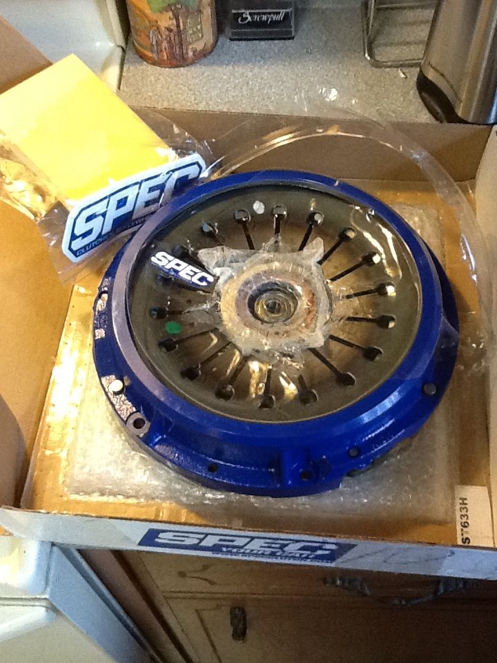

If your going with the Spec 2+ clutch, so far I am loving mine. Good hold, although there is a tiny bit of shudder in first gear (probably because I am using stock flywheel...)

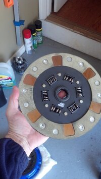

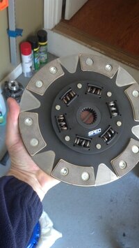

As a matter of fact...
Just showed up today.
Didn't realize that the disc was a 6-puck on the reverse side.
Now I can degrease the tranny, replace input and output seals, and slap it all back together.
I screwed up and ordered a release bearing from DM when I ordered replacement cone washer setup for the hub.
Now I have an extra release bearing.
Ooo very nice. Definitely keep us up to date on how it works. I've been seeing and selling lots of Spec clutches lately, and really considering the super twin package.
Theyre supposed to include the bearings though, so that's in there too right?

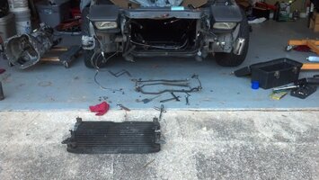

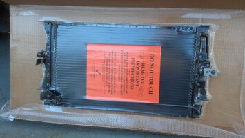

I was still so full of motivation and glee, that I decided to tackle the new box that arrived, rather than stack it in the back of the garage with the rest:

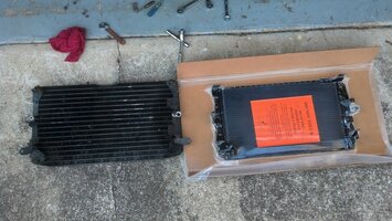

New condenser core.

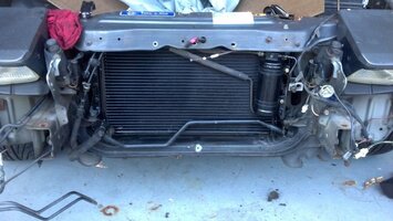

I don't really know if my original core was leaking, but somewhere there was a leak, and after taking this one out, it looked suspiciously oily in a few corners. So, I'm glad I did it. First things first, lets clear a path:
Here they are, side by side:
It's not quite plug&play; there are a few things that have to be transferred over; the 4 mount isolators, and a roll pin for the connection point on the right side. Aside from that though, and a bit of tweaking on the mounting points, all I had to do was put it in place, install a new drier, and reconnect the three refrigerant pipes with new seals. Looks pretty good now.
Another thing to note- is that the new condenser's flow pipes in the core are tiny compared to the original. There are however,
twice as many of them. Hopefully, this will translate to more efficient cooling. I guess we'll see.

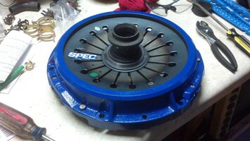

Ooh- forgot;
I also installed my clutch hub onto the Spec, with the new bearing and cone washers.
