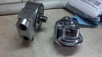

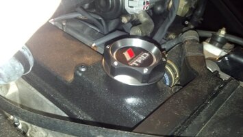

Well, I'm finally back "from the dead".
I have returned to the U.S., and was greeted by a number of small packages at my door:
Earl's oil billet thermostat, TRD oil cap, M6 gold anodized titanium bolts, 10 gauge fuel pump wire.

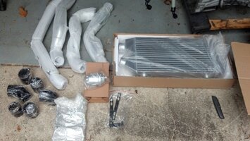

Tomorrow, I have to drive down to UPS and pick up my DM intercooler kit.
I have a week off from work, and intend to put some motor in some Supra...

Did I send you the step by step for that intercooler?
(Mine had no instructions or even suggestions for a proper install)
Lay the 3000 pipe replacement in place and let me know how it fits

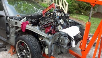

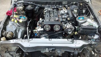

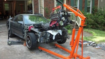

Engine.....IN.
I TOLD you all I'd put some sweet, sweet hurtin' on this car this week.
I ain't wasting time.
LOL.

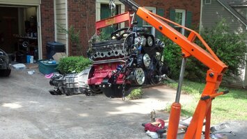

All went pretty smooth, but I realized that the hoist wasn't lifting high enough to let me get the motor off the stand, so I disconnected the hoist so I could pull the piston to add fluid....BUT...I forgot that I had pulled the pin out of the stand that prevents rotation...
HOLY SHEEEEIIITTT!!!!!
As soon as I pulled the hoist away, the entire motor spun 180 degrees upside down!
I don't know how the thing didn't completely topple over from the weight shift, but I thank the big man for that.
Anyway, speedo cable and driveshaft are hooked up. Now I gotta buy the turbo so I can start mocking up the DM intercooler kit,
as well as the exhaust.

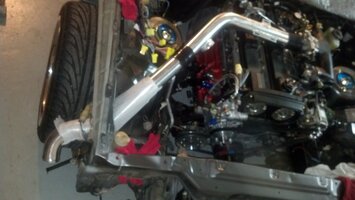

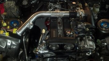

Grandavi- heare's a few pics of the upper pipes.
I noticed that on the Ebay listing for this type of IC kit, there are two pics of the engine bay, and both are different cars, different kits!
One retains the oem plastic "thru-tube" that runs through the fender wall, and the other(like mine) has the pipe going all the way through, eliminating that part.
The scary thing is, that its a bit of twisting and maneuvering to get it through. Once I have the radiator in and the fender on, I don't know how easy it would be to install this pipe.

I didn't use those two pipes... had to cut my fender wall and couldn't cut it enough..
Looks like the bracked on the side of the 3000 pipe replacement is off by an inch or so like mine was as well.. so the vacuum hardline wont bolt up properly. I had a HKS 3000 pipe (which is actually bigger diameter than the IC piping) that I utilized and just put a custom pipe on the car from the 3000 pipe to the fender wall. There was no way that I was going to make It fit as-is. (Could have if I had a way to bend the pipe a bit...)
Sadly.. I didn't realize that there was no way to get it to fit properly until after I cut the inner fender hole. Had to stop because I was going to have to cut into the frame to get it to work.
Here's some pics of mine...
my HKS BOV is turned 90 degrees to recirculate. The recirc hose is about 1/4" that way and it sits about 1/4" too high (hits the fire blanket on the inside of the hood). When I go stand alone it will be turned 90 deg back so it looks proper. Its not great having the bov flange directly above the recirulation point.
You've been doing such great work so far, it sucks that the IC is so poorly designed with those 2 pipes. No idea how DM can say they are plug and play because they are so far off what they should be... and it would be so simple to fix that design. The shop I had install it charged me more than the intercooler cost for the install plus 100.00 on top for the custom pipe and flange. (and the HKS BOV recirc kit which did NOT come with the IC kit... ) Every kit install I have seen that maintained that 3000 pipe replacement doesn't have the vacuum hard pipe bolted.. its just flopping on the top of the engine. I thought mine was a one-off mistake.. but apparently its bad design from day one.
I like the intercooler now.. but it was a pain in the ass until we decided to throw away the two upper pipes.
