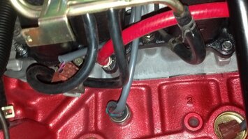

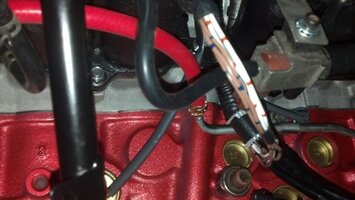

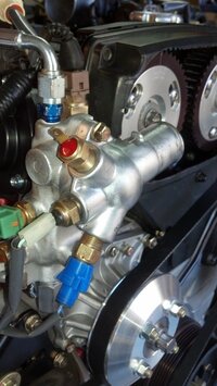

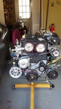

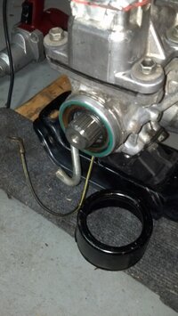

Today, I connected up a bit more of the new harness, installed the accessory belts, Took apart and cleaned/ re-oiled the A/C compressor,installed the egr and fuel
vsv's(I got the proper diameter silicone vac line today). Then I replaced the tranny's input and output shaft seals. All that's left is to mate the two together on the new clutch and flywheel.
On to the car porn...
Vsv's
The orange tape is one of about 4 spots I need a harness clip for
God, I love a new engine harness...
Belts on.

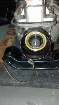

New output shaft seal

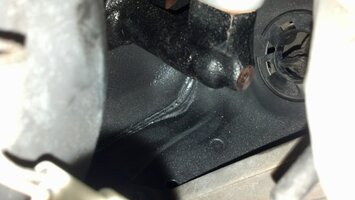

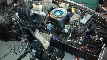

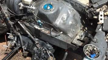

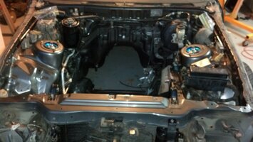

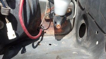

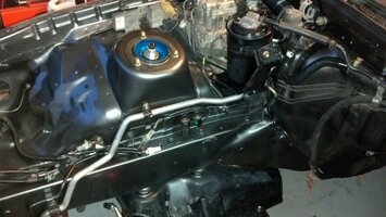

Today, I decided to push the nose of the Supra out of the garage, so that I could "clean" the engine compartment.
There were a couple of surface rust spots that I wanted to address as well, but I decided not to get too crazy.
It didn't work.
Out came the cruise control, the fuse box, injector resistor box, fuel pump relay box, and a few nuts and bolts, here and there.
But then I said, why not take out the ac lines, the clutch master, charcoal cannister, and headlights?
THEN i said, why not take out the alarm horn, the heater valve, winshield washer motor, wiper arms, pop out the fresh air vents, lower winshield cowl,
and hood struts....
ANYWAY. I'm just glad I could figure out where it all went back to.
Before.
After:
The paint I used is slightly darker than Toyota 167. Why?
1. I like it better
2. Toyota 167 is impossible to find at an auto parts store, thus leading even more strongly to reason #1.
It's a Honda color. Slightly darker, more metallic content...Might have to paint the car this color...
