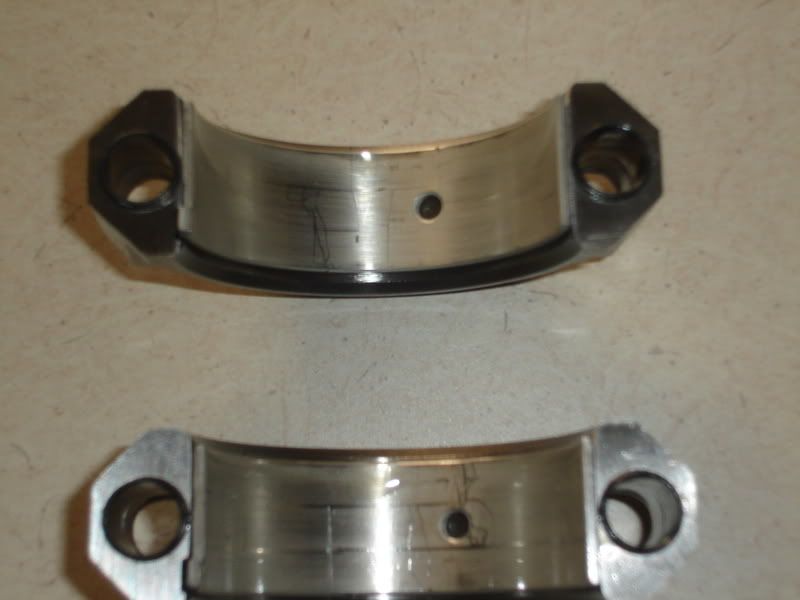

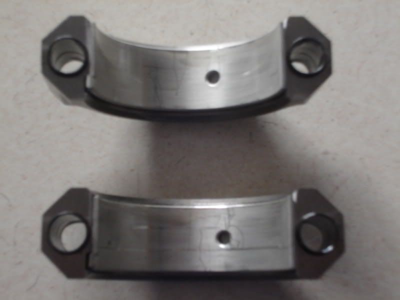

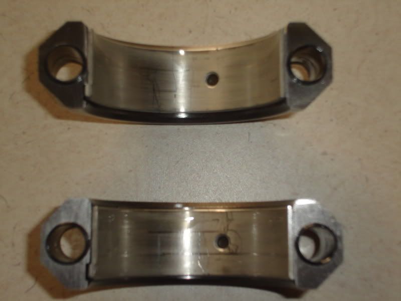

Sooooo needless to say that freaking sucks. HOWEVER... on a sidenote...we pulled the rod caps off and checked the bearings of the forged engine...and the bearings look FINE. So we are pretty damn sure now that the "knock" WAS infact a bad case of piston slap because of the large piston to bore clearance.

Here are pics of #1 and 6 rod caps. So as you can see definitely NOT rod knock.
