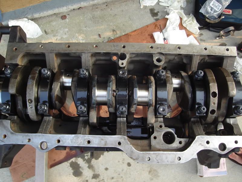

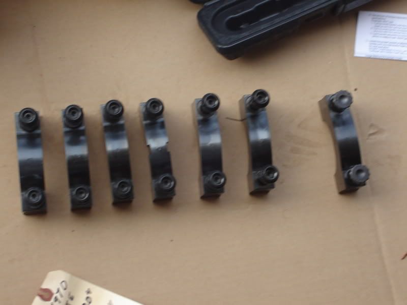

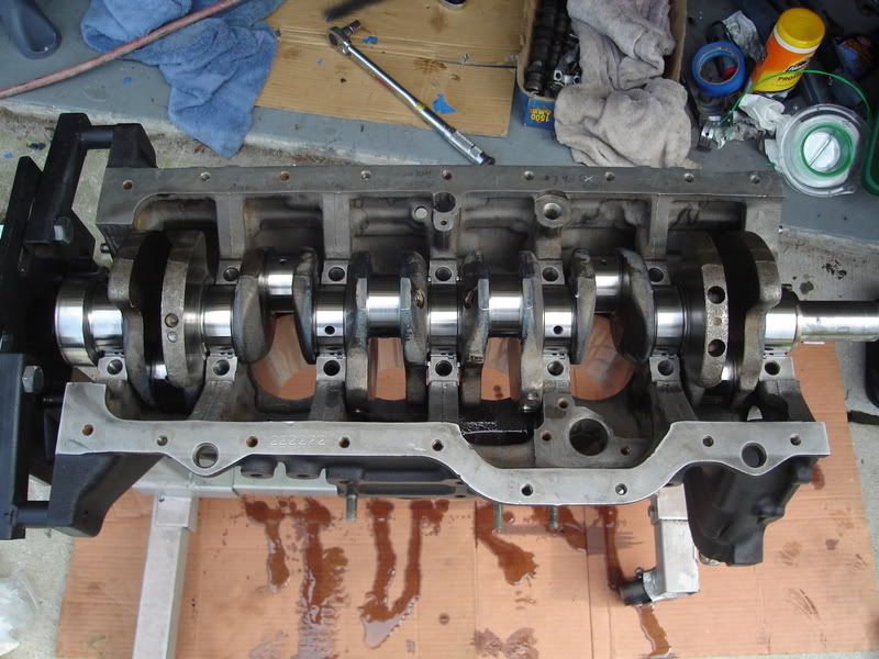

Crank Meet Block
New Main Caps:
Main Caps meet Crank No Noises this time!

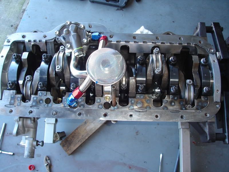

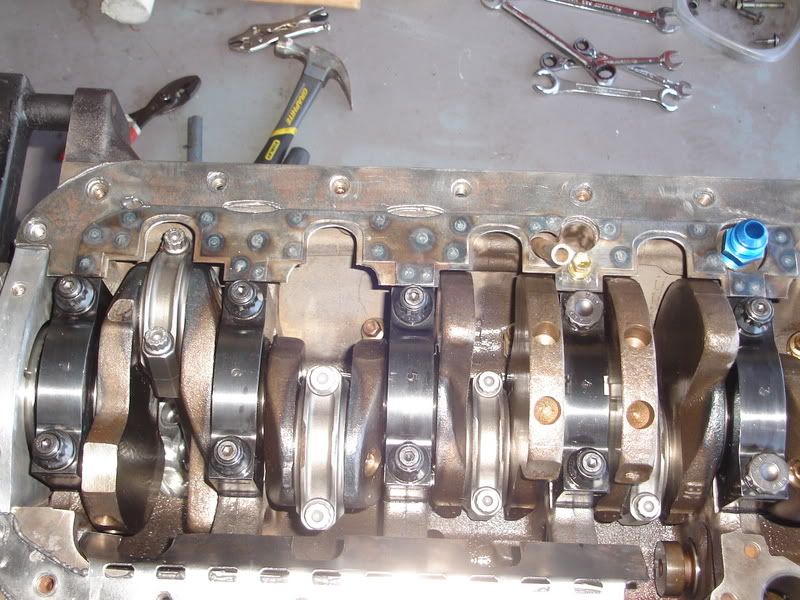

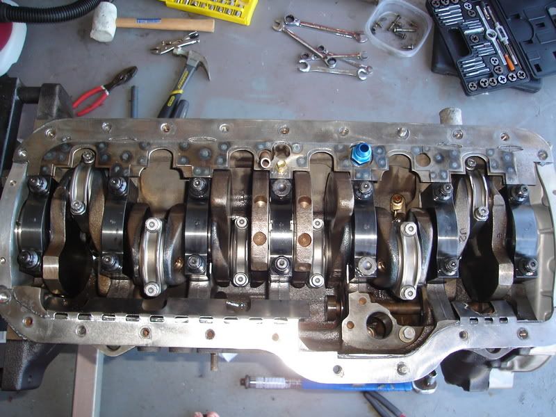

Crank Scraper test Fitting
New Modded Oil Pump and SS line

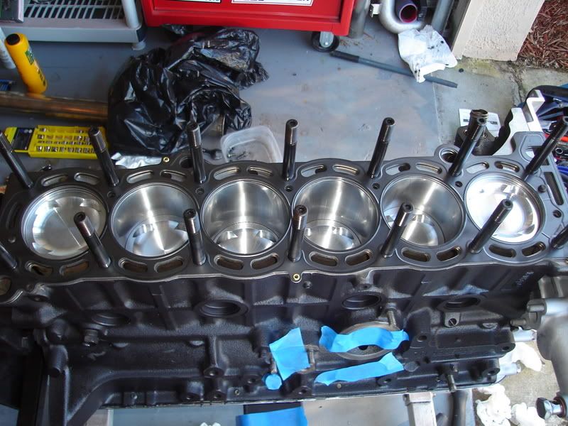

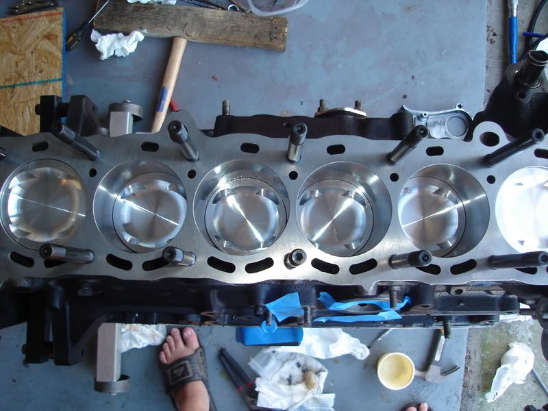

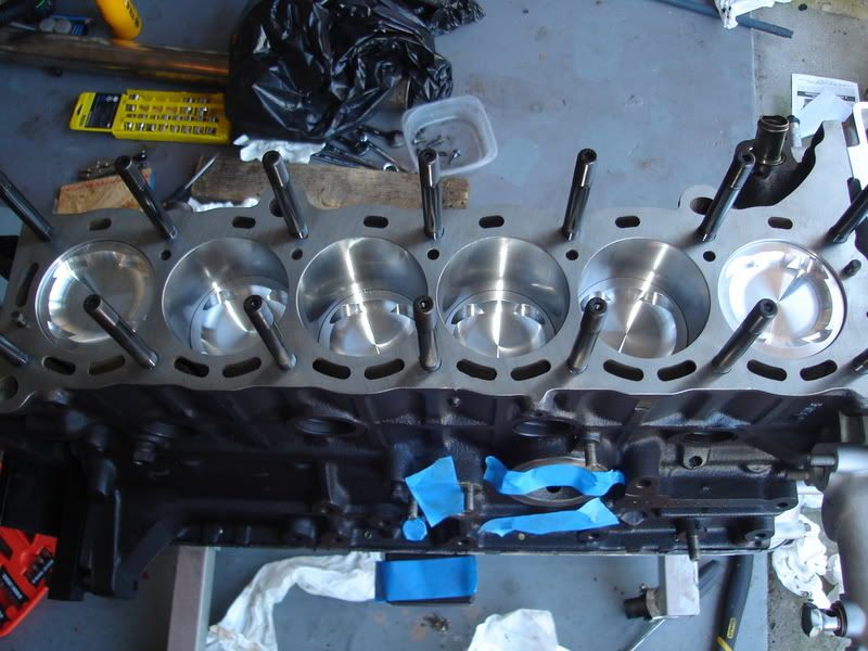

ARP Head Studs
Titan MHG
We also got the Head on but havent taken the pics yet.

How did you go about sealing your oil pan to the block with the scraper in place and that extra space at the front and back where the aluminum covers are?
