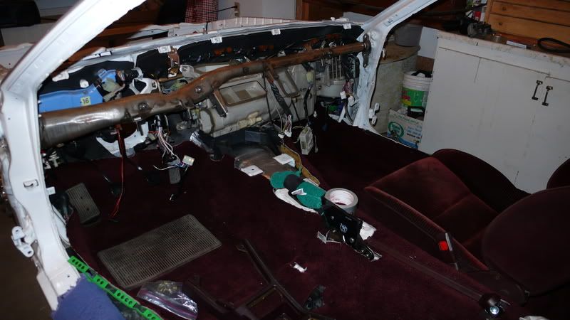

I've made a bit more progress on the interior - sure it may not look like much, but once I get a throttle cable and install the steering column, in goes the dash.

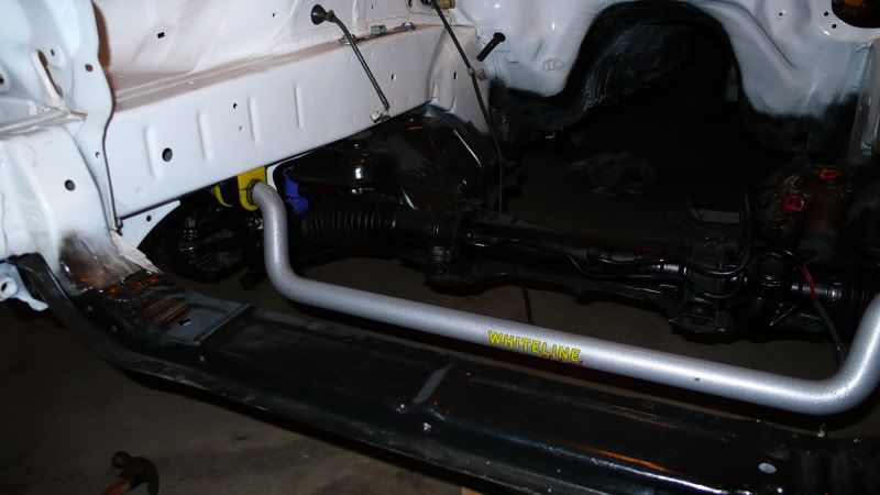

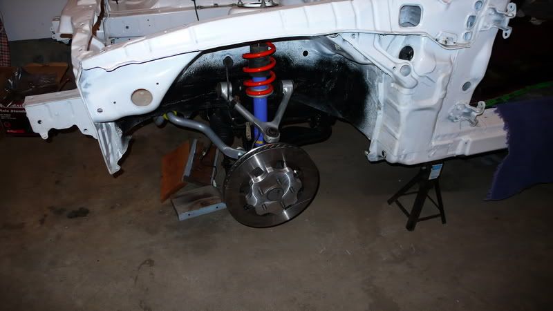

Here is the front suspension, permanently installed. Refinished subframe and hubs, rebuilt ps rack, new lower control arms, new upper control bushings, new ball joints, new tie rod ends, whiteline sway bar
The brakes (minus the caliper of course) from Andy at ARZ. Freakin sweet. Front shocks are A'PEXi (6 way hight, 7 way dampening) with tanabe springs

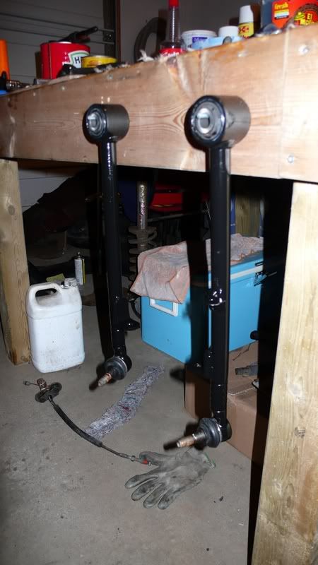

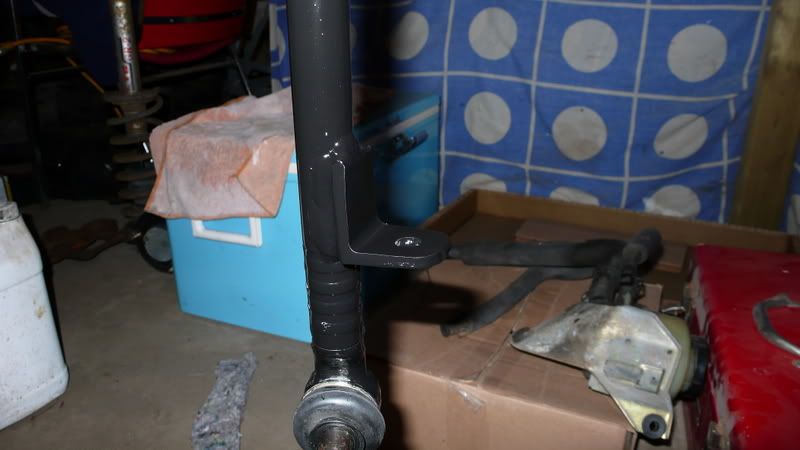

I wanted to show these off because a little bit of work went into them - rear control arms with new bushings, and new sway bar tabs welded on - note the thickness in the second pic....I don't think they'll be bending or breaking off.

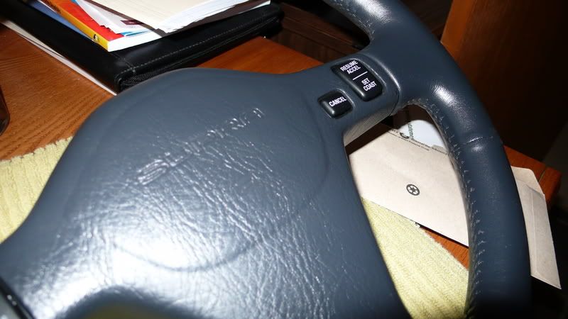

Re-finished steering wheel with new cruse control buttons - It looks brand new....fibrenew (www.fibrenew.com) does excellent work - they also did my e-brake lever.

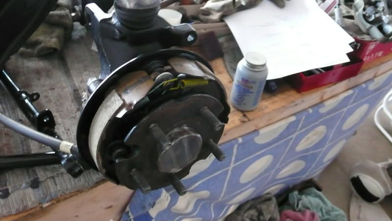

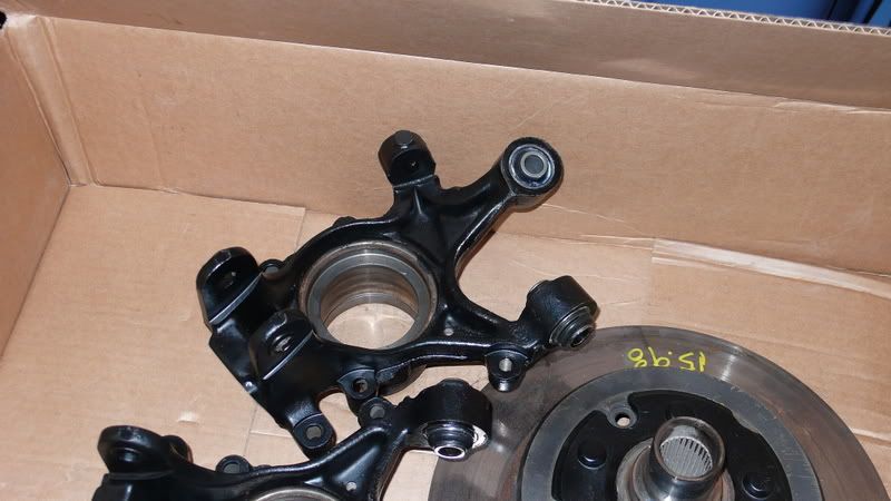

And finally, the end result of my after-work work in the machine shop at work (along with the bushing install and welding of the rear control arms), the rear hubs - completely refinished with new bushings installed. New wheel bearings will be going in after the long weekend.
Nice! How much did that run you if you don't mind me asking? I was looking to get my wheel recovered as well...and they've got a franchise here in DFW...
for the wheel, horn pad, and the e-brake lever it was $140. Durability is supposed to be equivalent to brand new, so that is a small price to pay for "new" leather.

Everything looks awesome. That steering wheel is black correct? It kinda looks navy blue. Did you get the new buttons from Toyota? How much? What exactly did they do to the horn pad? Cover it?

Yeah, that picture is deceiving - up close, the wheel is black. I did get new buttons from toyota, I think they were about 140 together. As far as I know, the horn pad was finished with the same coating as the steering wheel.

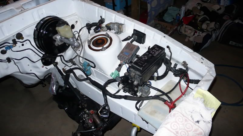

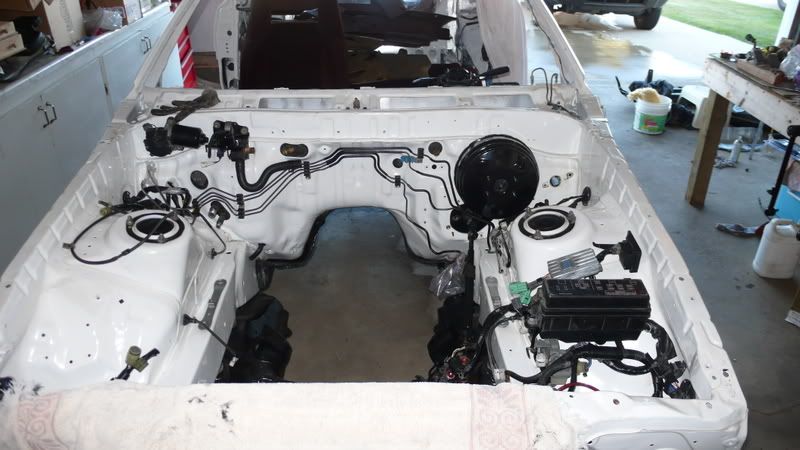

Update...installed a few things into the engine bay - cleaning things such as the wiring harness and all the parts is such a pain in the ass....and they never come out quite clean enough (take the fuse box for example...) - oh well, shit happens.

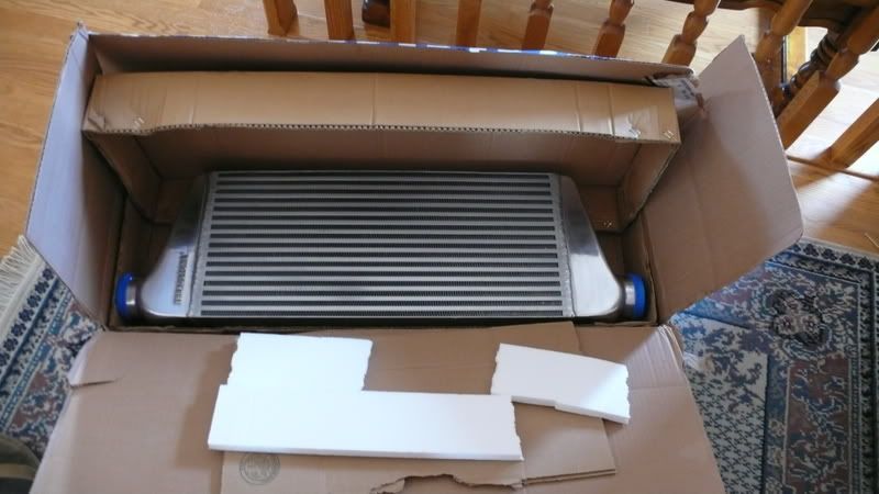

10.5 x 24 x 3.5....with well designed endtanks (from treadstone performance)

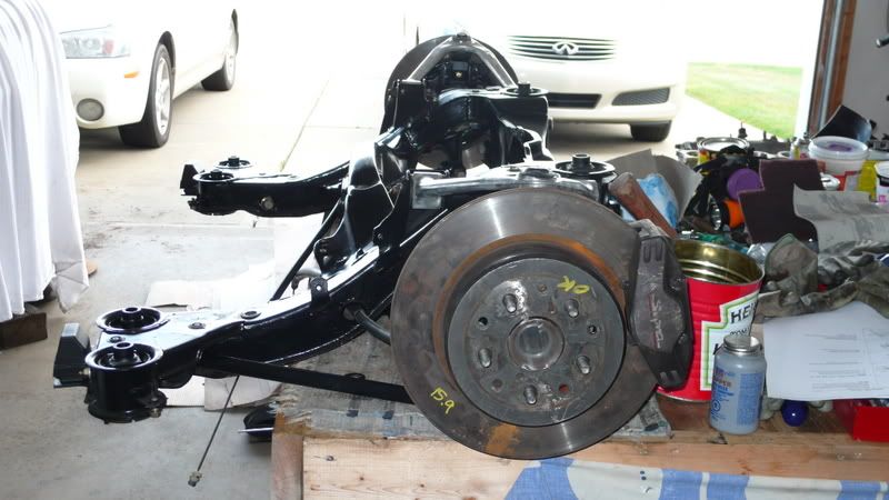

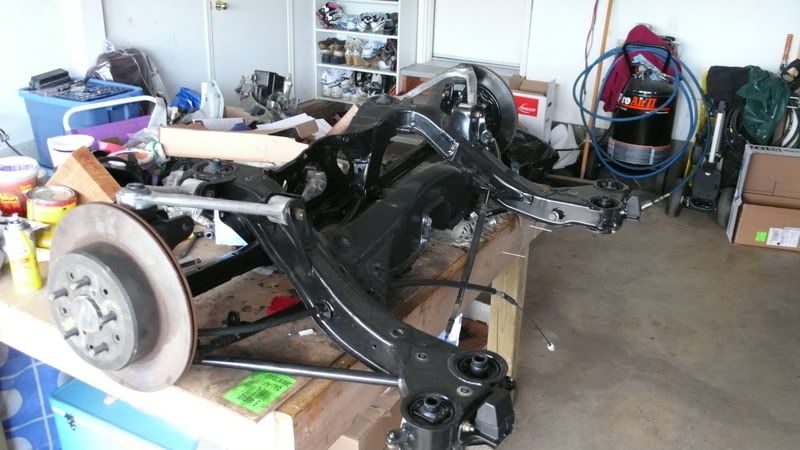

Here is the rear subframe - minus the differential which should be back to me early next week...please don't judge me on the cleanliness of my work table.....
MK4 rear brakes mocked up - still need to fab a rotor bracket and mounting hardware.

MKIII-DRIFTKING said:
What is that on the fuse box that didn't want to come out?
just some random dirt i think...I'm searching for a fuse box cover that is in better shape, so it doesn't really matter.
