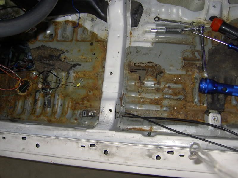

got any more pics of the floor which you had work done to? im very, very intrigued. This car is amazing, you saved a car, even though you killed one before :biglaugh: good work man!

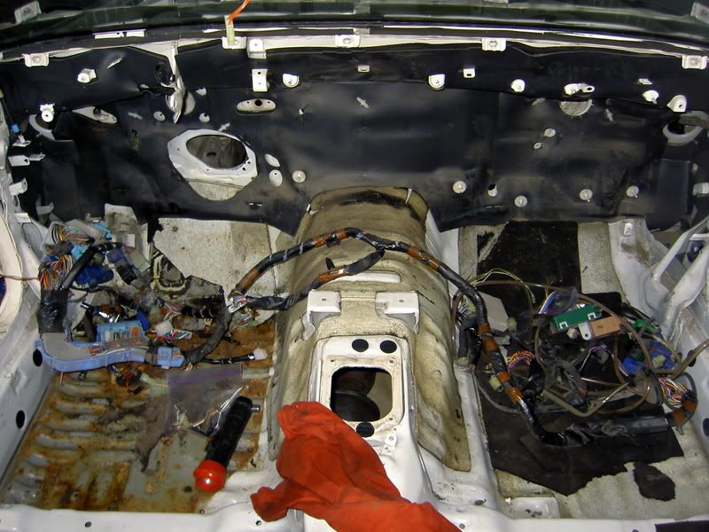

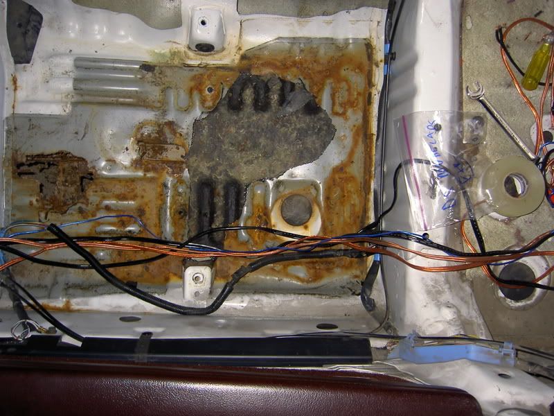

here are a couple of the ones that I could find.

by the way, there wasn't that large of a hole in the floor when I tore the car apart - there was a little hole surrounded in rust. In anger, I started chipping away all of the loose rust I could see with a screwdriver until it was gone. This was almost the point where I decided to say F-it and find a new shell, but nevertheless, I stuck with this one.
