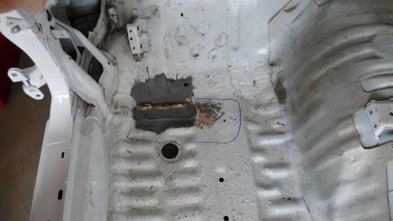

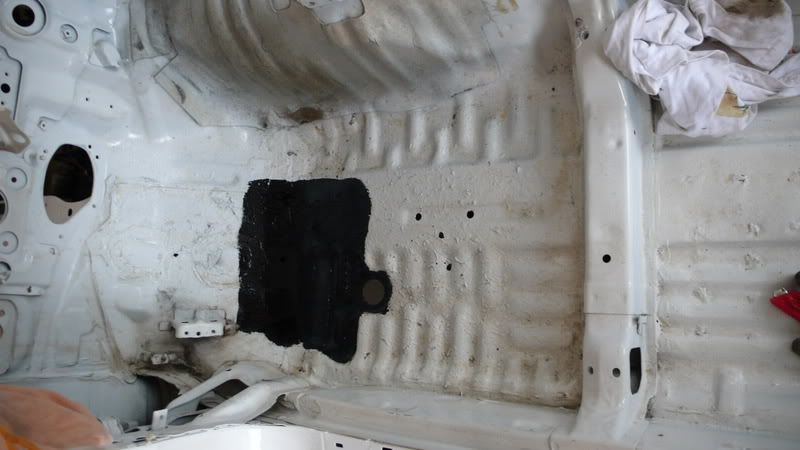

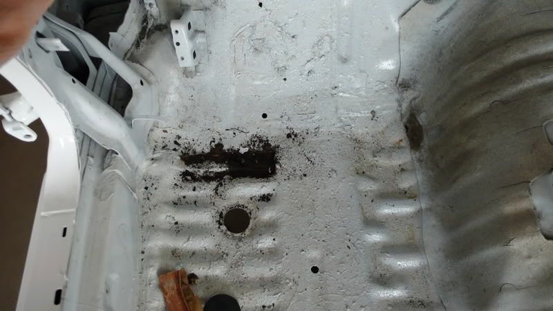

had a close call today...started poking around the spray-in sound deadening and found a poorly adhered area....upon further scraping....shit. rust.
so, it had to be sandblasted
and sealed
tough to make progress when you have to clean shit like this up.

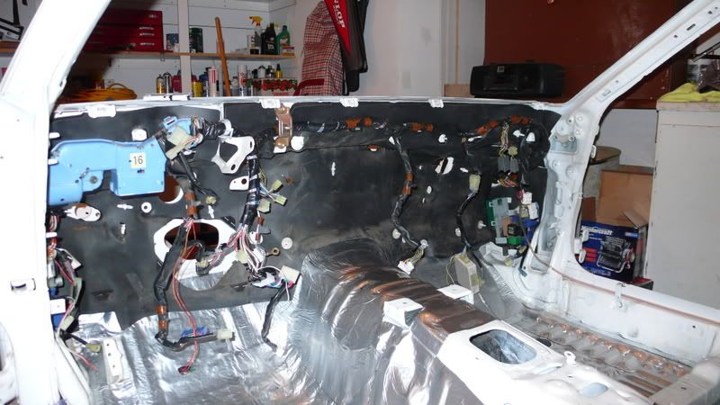

update:

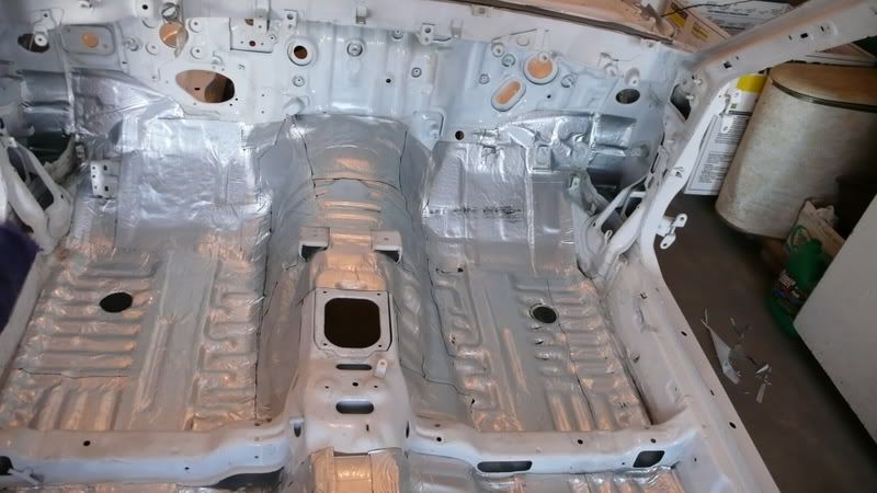

sound deadening complete in the cabin - nearly finished in the hatch area. I've finally started to put some stuff back into the car - Thank god for taking lots of pictures when disassembling...

I went with elemental designs edead V1^2 - its a butyl base, 45 mil thick. I did a double layer on the floor and I am doing a triple layer in the hatch area. The stuff is fantastic to work with too.

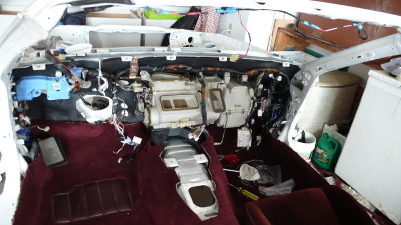

hvac system (a bitch to clean) and replacement carpet install (it made cleaning the hvac system look like a walk in the park)

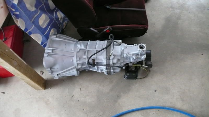

re-built transmission

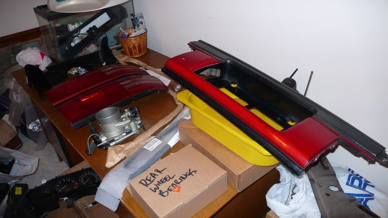

the mail man keeps bringing me all these parts....guess i'll have to put them on the car
