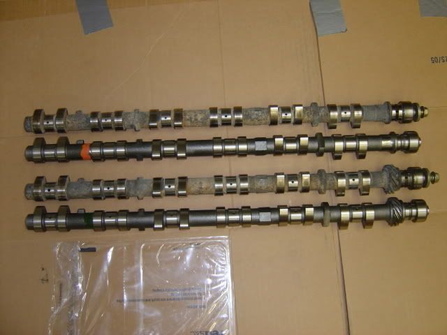

ok here is some pics for all of you patient followers. First off to please Vic is the cams. Just a teaser pic as I was too lazy to unpack them totally.:biglaugh: I didnt take a pic of the box like everyone else cause everyones knows what they look like now.

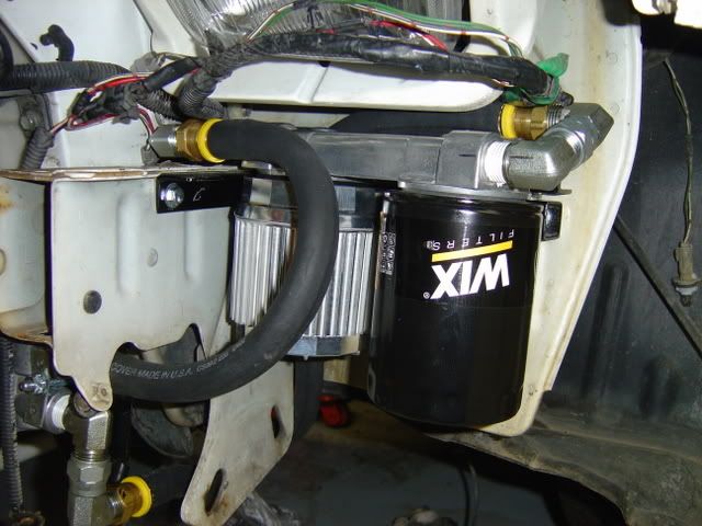

Heres some brackets I made for the thermostat and cooler
These are for the dual filter remote
The cooler installed
Some other installed pics

Nice progress Allen you have made.:naughty: , What size cams did you get 264s ,or the 272s? Fab work is slow and endless but the final results are rewarding.

Thanks John. I got the 264's. I didnt have the guts to get the 272.:naughty: Besides that im not going to be set up for standalone or anything like that in the near future. I dont have the funds or the knowledge for that at the moment. I just want to get this thing on the road at this point.:biglaugh:

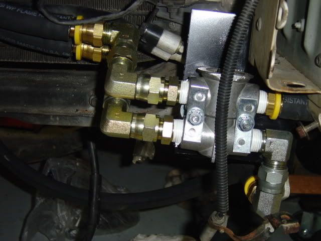

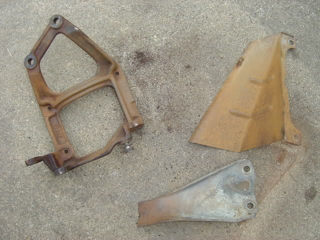

The bottom part is some kinda support for the downpipe. If I remember correctly this was a worm gear type strap wrapping around the downpipe with the downpipe pulled against that piece. I think it attaches to the tranny supports coming off the block. Or it might be to the tranny itself. The filter adaptor I bought as a used oil cooler setup. You can get them about anywhere. Just make sure its 3/4 16 thread which is the same as our filters.

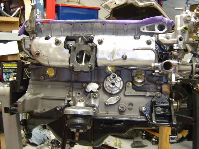

I installed my valve buckets in but havent checked clearances yet. Im kinda bummed cause my clearances (checked with plastiguage) are the maximum, which are .0051 Im actually thinking about using the stock cams as this build is not going like I want. I was hoping to build this motor with tighter clearances than im getting. I have to decide before I check bucket clearances.

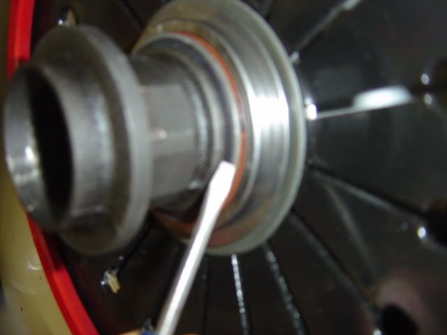

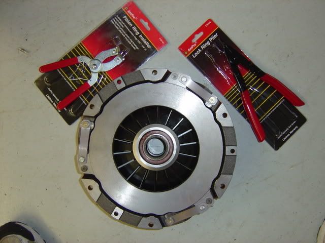

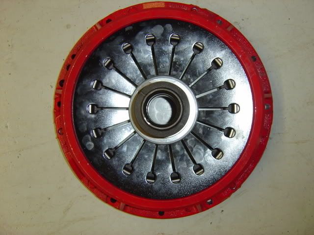

well I worked on the Pressure plate today. Pissed me off!! I spent probably an hour or more trying to get my brand new washers and snap rings, mainly the rings back together. Grrrr. After I got fed up trying to install with the tools I had, I went to Advance and purchased the correct spreader for the job and had them on in 5 minutes. Also I hope I installed the thrust cone spring correctly. As best as I could tell with it installed you can push down on the throwout bearing and it gives, and then bounces back when pressure is released. Can anyone verify this for me?? I hope this is right as I dont want to fool with this again.

I think im right as I checked my JZ PP that I have and it looks like how I put mine together. I will post a pic anyway, as I always like a second opinion. Im not sure you will be able to see the thrust cone spring installed as my camera doesnt take good close ups. How did you know yours was backward VIC? And what exactly was backwards?

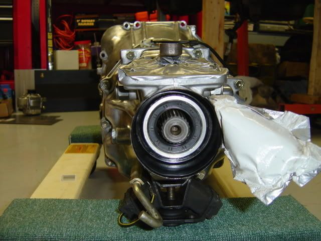

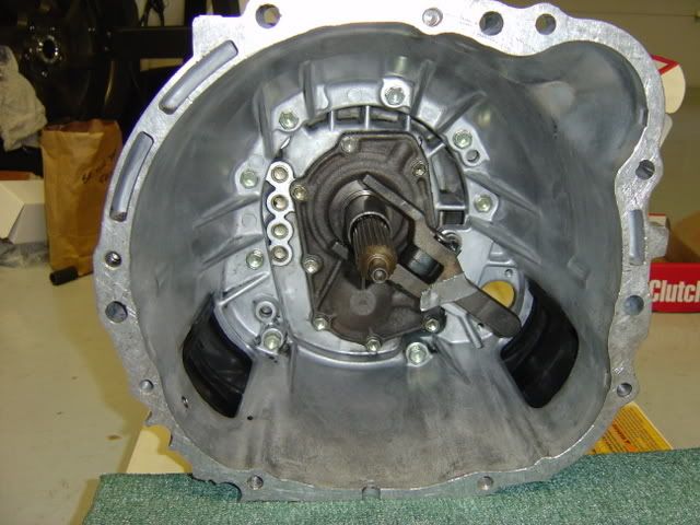

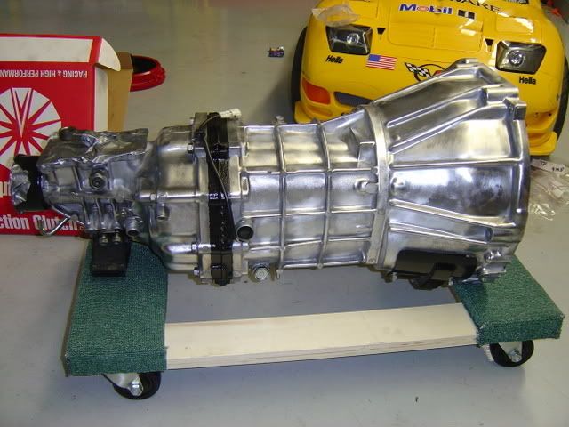

new oil seal installed in the rear. I think I would have been ok with the original as it was still soft but I changed it anyway. Also some Misc of the tranny

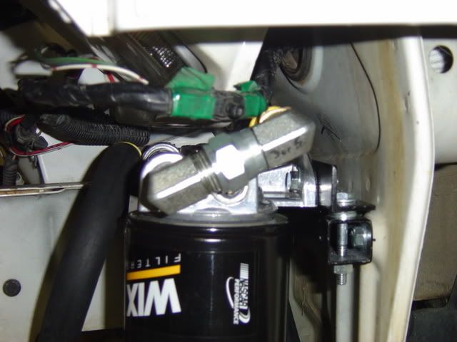

ok heres some finals pics of the oil cooler install Ive been working on FOREVER! I think its finally done. Im praying for 0 leaks
And then finally I worked on the PP as stated before. Heres some pics with the tool I had to purchase to get the snap rings on. I tried to capture a pic of the thrust cone spring for Victim but I dont think you can tell much
And then last is a pic I snapped of the BC cams vs the stockers. for the heck of it

you know Im glad you mentioned that as I dont remember if mine even had some on them. What kinda foam did you go back with. My trick to get the tranny clean was the same as everything else i cleaned. The old wire brush on the drill trick. It made that tranny look polished. Really did a good job. Of course had to go through the headache and elbow grease of degreasing first.
