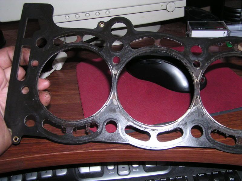

well i just pulled my head of my motor today, and i will not be re-using this titan head gasket, it's burned on the block side, and alot of the viton has come off. just does not look good at all, there are no warp's or any thing in the gasket, just discoloring where the metal has gotten hot from compresison passin it.

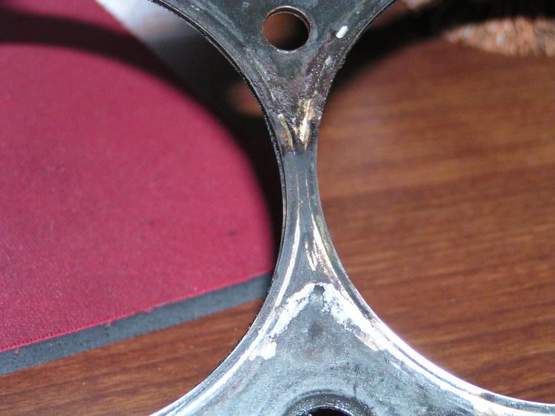

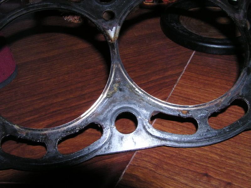

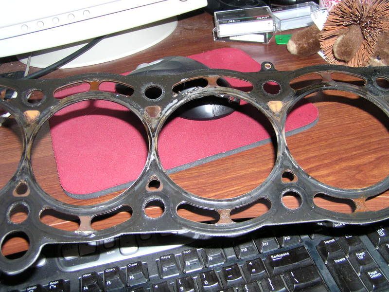

alright you asked for it, you got it..
those three, are the side that contacts the head.. the head had a finish of 25ra put on it.
my instuctor says, the sliver area's are the spots that had good seal, and where the viton just happened to stick to the head.
now the black area's that seemed abit brunt or discolored, is where the compression was passin through..
of course this was on the block side where i had attempt to hand lap the block by myself with a chnk of 4x4 and hi grit sand paper, obviously this method does not work.. if you are going to hand lap, then a lapping stone and lappin compound is the way to do it,
i guess i did it this way do to lack of understanding what people meant. and what other's have experience, this hg lasted me about 1 month before i started having cooling issues, and my cylinder's are not washed or steamed liek a typlical bhg.
