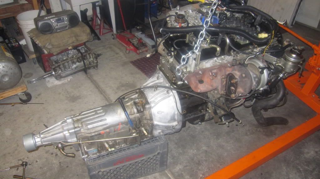

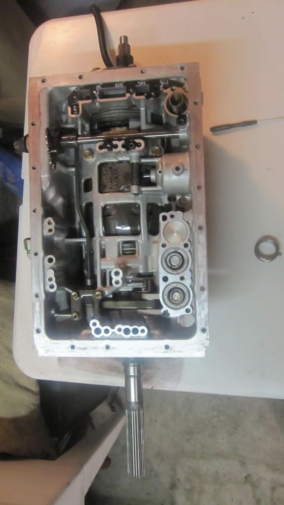

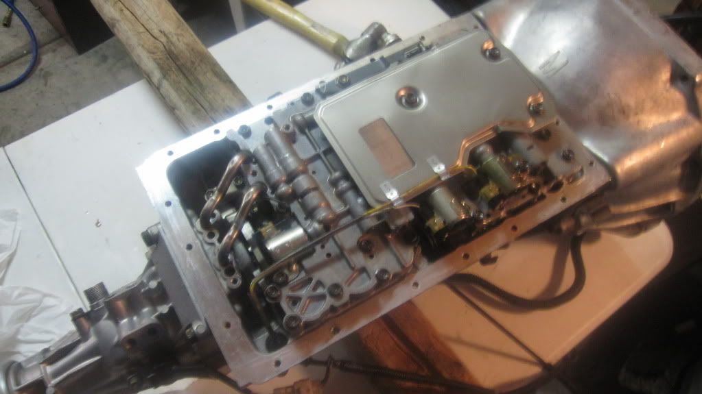

Today Update, Didn't do much.. Got the tracking from Import Performance Trans for the valve body gaskets and they are going to be here Monday.. So That gives me plenty of time to get my other shit together that im working on right now, get more organized so when the time comes I can just throw it all In and be done in a day!

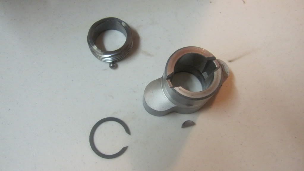

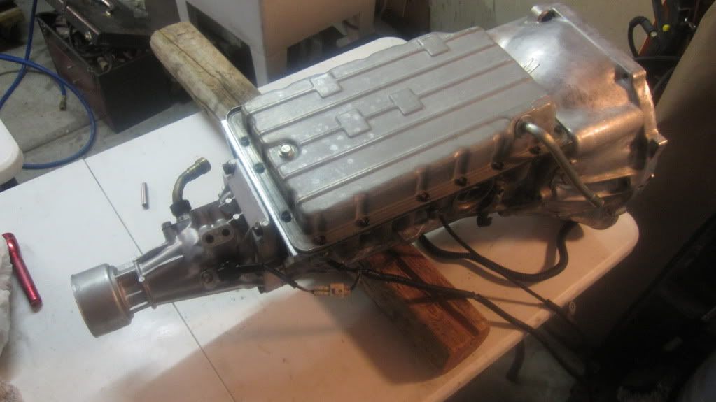

Got the speedometer driven gear and sensor rotor off the old trans that I need to swap over to the new transmission because it was an ABS trans.
My old transmission stripped down pretty much bare

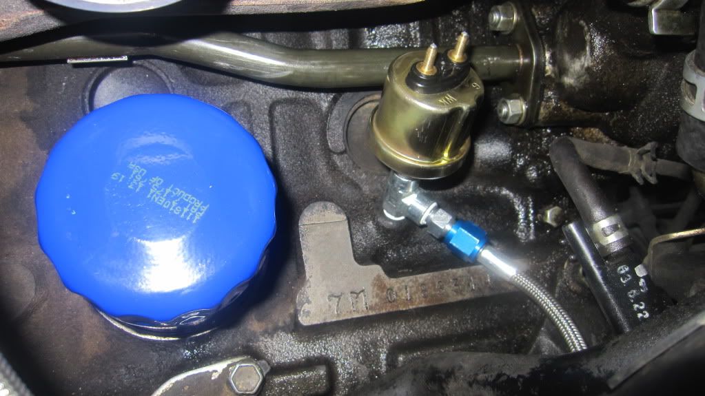

Today I just redid my oil pressure sending unit and turbo feed with a new OPS as my other one was reading funky some times. Anyways got it all in and sealed up with permatex High temp thread sealant.

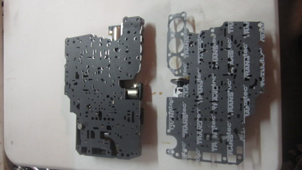

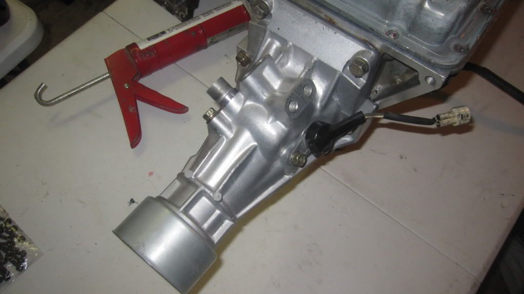

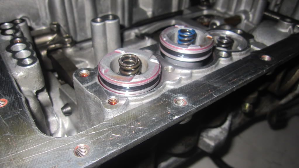

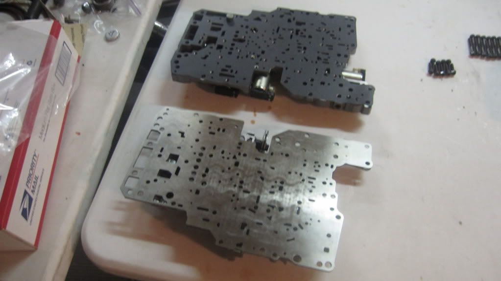

BIG Update!! Today got the trans back together, Just finished, took my time and made sure not to damage the new valve body gasket in any way during install. Having my dad help hold down the valve body onto the case was a big help as the added spring length made it hard to line up. Going to fill the converter with fluid and put it on the engine, dropping it in tomorrow morning!
Pictures :)

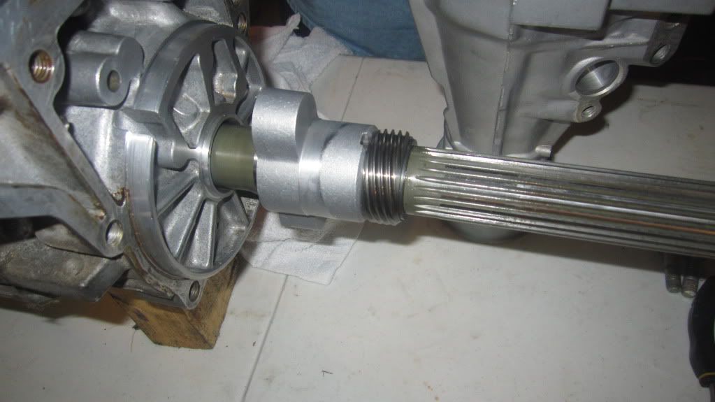

Speedometer driven gear and Speed sensor rotor swapped over from the old trans (Non ABS opposed to ABS) and also gear ratio
Extension housing gasket installed, Speedo gear and Speed sensor swapped over from old trans as well

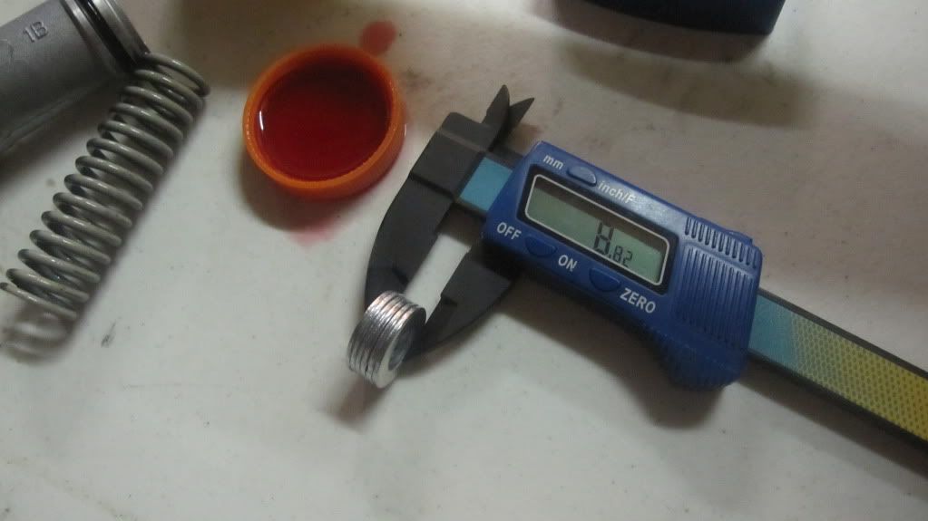

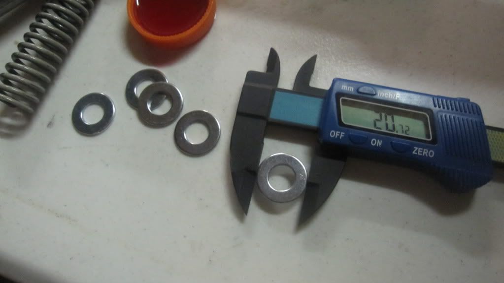

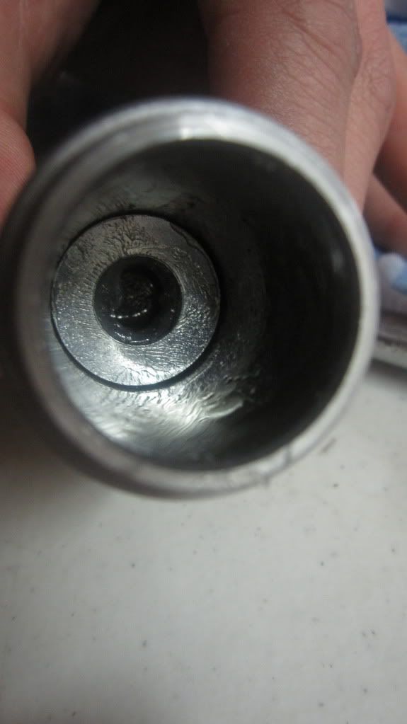

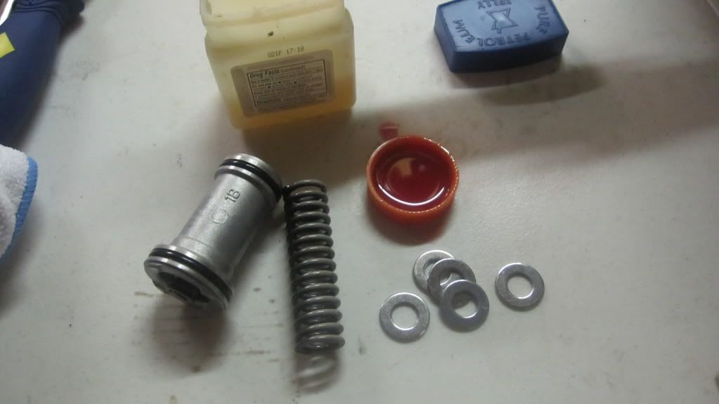

Accumulator Springs shimmed (supplies)
I used 6 3/8 washers, 20x9mm shim on both 1-2 accumulator and 2-3
Shims inside accumulator and held together and in with petroleum jelly
Both accumulators installed with shims and springs

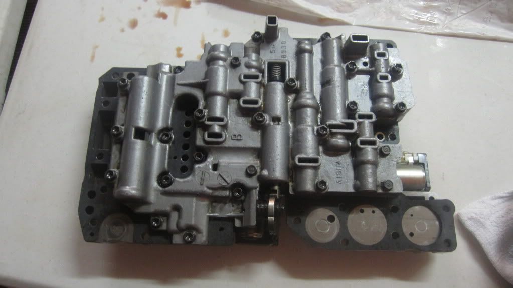

New valve body gaskets thanks to Import performance trans
Valve body together with new gaskets
Valve body installed on trans along with new wiring harness and filter

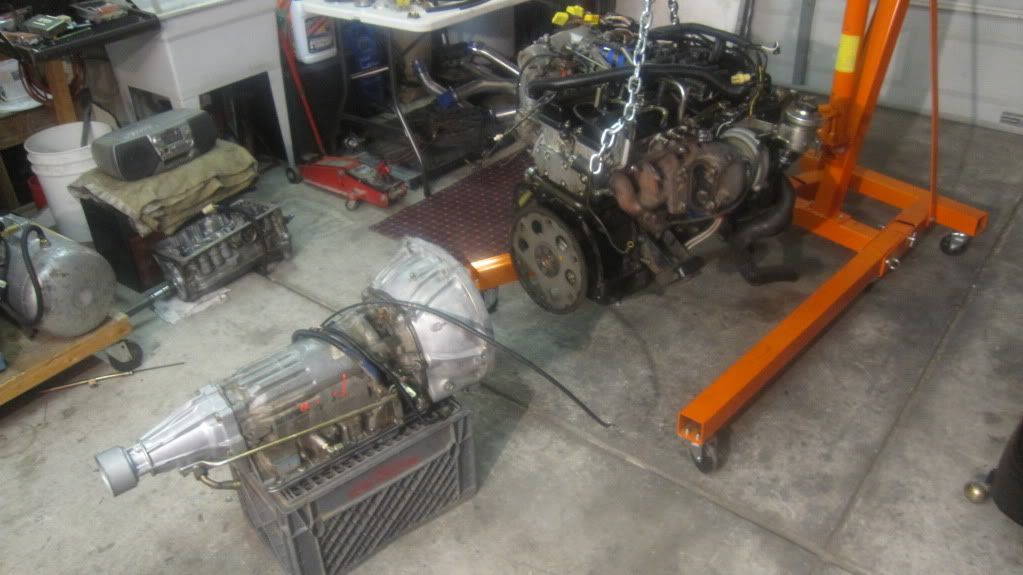

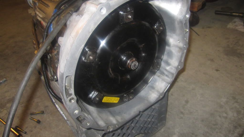

Done, Will drop the motor in tomorrow! Finished everything up on the trans and bolted it up to the motor. Its all ready to drop in..
End night 1:00 AM
Installing the trans on the motor, having the trans up made things alot easier to line up, Got the torque converter lined up to the flex plate first try, didn't even have to rotate the motor.
New torque converter
Motor and trans meet, perfect fit, lining it up this way couldn't have gotten any easier.
All done ready to put in tomorrow

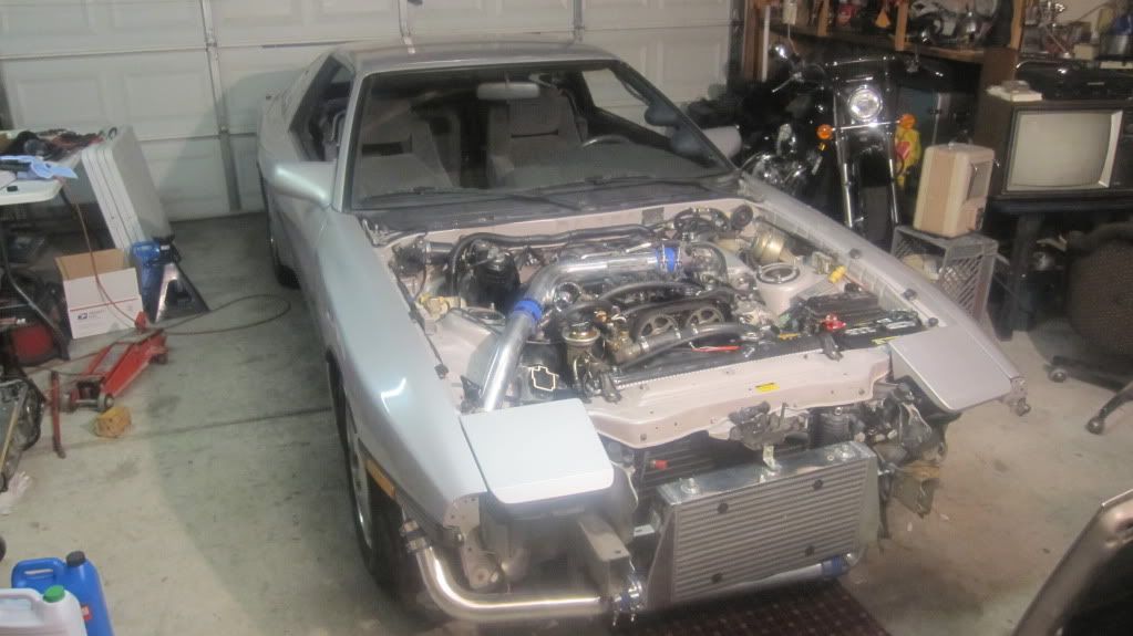

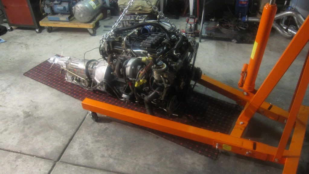

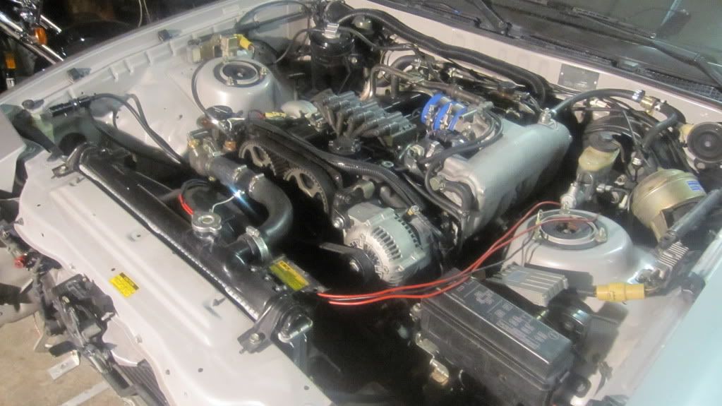

Update time
Today got it all done, new trans is great, shifts firm and smooth, Uber fast shifts compared to before.. Have not tested WOT yet but I can tell its going to be better than the old trans..

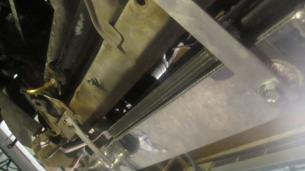

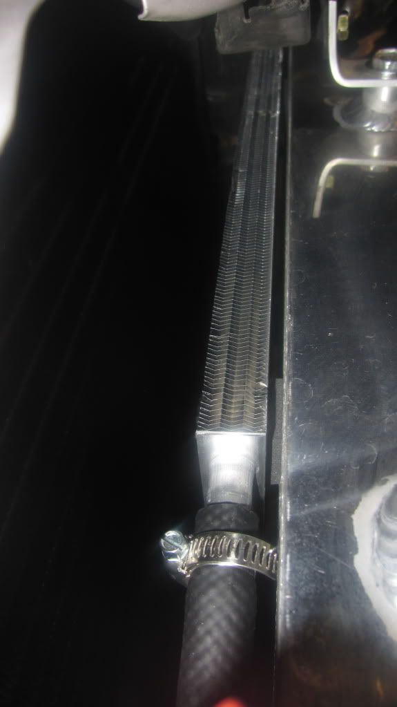

Motor in and hooking stuff up

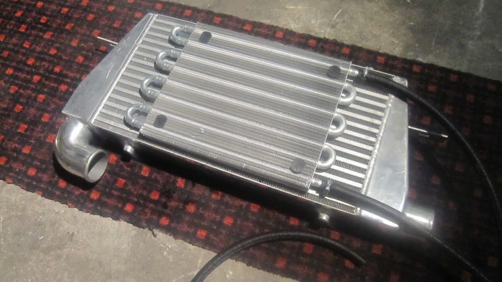

Transmission cooler layout on back of intercooler
Mounting
Underside mounting
Finished product..
