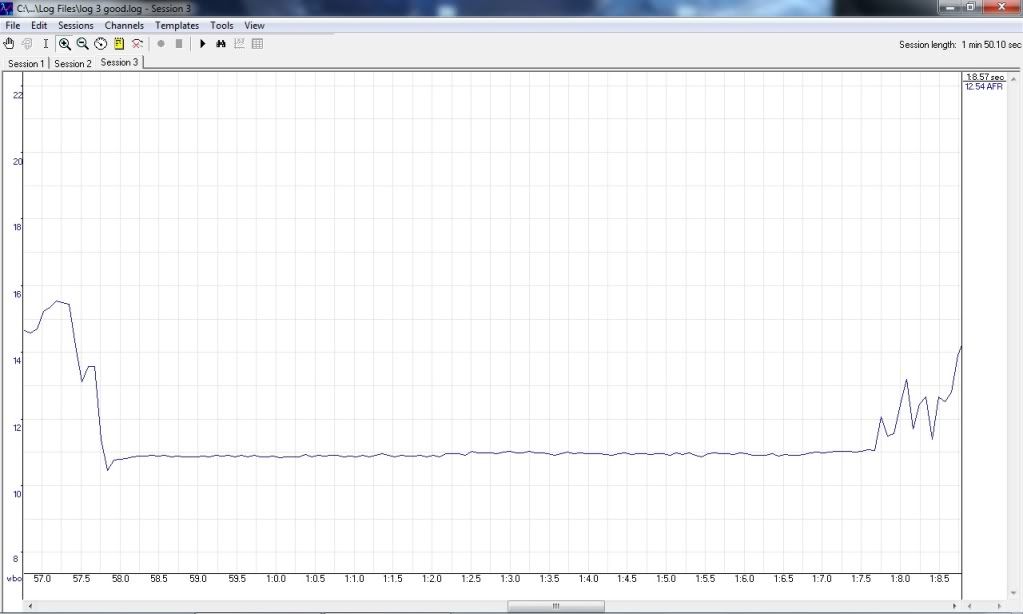

Update.. Tuned the car on 12 lbs tonight.. Here is the perfect holding AFR graph after me tuning it, this was the final pull after adjustments were made
The first zigzag at the beginning while AFR was dropping was the fuel pump relay kicking on full voltage, and the zig zags at the end was rev limiter

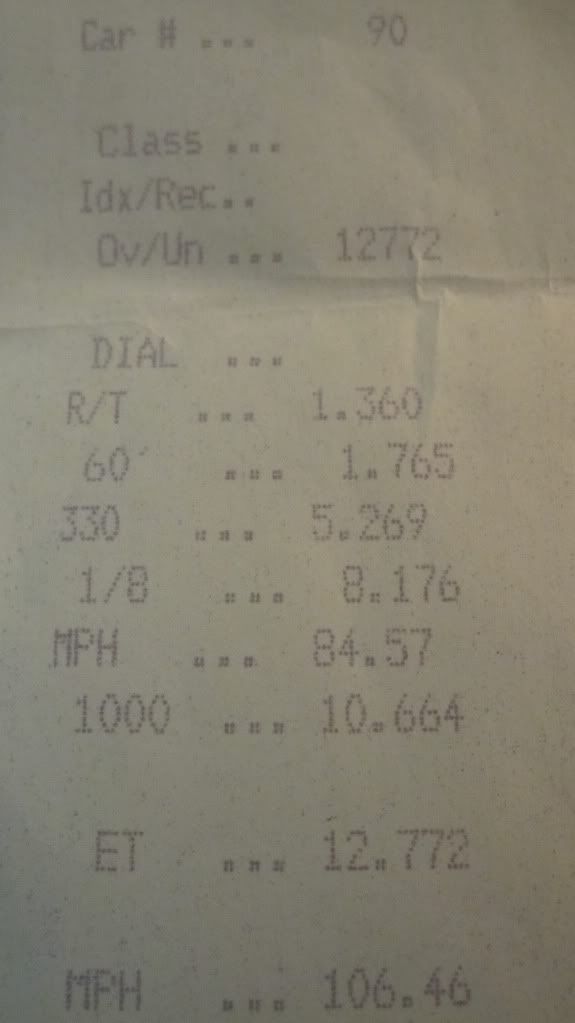

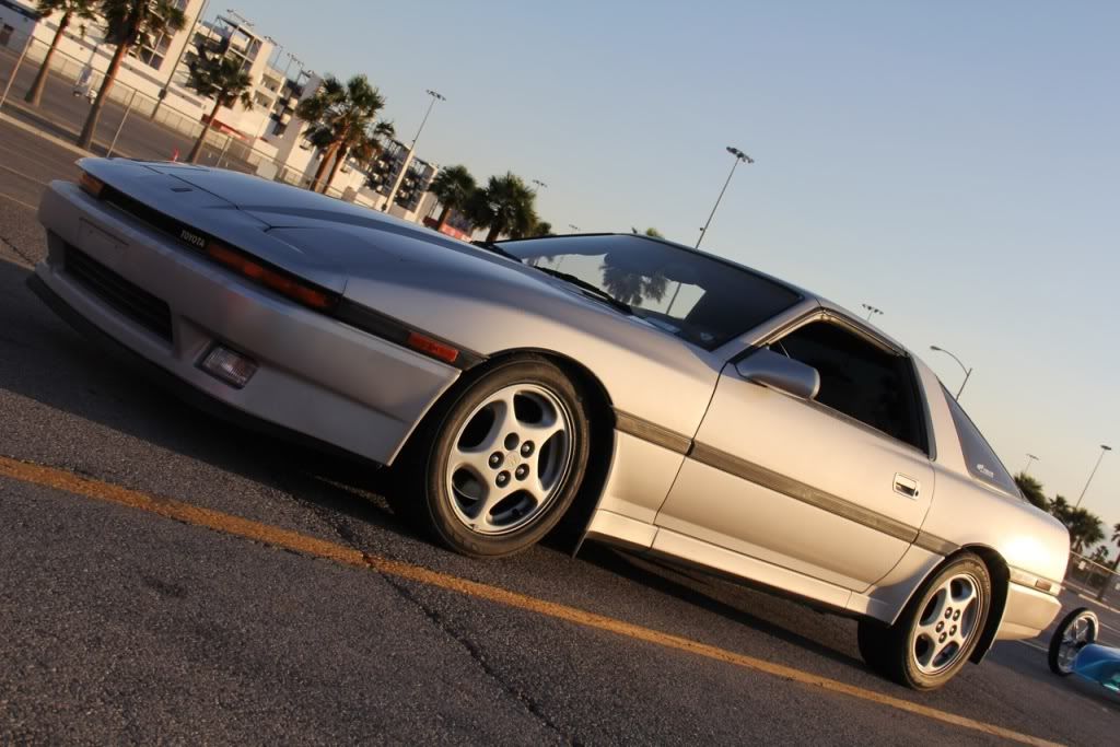

Car is down into the mid/high 12's. Did a 12.7 and had the car trapping at 109mph cutting 1.6 and 1.7 60ft's with the M/T cheater slicks.
Here are some pics just to keep things updated!
Pics from the drags this evening!

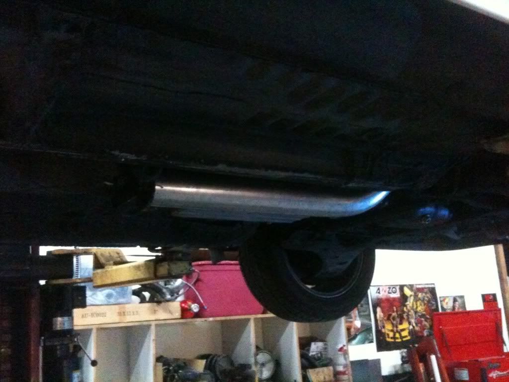

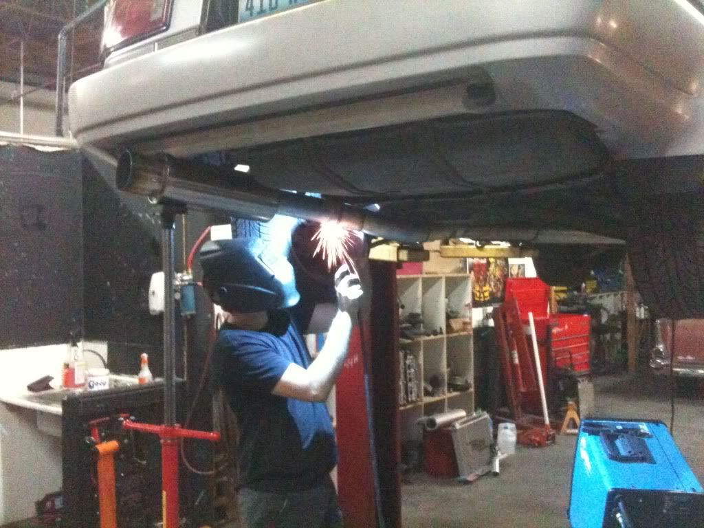

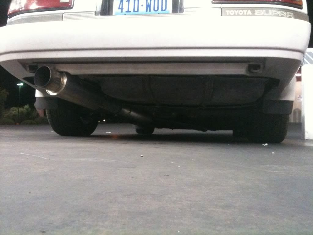

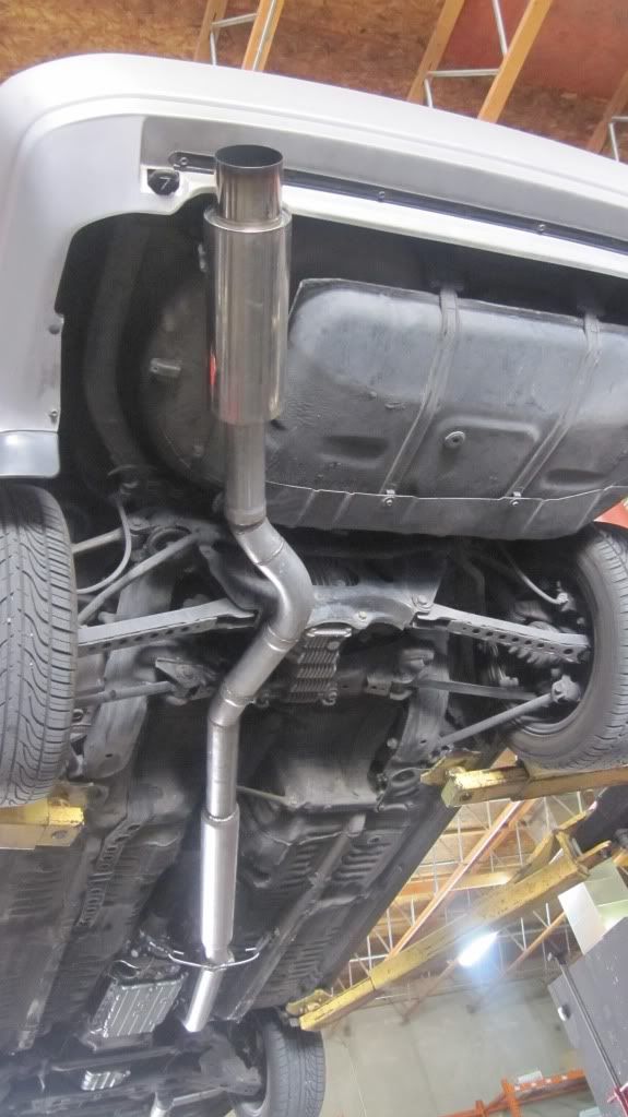

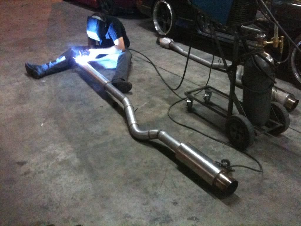

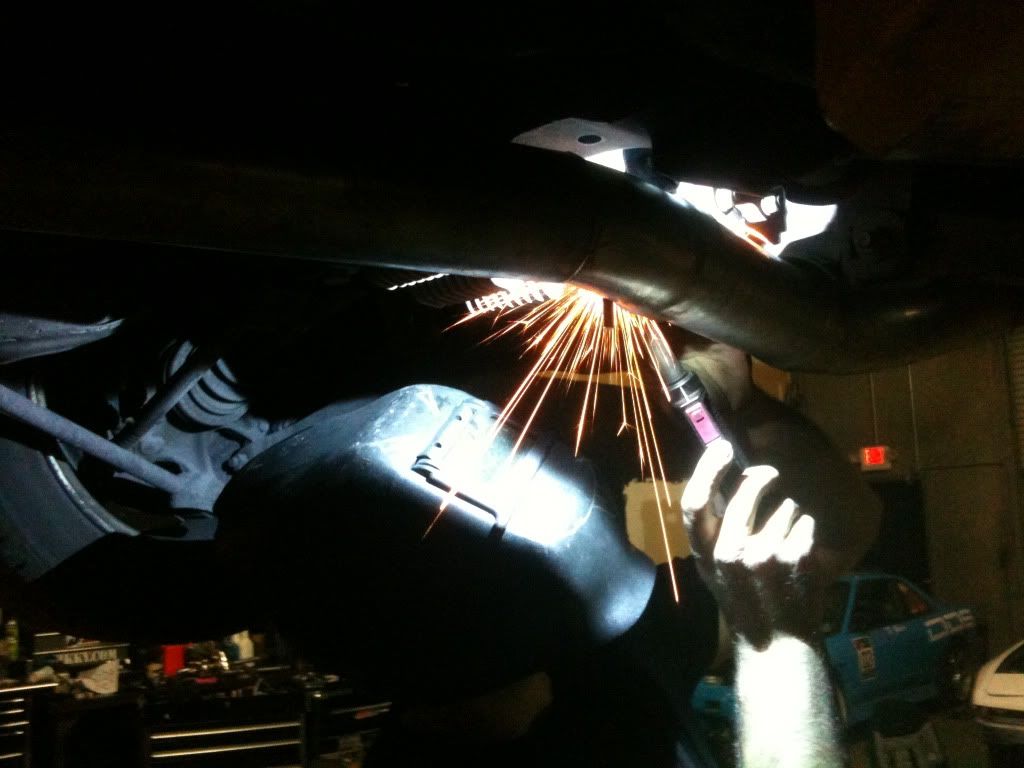

New Exhaust!!! Woot.. All done by my brother at his shop.. Full Mandrel Bent, Turbo back 3 inch downpipe to the back. Sounds beautiful. :D Tucked up very tight!
First step, 3 Inch open DP to a 3 bolt 3 inch flange.
Complete mock up on car and tack welded everywhere.
Welding on a hanger, My brother doing what he does best!
Complete exhaust getting welded!
Will have complete pics from under on the lift tomorrow and in the day light! Fitment is awesome and sounds great!
Here is a quick pick from the back at the gas station :)

Full exhaust what it looks like on the car..

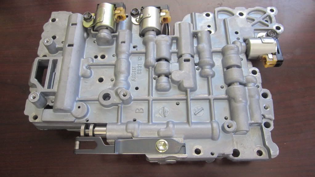

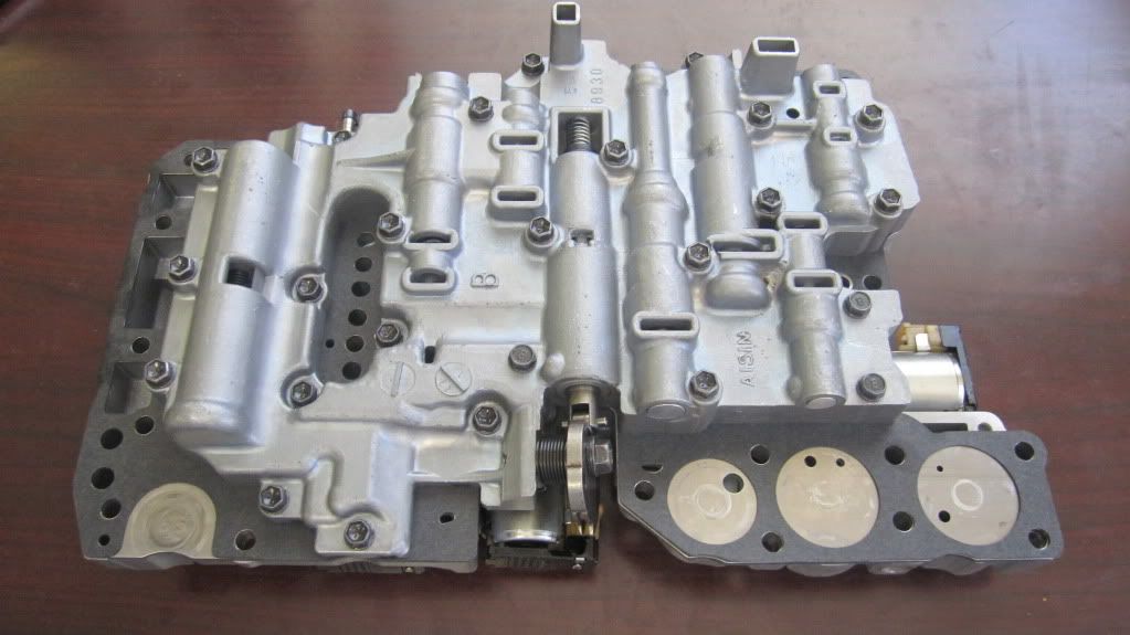

Here is my finished valve body, 100% rebuilt, with mods. I put this one in today and is the V2, It works amazing!

IBoughtASupra: The valve body has been completely re-worked by me. It was completely taken apart down to a bare valve body and cleaned/rebuilt, The separator plate has been modified, the primary regulator has also been modified as well as some other stuff internally.

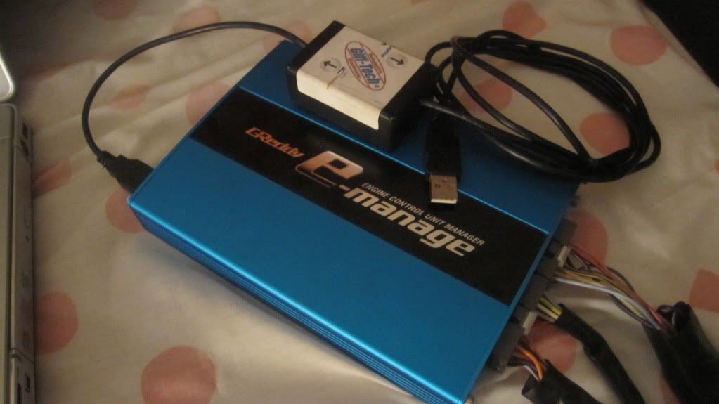

Just to keep the thread rolling, Not much of any updates. I ended up getting rid of my SAFC Neo and going to a Greddy Emanage that I got for a really good price. Its hooked up for full injector control and also timing control. This gives me more tuning ability being able to adjust the injectors without messing with the AFM signal. It also gives me a AFM clamp to get rid of fuel cut. And the fact that it can be tuned on a laptop with map tracing and a bunch of other good stuff.
Should be getting a Aluminum 1 peice DS in soon a long with RC Engineering 750CC Injectors to top everything off. Next week Im going to pull the turbo and manifold off so my brother can weld on a flange for the 38mm Vband external wastegate and make a strap to hold the stock internal gate closed. This will allow me to run higher boost and also the ability to hold it without spikes and what not.
Were going for the Stock Turbo HP record. Planning on breaking at least 380 but should be able to get it to 400 or so.
Will post pictures of the external gate setup next week! But here are some pics of the recent stuff.
Got this in like brand new condition with the optional software and cable, optional ignition harness, and optional Injector harness for 250.00
