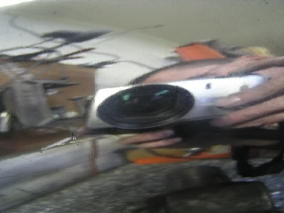

Looks like I'll be getting my FFIM within the next week :)
Here are some teaser pics Seth sent me
I really can't wait. Things are comming along nicely now that I've started wiring.
