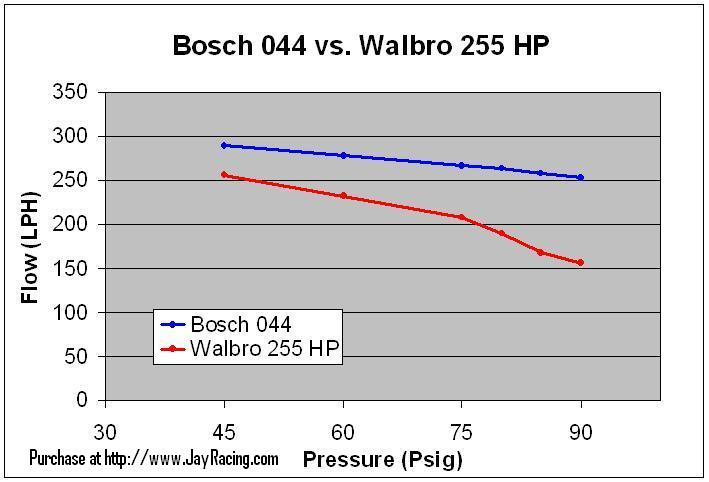

hottscennessey
DONT BE A BITCH!
Jun 3, 2005
3,137
Richmond, VA
It flows pretty well, not quite enough to get the full advantage of my 870cc's.. but definately enough for some 720cc's.
http://www.google.com/search?hl=en&...6+in+cubic+centimeters+per+minute&btnG=Search
This pump will flow approx 715cc/min @40PSI on a 90% duty cycle. Not too bad.
