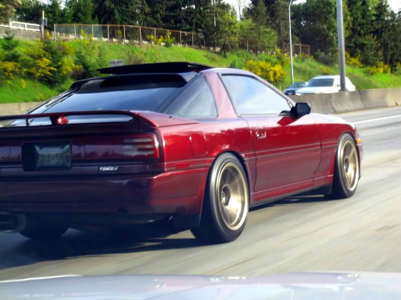

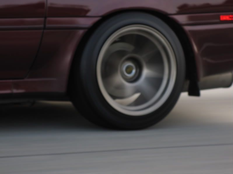

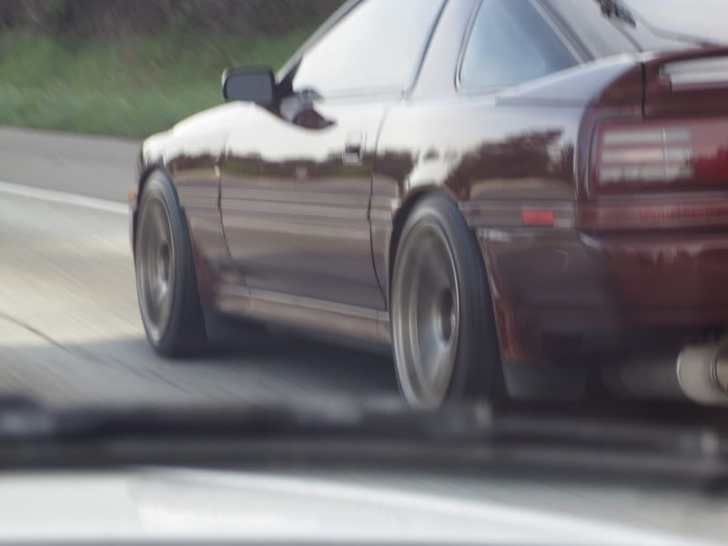

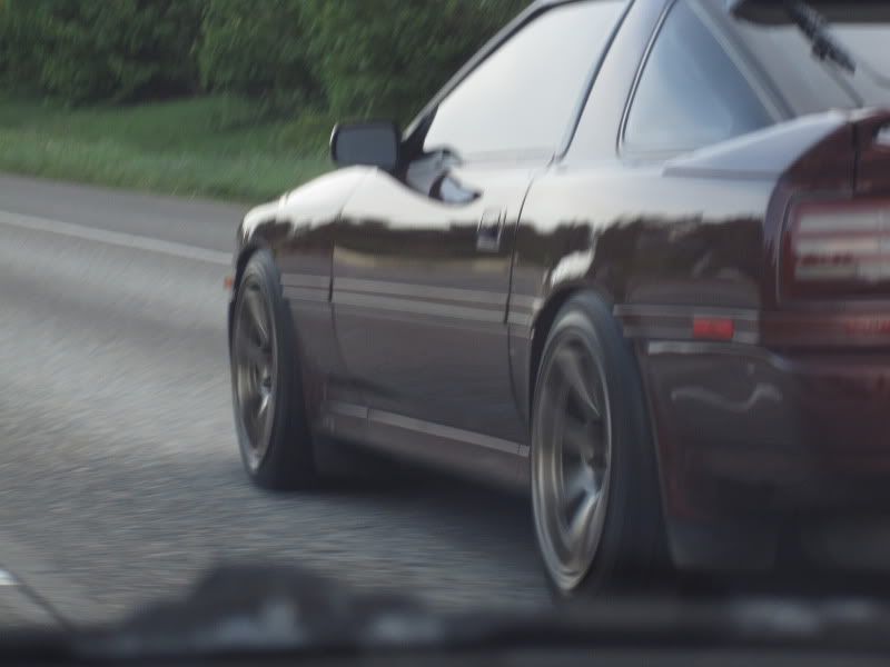

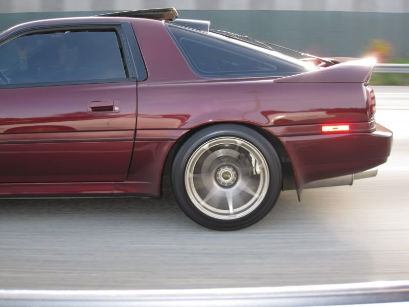

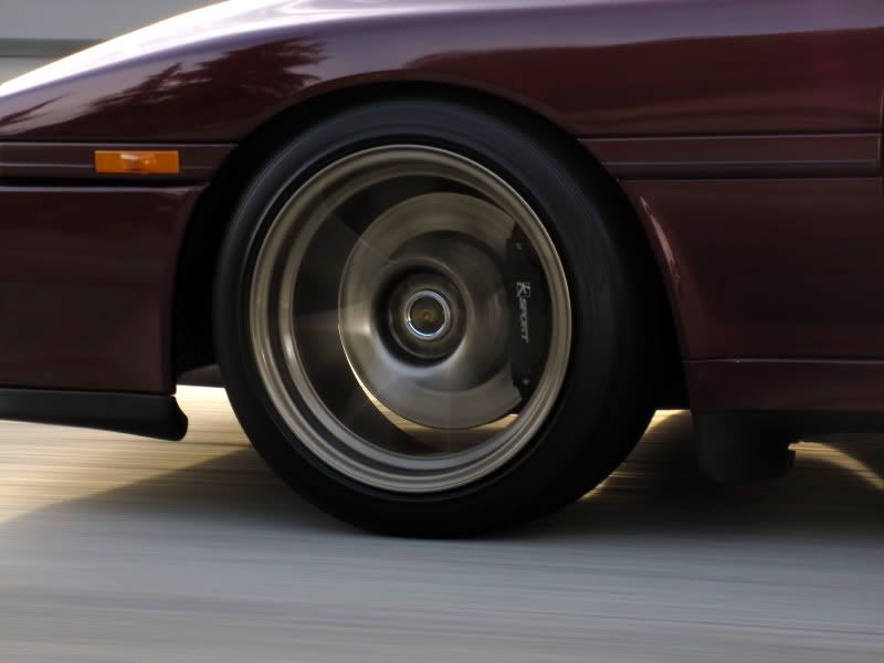

Late, but as promised. Thanks Moe!
MB "Battles" sizes; (f) 17x9, 15mm...(r) 17x9.5, 15mm...tires 225/45's and 245/45's respectively. front rims are actually 30mm offset, but w/ my H&R 15mm spacers, they are 15mm.
The last photo is my least favorite thing about the 'poke & tuck' look...how skinny the tires look stretched on those 9.5" wide rims!
