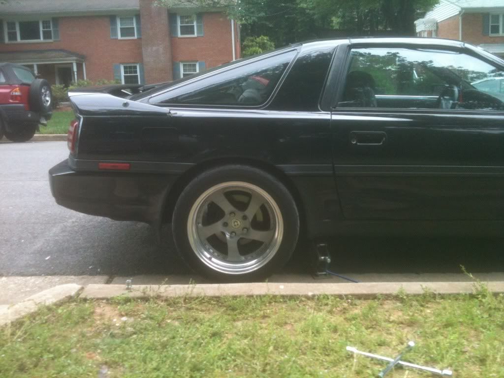

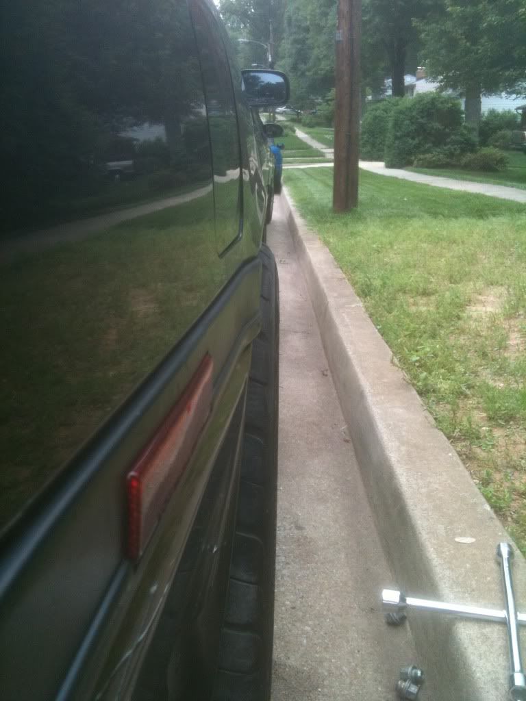

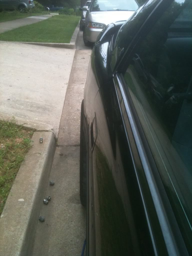

Thank you spiller. Here is my test fit of HRE 18x10 +19 at the rear. I kinda like it that way, any suggestions? Tire is 275/40/zr18 (I'll change it to 35 very soon.)

i'm running 10 +22 in my rear with a 275/35 and a rolled lip and it's near perfectly flush. Will be going to a 265 for better fitment soon.

IMO after reading 190 pages of this thread (thank you all for this useful thread.) 10 width and +25 is probably the best offset for the rear.

Sounds great dude, but IMO keep the 275!

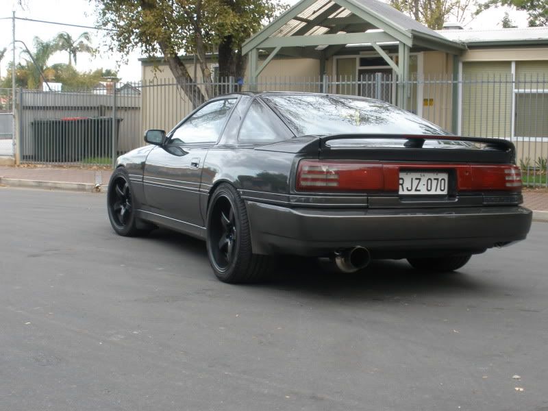

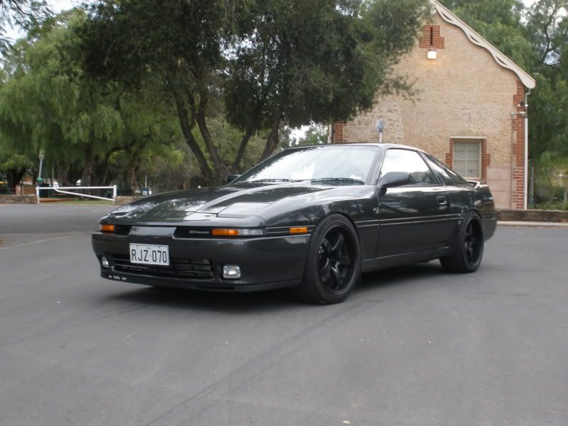

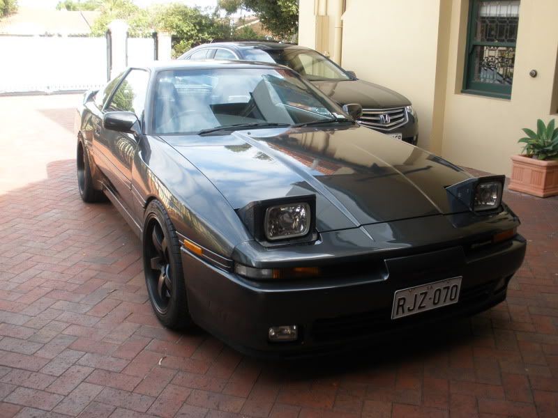

im running 18x10 +22 up the back and 9 +15 up the front. I can't remember off the top of my head how much camber I have on the rear but I have only 1 & 1/4 deg on the front and this is how it sits with a 245/40.
Bascially there is no way you will get away with those offsels without rolling the fenders. ultimately i'd like another degree of camber on the front but my wheel alignner was unable to get anymore than that (he suspencs a bent cross member but I beg to differ).

do you want more "contact patch" for tyre life reasons? Because in regards to handling, extra camber can be beneficial for cornering as you end up with more contact patch as the loading on the outside wheel of the corner increases. It really bugs me that I only have 1/14 neg camber on mine for this reasons, and the wheels rub a little because of this as well. Consequently im going down to a 235/40.
pics...
they are probably the only useful ones in regard to wheel fitment although not optimum. car is parked in the garage atm and cbf moving it out :p
