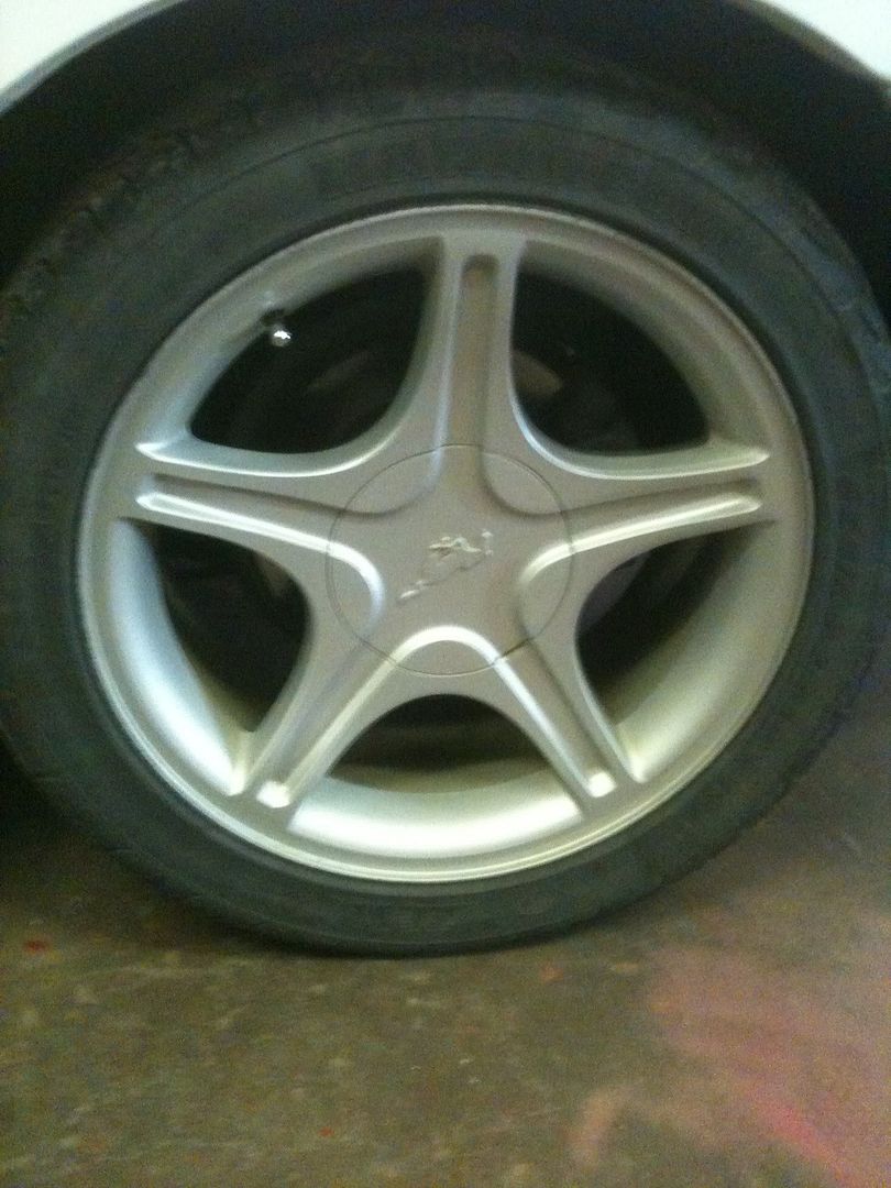

hi guys are these the mustang rims that fit a 88mk3 if they are what tire size is best and what do i have to do for lugs do i ues my stock ones? or buy new one or use the mustang ones??
they are off a 98 mustang gt
thanks

You can not use mustang ones because they are a different thread size. I am not sure what style you need but here is a diagram of different types.
Stock Toyota is the mag seat. Most after market wheels use the acorn. I would just take a look at the wheel and get a set accordingly. Thread pitch for toyotas are 12x1.5

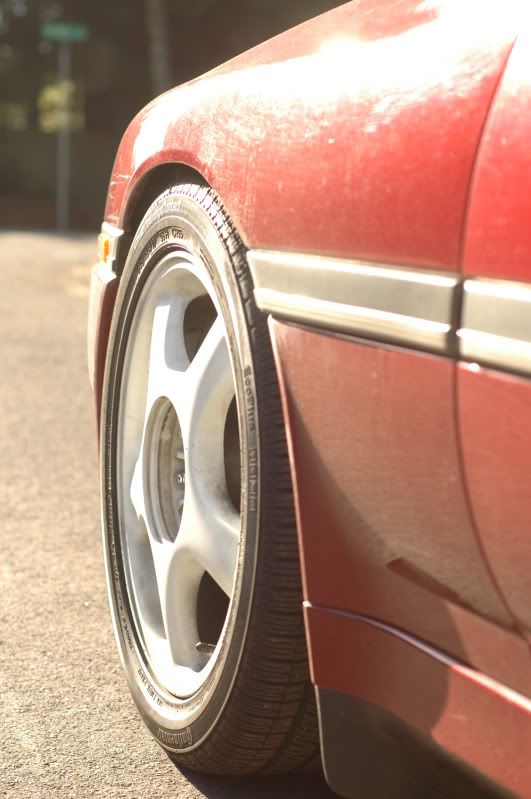

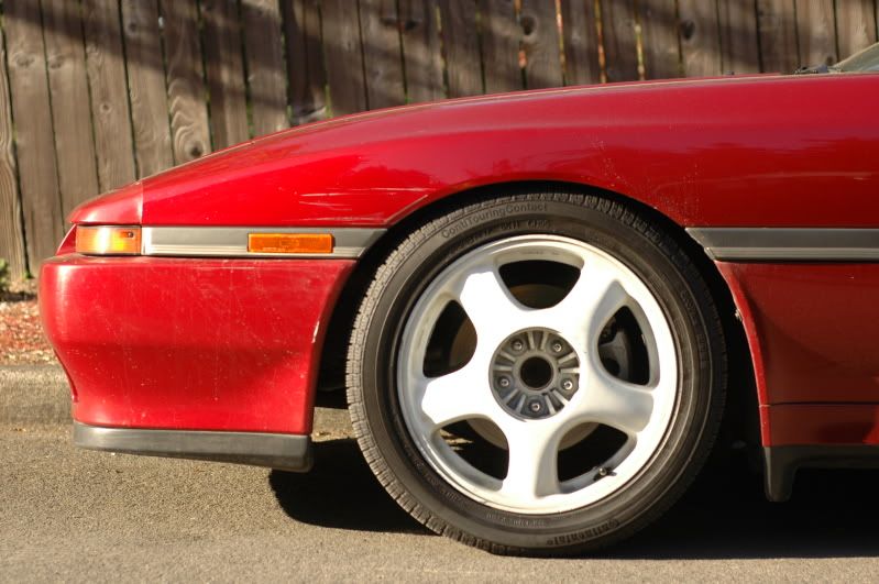

91T breezen';1544234 said:
Those will be just fine, and your recommended tire sizes are as follows: (F) 225/45-17's, (R) 255/40-17's. You will definately need rolled fenders all the way around. I'm running 17x9 (15mm) and 17x9.5 (15mm) w/ 225/45's and 245/45's respectively, and rolled in front only. I'm getting away w/ the rear stock, only because I have the stiffest spring rate coilovers you can get! Harsh ass ride, but no rubbing. Her's a couple of photo's for ya.
great fitment.. precisely what I am going for as well.
