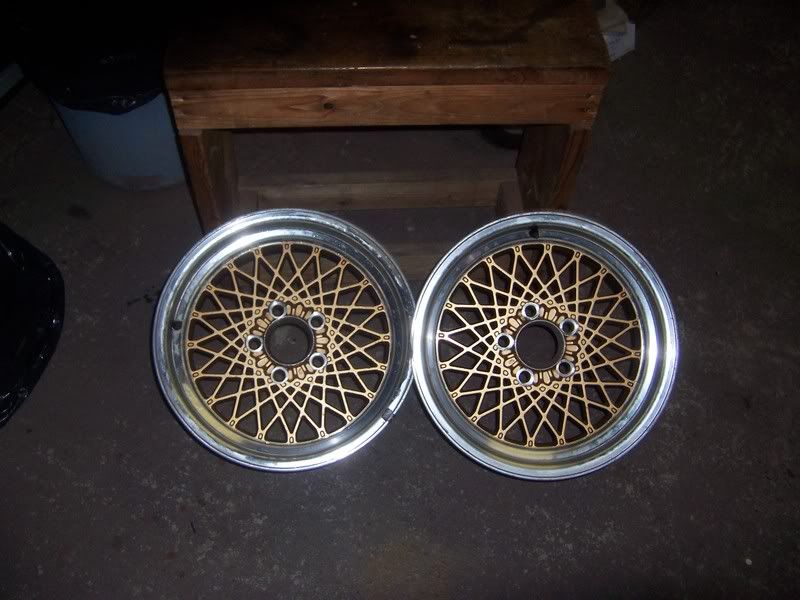

fitment question. I've decited to go for a oem/mesh look. i'm thinking some GTA mesh wheels off of a 80's trans am. would it be possible? similar to crown vic meshes. I really want this wheel or some like it. any tips will be appreciated asap because I found a set for dirt cheap and would make my day if they fit.
http://www.tacreationsusa.com/firebird_wheels.htm#GTAWheels - this site has alot of into about the GTA wheel.
GTA wheel specs:
Size : 16" x 8"
Backspacing Front : 4.75"
Backspacing Rear : 5.25"
Bolt pattern : 4.75"
Material : Aluminum
Finish : Painted Centers/Cleared Lips

I agree, a huge domestic shame. turns out the bolt pattern is 4.75 = 120mm =( almost got them for a steal. now i'm looking into getting the BBS crown vic mesh et23. atleast they do fit and look amost just as good, tsk tsk. thanks breezen.
