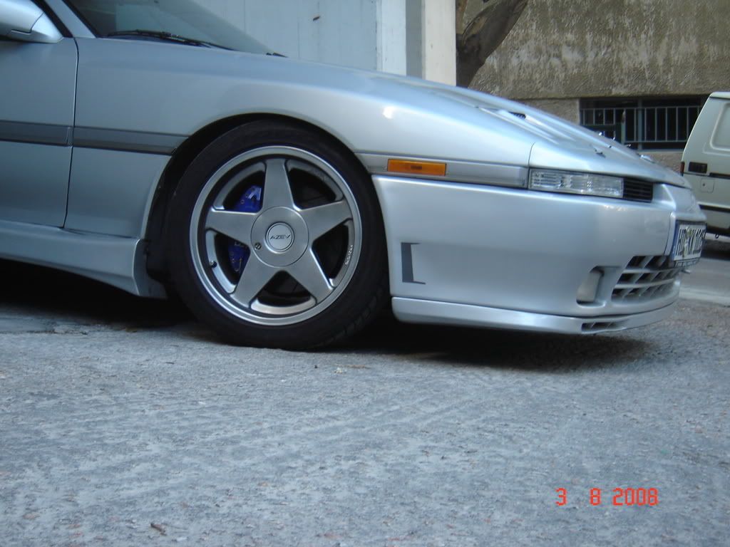

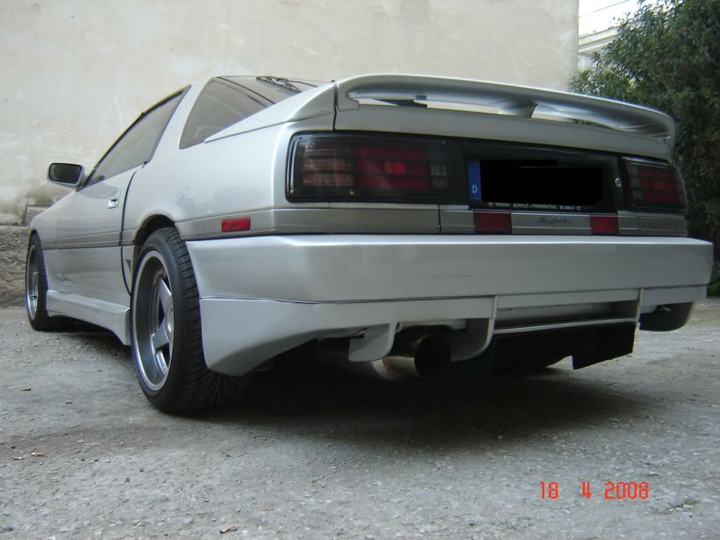

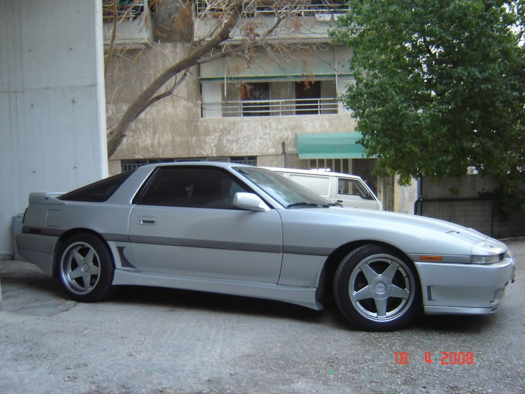

Hi Rodel! Wanna ask you something....:1zhelp:
At the moment I do have Azev wheels (made in Germany) 8.5 x 17 front and
10 x 17 rear with 235-45/17 and 255-40/17 (it is a little stretched in the rear)
and it is not flush. The wheels go out about 1/2 inch in front & 3/4 inch at
the rear...I do have some rub on hard cornering. My car is 1.2" front/1.0" rear lowered with
eibach pro-kit springs and tokico illumina II (tems).
Picture with my car and it's current rims/tires :biglaugh::biglaugh:
The car is parked on a non level surface.It is on a slight downhill,that's why the front of the
car is more lowered....
And I wanna know which is the ideal offset for 8.5 x 18 (front) and
10 x 18 (rear) with 235-40/18 Fr. and 275-35/18 Re. tires?
Some rims with a bolt pat. of 5x112 (they don't come with 5x114.3)....
Will they fit? A guy told me that they could fit by using special conkave nuts!
Is that true?
Claudio
Is that true?
Claudio
For the 8.5's a +25-+35et would be the safe way to go, the 10s a +45et would pretty much be flush with your fenders. Anything lower you might have rubbing issues and probably have to roll your fenders.
I really like your Azev rims, you can always take them to a machine shop and see if they can machine down the inner hubs 10-15mms so they would fit better.
As far as fitting 5x112s you might be able to force the wheel to fit onto the studs but they will be off balance and your car will shake and vibrate badly and one hard turn or hard braking could possibly snap the studs and be disasterous.

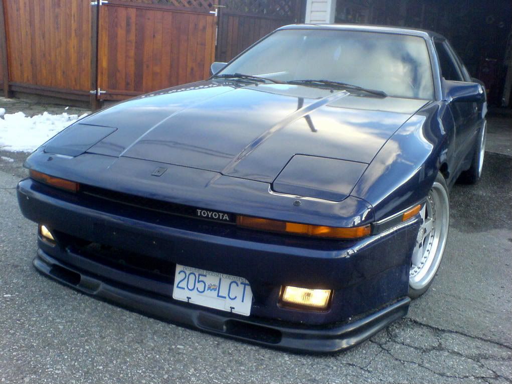

update:did some work on the fenders
how low am i? my fist barely fits under the frame rail so about 3"?? haha its low
btw this is my beater
18x9+13 18x10+13 225/40/18
the rear can easy swallow a wider tire
