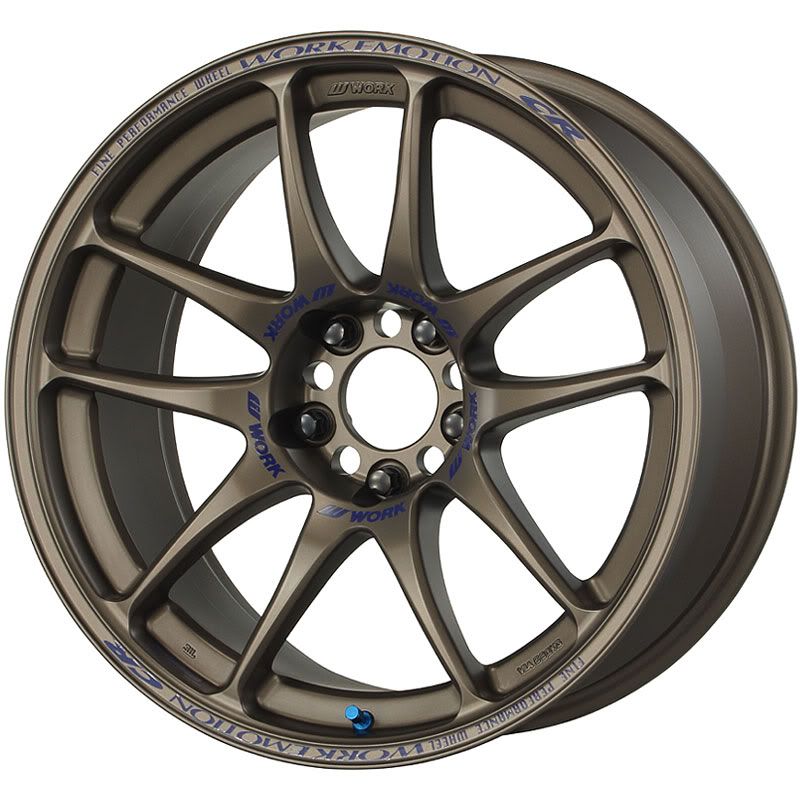

Kristian_Wraae;1106238 said:
Does anyone know these wheels?
Brand, model, sizes?
those look like Work Emotions but with a crazy offset
