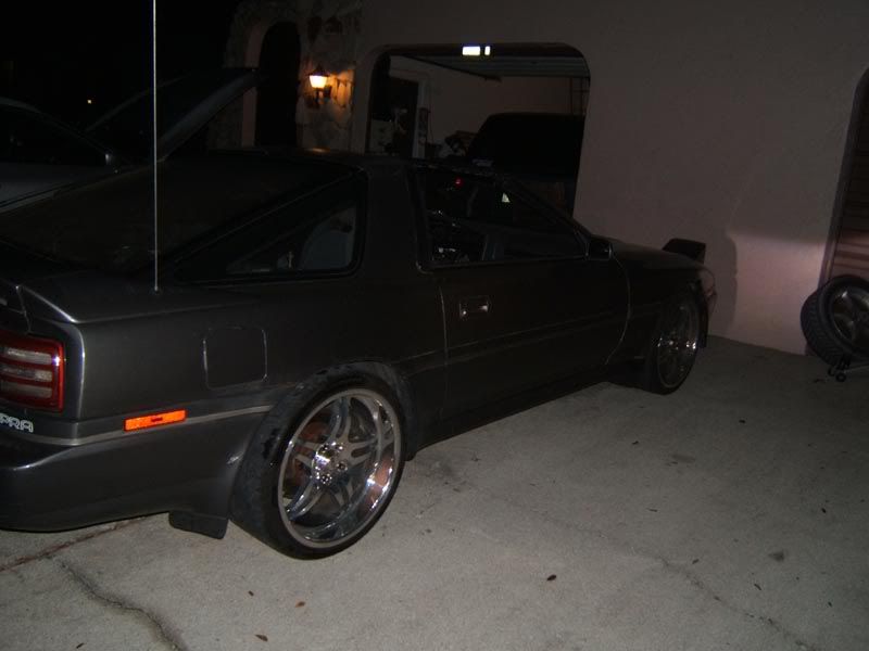

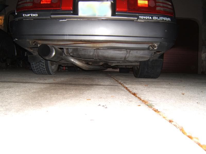

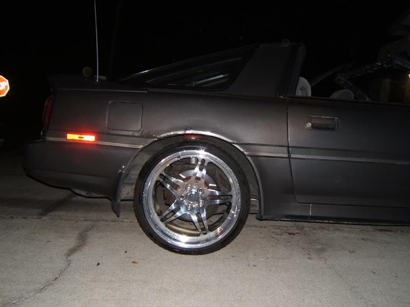

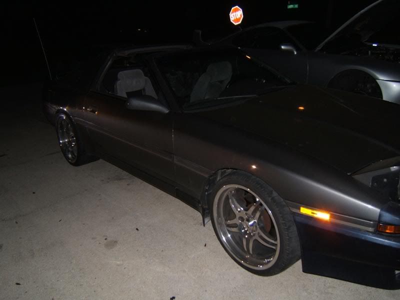

i think ive posted these pics at least a dozen times since i first put these wheels on...
Duane; Here you are
they are 19x10 +50mm fronts and 19x11's +50mm on my old Gray on Gray 89. lowered on BG sport springs and KYB GR2 shocks. i had to use 10mm spacers on the rears to get them to clear the strut bodies, even then it was too close for comfort (only a few mm of clearance). the tires were Contentital Contisport2's. the rear tires are 315/25's and the fronts were 265/30's.
the width is the main issue. the tires are only 25.6" tall so its not liek they were huge. even with those wheels and the MAXIMUM amount of positive offset possible, they still protruded past the body. to run that much tire, you will HAVE to pull the fenders or raise the car.
... i kinda miss that car, but not the rust.
Duane; Here you are
Thanks :)
I see that the big tire I want may be too much since I like my car low. Hmmmm I think I may drop down to a 10 to make sure I fit with no issues at all. I can still get a decent lip on these wheels. (These have a step lip)
Thanks for the feedback people! :icon_bigg
