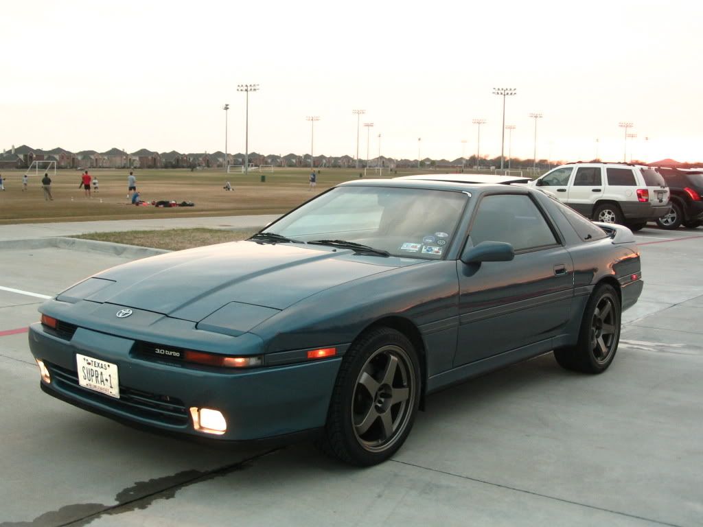

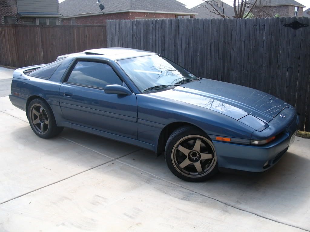

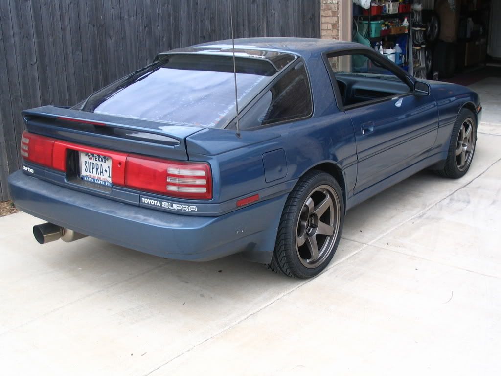

MKIIINA;888409 said:running the same wheel
rota p45f - front - 18x8.5 - 245/40/r18 +25
rota p45r - rear - 18x9.5 - 275/35/r18 +30
no rubbing left/right, minor rubbing over large transitions. This setup is very straight with the side of the car and the tires match the wheel almost perfectly.
