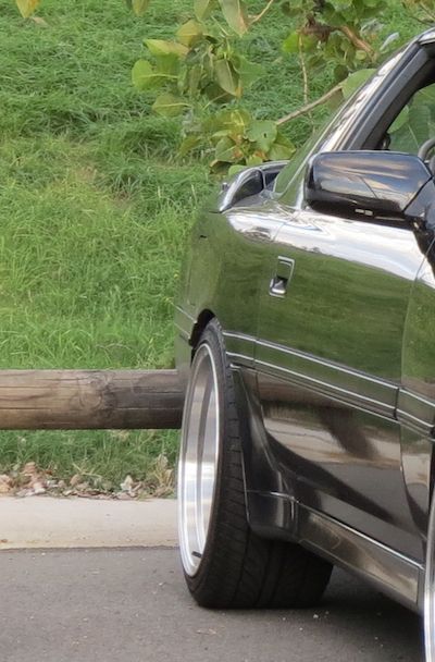

Hey guys, I am currently running XXR 521 (18x10+25's) with a 265/35 tyre at the back and i'm looking at going 285's.
Do you reckon its feasible? I have rolled the guards. Can perhaps roll them a little more. This is the current clearance....
They look wider than my 275/30/19s that i have fitted. My offset is +30 and i had to tap the arch in a tad. Also have 10"s out back.
Don't think i could go wider without a proper roll job getting done.
